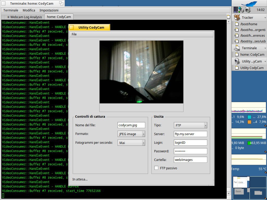

I wanted to give a little update: I’m testing two webcams, one integrated into the laptop (an old Sony Vaio from 2010) and one external, much newer webcam. I am running the tests on USB 2.0 ports (I know they are old, but the keyboard and touchpad don’t work on my new laptop). Codycam has been running since this morning without any issues.

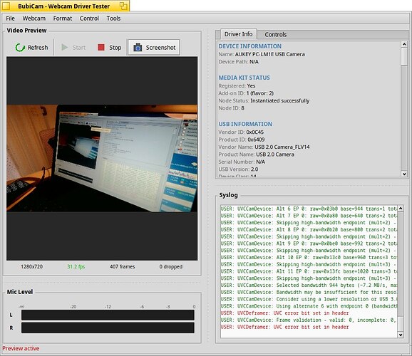

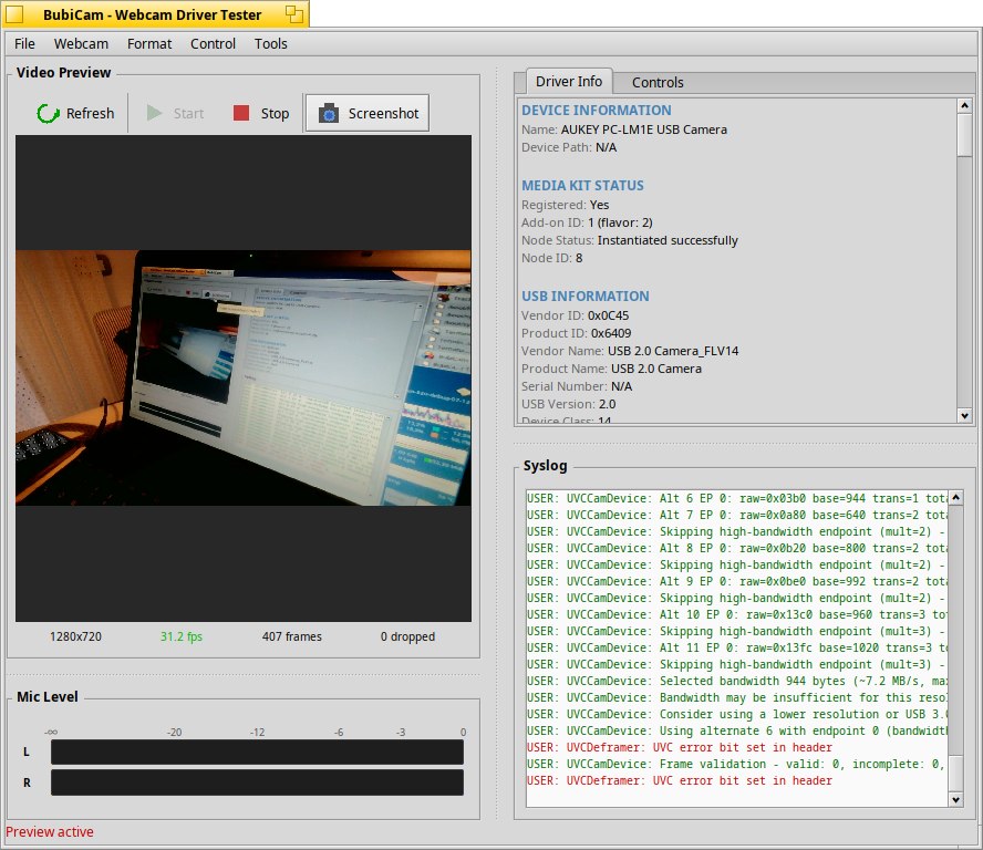

With BubiCam, I managed to get a constant video stream with USB 2.0 at a resolution of 1280x720 by modifying the EHCI bus. Unfortunately, I have no way to test the XHCI modifications made to get it working on USB 3.0.
All this work was done with the massive use of Claude Code. Therefore, I am perfectly aware that it will NEVER be integrated into the Haiku codebase, but I think it could still be useful for many people who love Haiku.
As soon as I finish solving a bug with YUY2 and the microphone, I will share everything, even though you can find all the sources and binaries on BeShare.
