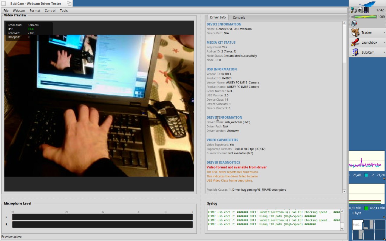

Shhh... Haiku isn't blind anymore!
Can you guess what we are looking at? :backhand_index_pointing_down:
Let’s just say that if you’ve been waiting to use your webcam on Haiku, your wait is almost over.
Many webcams will be supported very soon.
Patience will be rewarded! :wink:

This is marketed as a development Tool. The native app is CodyCam.
I don’t see any problems this solved
It solved problem with EHCI isochronous transfer support and UVC camera driver. CodyCam should work too.
Hi nephele,
I must clarify that the project is solely a non-professional development tool.
It originated from the fact that Cortex and CodyCam are architecturally different, and a driver that works on one is not guaranteed to work on the other. We created a bridge between the two and a method to analyze the USB bus.
Using this tool, we have discovered and identified:
  1. Small bugs on the EHCI bus.
  2. Missing parts in the EHCI implementation itself.
Therefore, we are not just solving a webcam problem for a few people; we are identifying gaps in system-level USB support.
Important Note on Release: This entire body of work will certainly not be included in the official Haiku sources. All modified source code will be available on my repository for community review. The package we release will contain only the binaries that will replace the system ones, specifically to avoid “polluting” the sources, which, as far as I am concerned, will remain untouched.
The video driver is now functional, and I am working to integrate the audio, although it is currently creating interference with the video stream.
Thanks! — Andrea

This part (which seems to be the most interesting one) does not seem to be included in the github repository (unless I’m missing something). Do you plan to share these fixes?
CodyCam seems indeed to be making incorrect use of the media kit, but as far as I know this was not the only problems with getting webcams to work.
It are included in ZIP archive published in chat.
Hi PulkoMandy,
Thanks for your interest! You are right, the USB support part is the most crucial.
I originally wanted to share the sources and files only when the audio was functional to provide a complete package. However, given your request:
I will put them into a repository in the coming days anyway. This way, you can look at them immediately, even if they are incomplete and full of “AI blobs” :wink:.
The fixes aren’t explicit patches, but rather insights gained while trying to make the Media Kit and USB stack cooperate, and these will be clarified by sharing the modified code.
