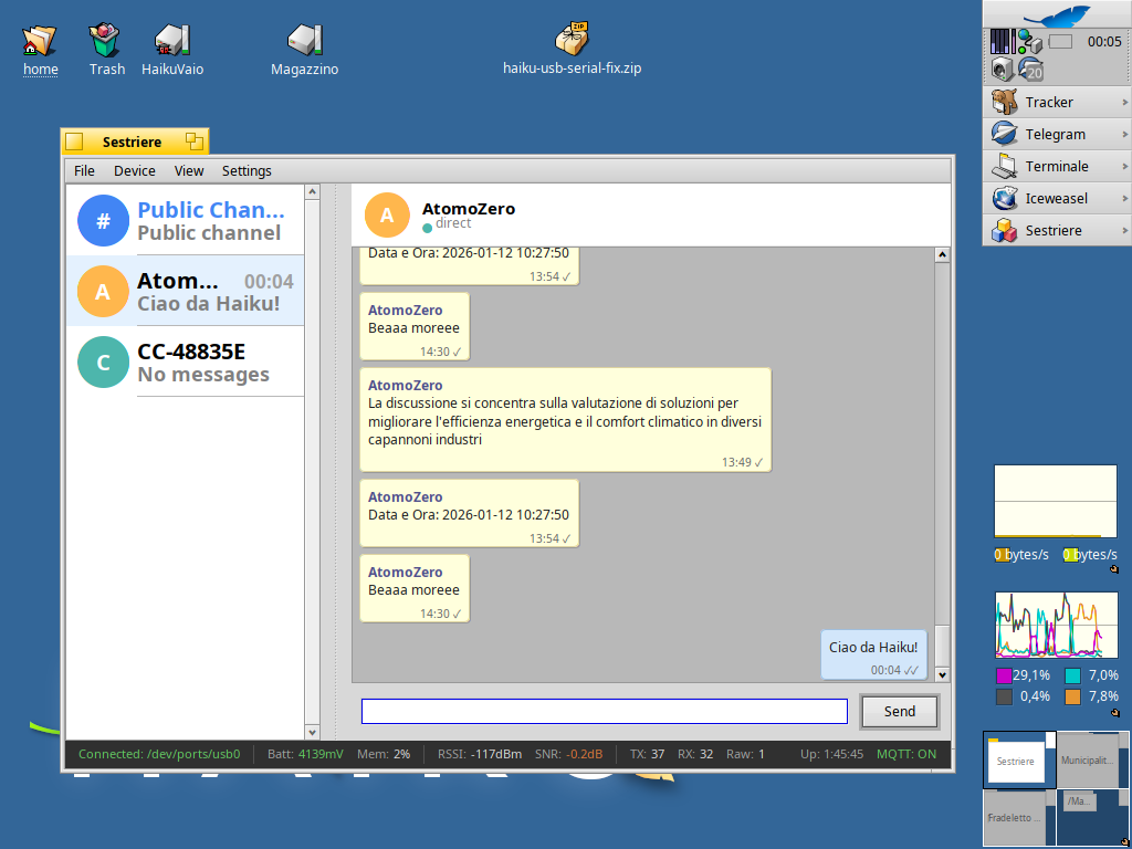

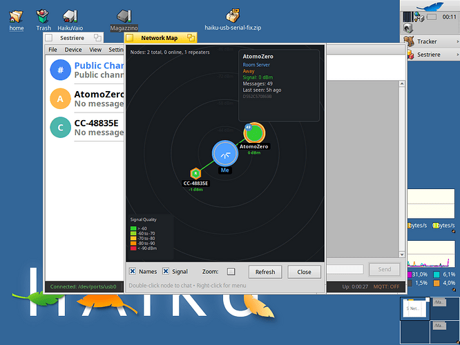

Hi everyone,
I’m happy to introduce Sestriere, a native Haiku client I’ve been developing for MeshCore networking devices.
Sestriere allows you to communicate over LoRa mesh networks using MeshCore-compatible radio modules. I wanted to create something that wasn’t just a port, but felt like a true Haiku application, integrating deeply with the system’s unique features like the People app and attributes.
Hardware
For my development and testing, I’ve been using an Heltec V3.2 board. The app communicates with it flawlessly via the standard Haiku USB serial driver (typically found at /dev/ports/usb0 https://www.studiobernardi.eu/Tatooine/Sestriere/haiku-usb-serial-fix.zip ).
Features:
  • Native Contact Management: Contacts are synchronized from your MeshCore device and saved as native Haiku People files with custom attributes.
  • Messaging: Supports private encrypted Direct Messages (DM) and Public Channel broadcasts.
  • Persistence: Your chat history is saved and restored between sessions.

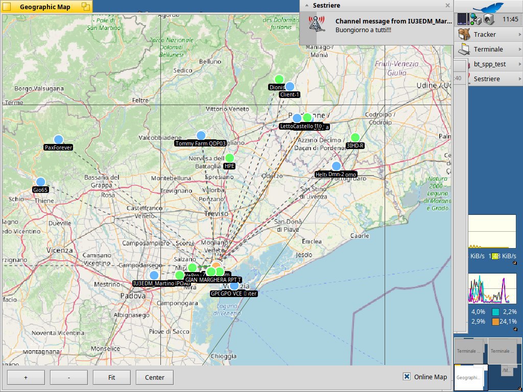

  • Dynamic Network Map: A real-time visualization of the mesh topology. Nodes are positioned based on signal strength (RSSI) with animated pulses for network activity.
  • Device Stats: A dedicated window for detailed radio performance, including SNR, channel busy, and battery monitoring.
  • Desktop Notifications: Get notified when a message arrives while the app is in the background.
  • Trace Path: Visualize the exact route a packet takes through the mesh to reach a contact.
Installation & Usage
  1. Connect your Heltec or MeshCore-compatible device via USB.
  2. Launch Sestriere and select the serial port (e.g., /dev/ports/usb0).
  3. Choose your regional radio preset (EU 868, US 915, etc.) and hit Connect.
Keyboard Shortcuts
The app follows Haiku standards for a fast workflow:
  • Alt+R: Sync Contacts
  • Alt+M: Show Network Map
  • Alt+S: Device Statistics
  • Alt+T: Trace Path
Source Code / Binary: https://www.studiobernardi.eu/Tatooine/Sestriere/Sestriere-1.1-haiku.zip
I would love to hear your feedback, especially if you have different LoRa hardware to test with!

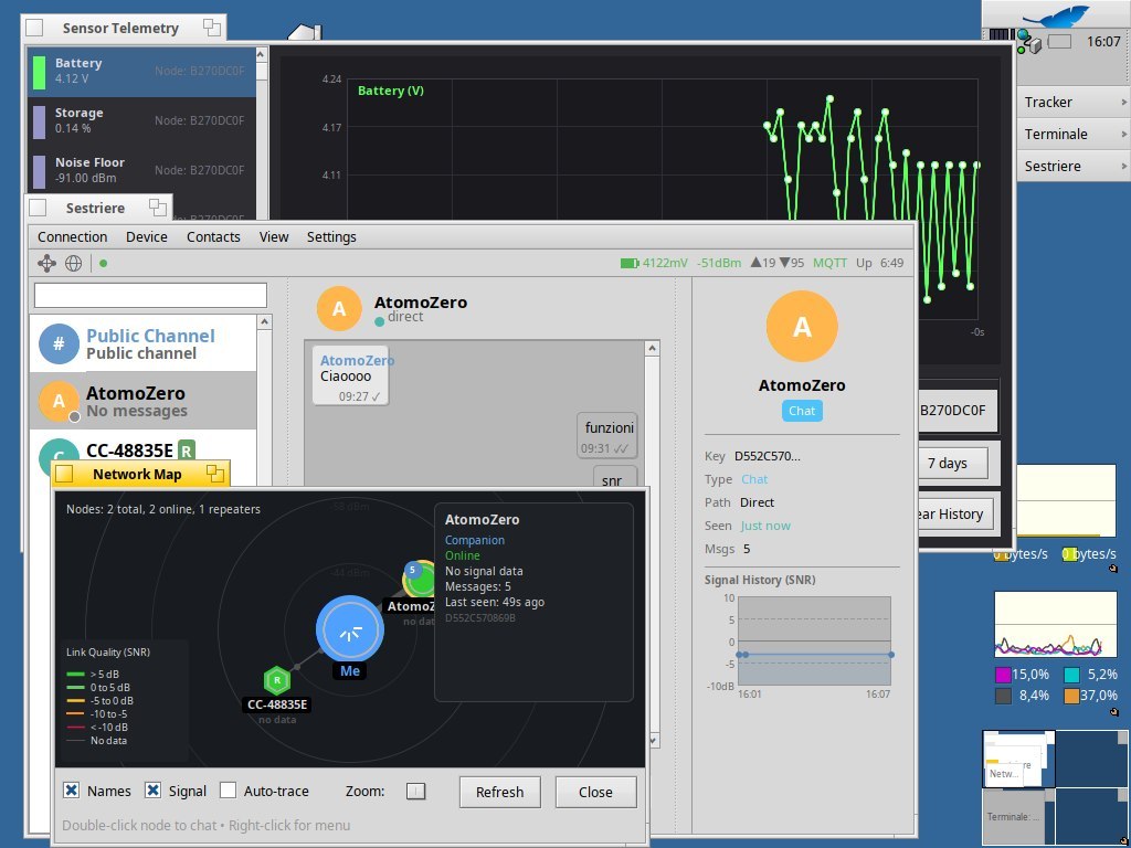

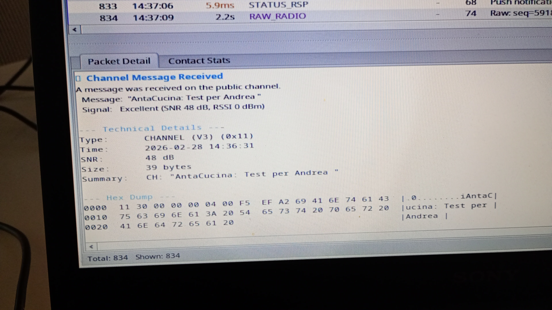

Version 2 is almost ready! Now we can view node telemetry, create a map of the mesh network we’re connected to, and send data via MQTT to global map services. It also features a packet analysis system and plenty of other goodies. :blush:
Now I just need someone to test it on a busy MeshCore network to see if it explodes or actually manages to generate a map with more than 3 nodes (LOL)

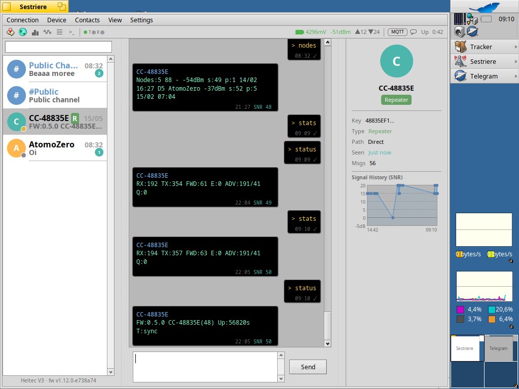

Quick update: Sestriere can now interact with MeshCore repeaters to send CLI commands and configure them over the MeshCore network. I’ve also started adding some icons and minor features for everyday use.

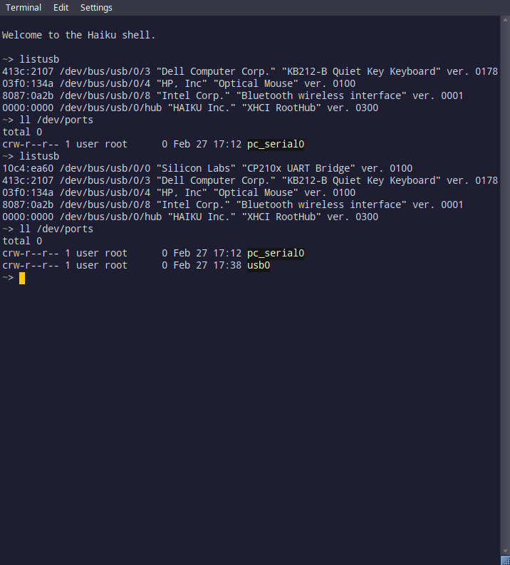

SiliconDevice::AddDevice() in Silicon.cpp calls SetControlPipe() on a BULK OUT endpoint, then SerialDevice::Open() calls queue_interrupt() on that pipe. The USB stack correctly rejects it because it’s not an interrupt endpoint.
Syslog shows:
usb_serial: Silicon Labs CP210x USB UART converter (0x10c4/0xea60) added
usb_serial: failed to queue initial interrupt
The device node never becomes usable.
Root cause:
CP210x chips only have two BULK endpoints (IN + OUT) — no interrupt endpoint. Unlike ACM or Prolific devices, all control operations go through USB control transfers. But SiliconDevice::AddDevice() assigns the BULK OUT handle to both fControlPipe and fWritePipe, and requires pipesSet >= 3 even though only 2 endpoints exist.
The fix (two files):
  1. Silicon.cpp — Remove SetControlPipe() call, change threshold to pipesSet >= 2
  2. SerialDevice.cpp — Add if (fControlPipe != 0) guards before queue_interrupt(), cancel_queued_transfers(), and in _InterruptCallbackFunction()
Note: FTDI.cpp has the same pattern and could benefit from the same fix.
Tested on: hrev59375, Heltec LoRa32 V3.2 (VID 0x10c4 / PID 0xea60)
