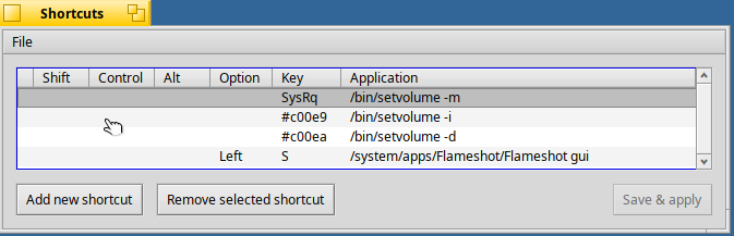

I am using default settings and only switched Shortcut key to Ctrl:
shortcuts
F2 has a second function “decrease volume” on my laptop keyboard.
The volume shortcuts F1-F3 don’t work on my latest nightly at all, using hrev58785.
The screenshot shortcut works however, just F keys are remapped to default after a short while.
