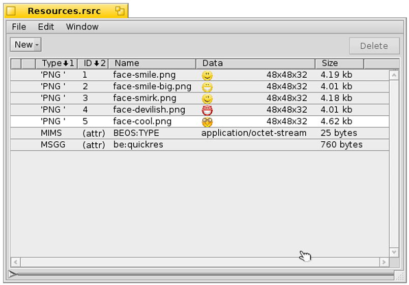

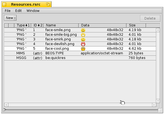

I would like to create and use a resources file with my application, but I’m facing two problems:
  1. How to configure a PNG picture into the “.rdef” file?
    A saw many examples of using ‘PNG ‘ type in the resources file, like:
    resource(1, “builtin-tools”) #'PNG ’ array {
    $“89504E470D0A1A0A0000000D494844520000022E0000001208030000004BB3A5”
    $“FF17F6CF36F92F1B9E631E8B8F3FBC0000000049454E44AE426082”
Or
So it seems possible, but please, how to convert my 24x16 PNG format image to a ‘PNG ‘ array in the “.rdef” file?

You can use xres to set your PNG as a resource directly on your executable file. rdef files only make things more complicated and slower in this case.
Here are the commands I use:
    # Prepare your resources as usual (for the app version, for example):
    rc -o Resource.rsrc Resource.rdef
    # Add the resources from the rsrc file, and add any extra one straight from binary files:
    xres -o your_executable Resource.rsrc \
		-a PiNG:2:bulb-normal  resources/graphics/bulb-normal.png \
		-a PiNG:3:bulb-big     resources/graphics/bulb-big.png \
		-a VICN:4:away-online  resources/icons/away-online.hvif \
		-a VICN:5:online       resources/icons/online.hvif \
		-a VICN:6:offline      resources/icons/offline.hvif \
		-a VICN:7:unknown      resources/icons/unknown.hvif \
		-a VICN:10:preferred   resources/icons/preferred.hvif \
		-a VICN:11:home        resources/icons/home.hvif \
		-a VICN:12:work        resources/icons/work.hvif
The syntax is: -a type:id:name path/to/file
The type can be anything you want, I used PiNG here for PNG files. VICN is the standard for HVIF icons.
The ID and/or name are used to access the resources from within your code.
It’s important to add all the resources (from the rsrc file and the -a options) in one single run of xres, otherwise adding one resource may erase the previous ones.

You can also import the resource straingth to rdf file with following syntax:
resource(1, "resourcename") #'PNG ' import "file.png";
