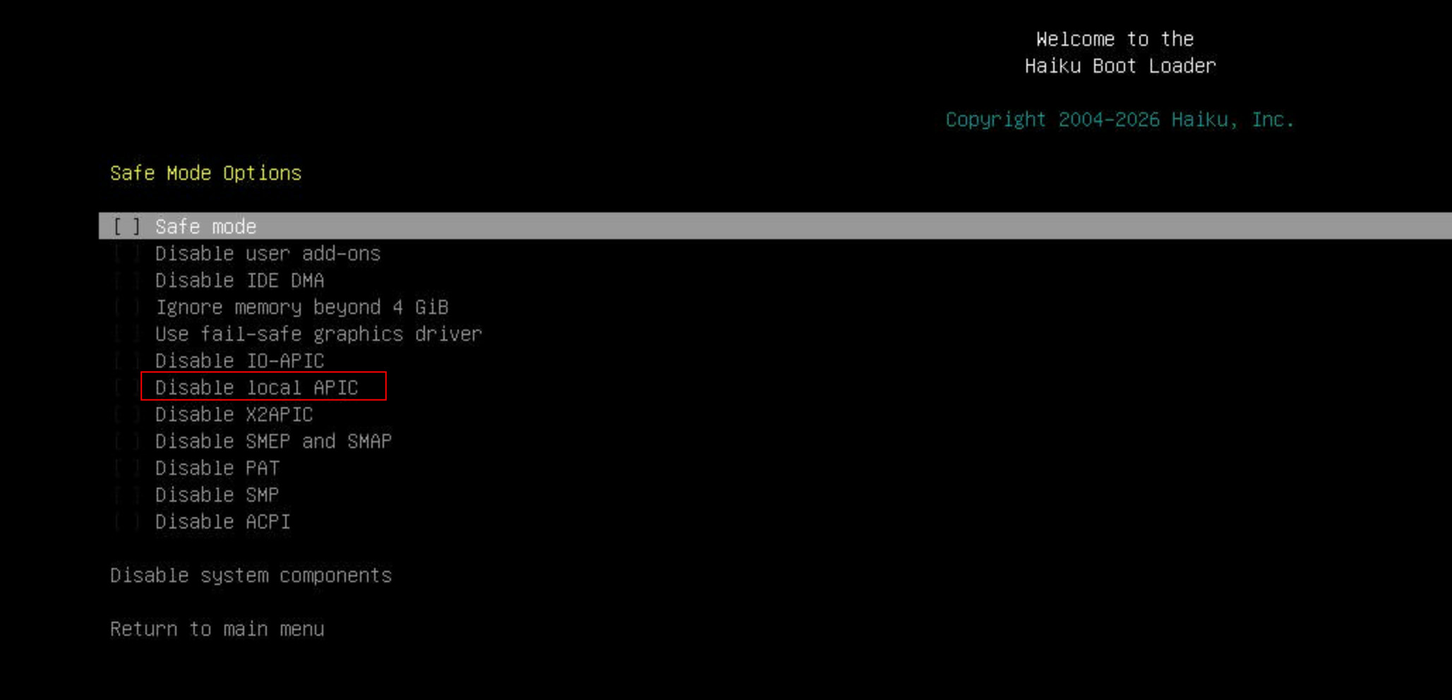

Based on Google
pci=nomsi means
In Linux, pci=nomsi is a kernel boot parameter that tells the operating system to disable Message Signaled Interrupts (MSI) and MSI-X for all PCI/PCIe devices. It forces the system to fall back to older, legacy INTx interrupts. [1, 2]
So, the option you would disable …
Disable IO-APIC
Disables using the IO APIC for interrupt routing, forcing the use of the legacy PIC instead.
( Source HAIKU —> User Guide → Bootloader )
There is no way to disable just MSI.
If I read the sourcecode correctly, IO-APIC is unrelated and will not help. Maybe disabling both lcoal APIC and X2 APIC will work (but will also disable other things such as multiple CPUs support).
We should probably add a new option to disable just MSI? It should be relatively simple to implement.
I do not know the options correctly described in the user guide related to the code, but as in case Linux the nomsi ment that interrupts forced to be legacy INTx, so I selected IO APIC disabling - that seemed covers that based on user guide description - especially then SMP still remain if there’s more cores in this machine’s CPU or it is HT capable.
Otherwise an accurately specific option always better.
Yes, pci=nomsi is the solution for different devices: SIS191 network chips, Intel and Atheros Wi-Fi chips, and NVIDIA graphics—it’s a troublesome mix.
The option of implementing names in the Haiku bootloader would be the solution for older Asus/Dell organizers, etc., with serious restrictions for use only in Windows.
Please, it would be a great help to add support for this command in a new “knight” or better yet include it in an official R1 beta 6.
Io/apic not resolved the problem.
The solution for this machine is pci=nomsi
But pci=nomsi no are implemated in the Haiku boot…and force this options for the intelx64 2 core duo gpus and wify atheros ethernet sis 191 and Nvidia 930 gsm are greats problems for compatibility in other os.

Seems like a easy hook to add into msi.cpp.
Also, does disabling AIPC also disable MSI currently?

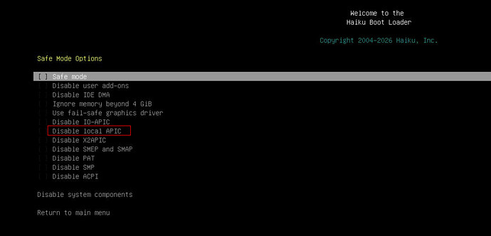

Did you try “Disable local APIC” (not IO-APIC)
Yes,and no resolve the problem.

Ahoy @Sugusapple ,
I will inform you, if the mentioned patch for bootloader to be able to disable MSI only get into merged ones.
That will get into a nightly image soon, so you have to download that nightly image which exactly the same revision number or above. Depends on how much revision were merged between that patch and when buldmaster (the process that compiles code to executable binaries and config files, and make an image - so a bootable Haiku ISO image itself ) does its scheduled work in the night (night in Europian time :slight_smile: ).
