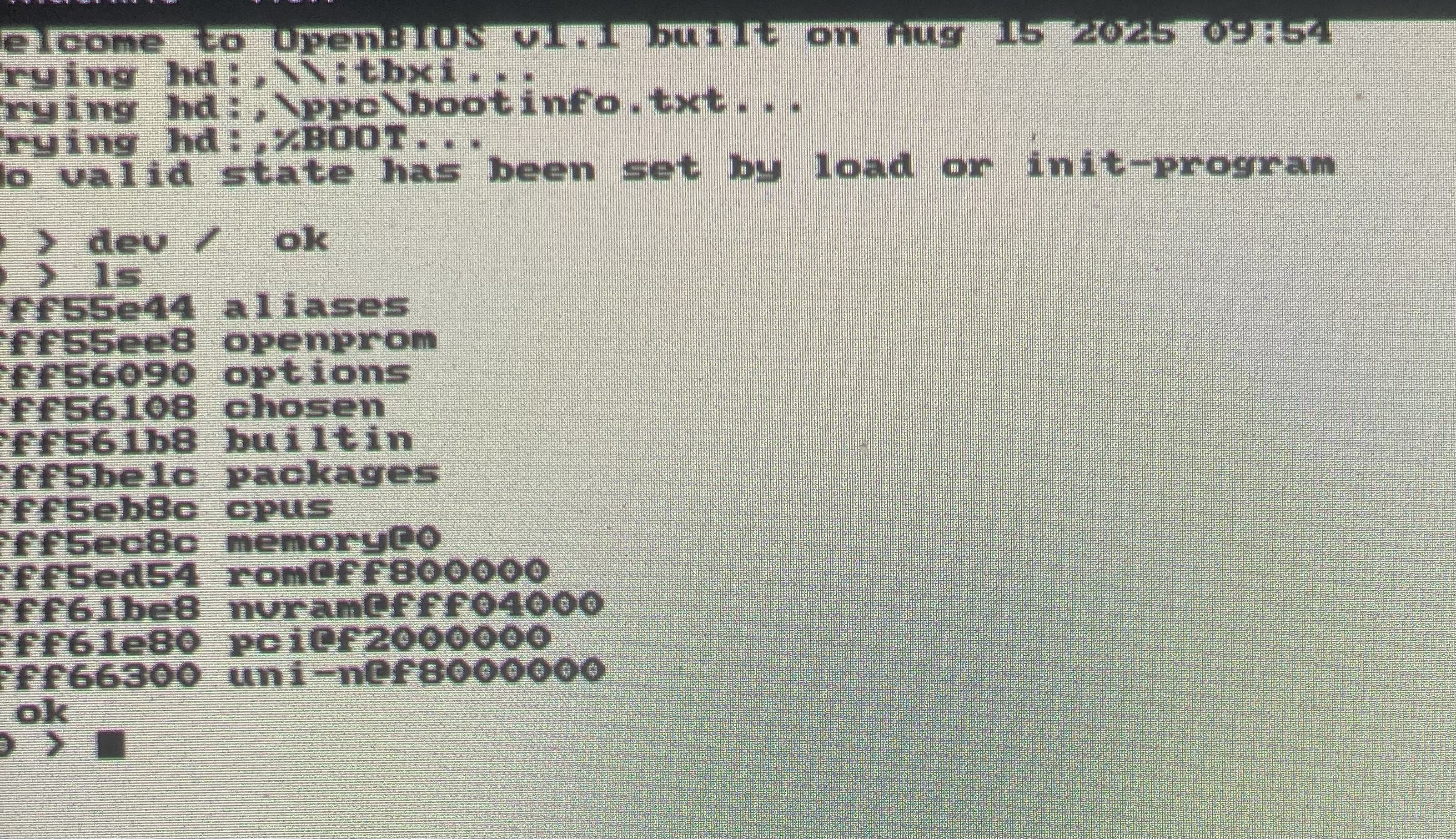

Fixing that and now would be on the step to boot the image in a vm, but no dice. I tried qemu powerpc but the finished 20GB haiku-bootstrap.img seems to not be bootable, atleast I can’t figure out how to get the openfirmware in qemu to try and boot it… supposedly it is attached as cdrom.

You need to boot using the boot_loader_openfirmware file (should be somewhere under objects, haikuloader does not work for me). For real hardware, I’m using a tftp server and the disk server to boot from haiku-bootstrap.img . Before that, I manually created hfs disk files, on which I moved the bootloader, which could then be boot in qemu
