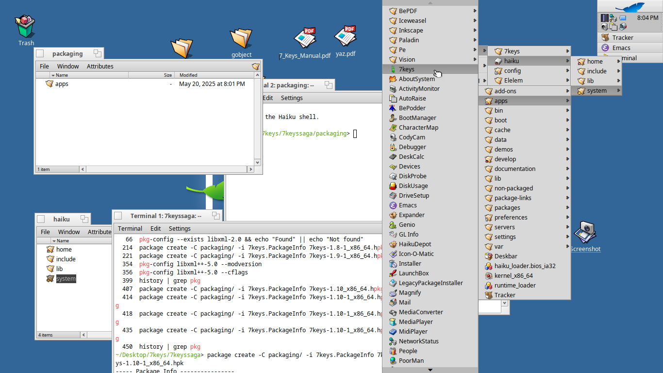

As a small feedback, It would be nice to not shove all stuff into Apps/.
If you want to make it a little bit more native you can use the finddir api, and put the stuff into data/7keys/ in the package, checking first in B_SYSTEM_DATA_DIRECTORY and then B_USER_DATA_DIRECTORY, of course that is just to get the A+ :wink:
Now that I’ve seen that icon I’m inspired to make it more Haiku native!

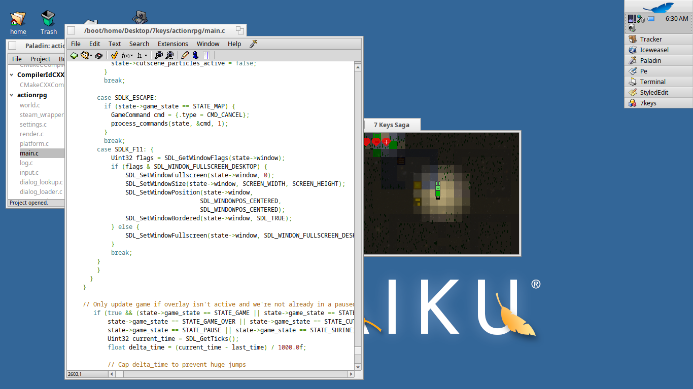

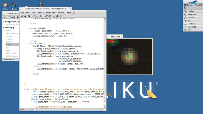

I think not even that is needed. I just realized that, while running the program on Emacs, the command output makes it clear “full screen” is actually a BRect. In my case, once I hit F11 I get this:
screen frame: BRect(l:0.0, t:0.0, r:1365.0, b:767.0)
F11 was being recognized, but wasn’t toggling. I added
		        SDL_SetWindowBordered(state->window, SDL_TRUE);
After adding that it is working on my system.
		case SDLK_F11: {
		    Uint32 flags = SDL_GetWindowFlags(state->window);
		    if (flags & SDL_WINDOW_FULLSCREEN_DESKTOP) {
		        SDL_SetWindowFullscreen(state->window, 0);
		        SDL_SetWindowSize(state->window, SCREEN_WIDTH, SCREEN_HEIGHT);
		        SDL_SetWindowPosition(state->window,
		                             SDL_WINDOWPOS_CENTERED,
		                             SDL_WINDOWPOS_CENTERED);
		    } else {
		        SDL_SetWindowFullscreen(state->window, SDL_WINDOW_FULLSCREEN_DESKTOP);
		    break;
I think having application data contained in a subdir of apps is fine if nothing else is expected to use that data, TBH.
If you don’t do this you can use Tracker in icon mode to launch applications…
I wasn’t handling the assets very well on other systems either so I went back, made them a proper sprite-sheet, and embedded that in the executable.
7keys-1.10-1_x86_64.hpkg
