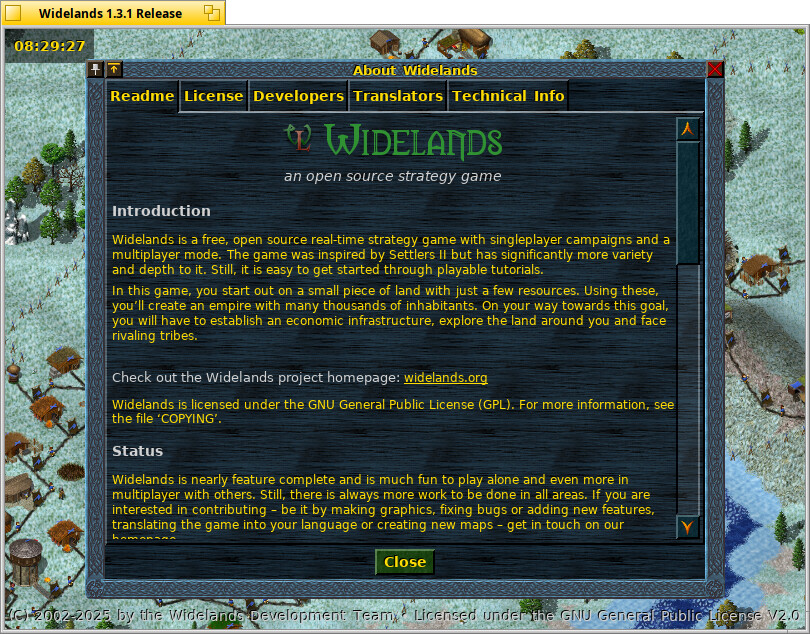

EDIT: maybe switch to latest 1.3.1 release, asio issue resolved there, and with the above patch for “_GNU_SOURCE” it builds OK (should be fine with boost190 also, didn’t check there yet. Looking forward on a PR to update this. :slight_smile: (maybe asio could be bumped here too).
EDIT2: asio has been updated to 1.38.0 just now.
I’m pleased that you like my choice of package to start on. :slight_smile:
When I had trouble building I did switch to version 1.3.1 which did not resolve that issue, but it is good to know that it is needed for compatibility with asio. It turns out that the problematic code that your patch addresses was added by the port’s patch so the fix is as simple as just not messing with network.h.
