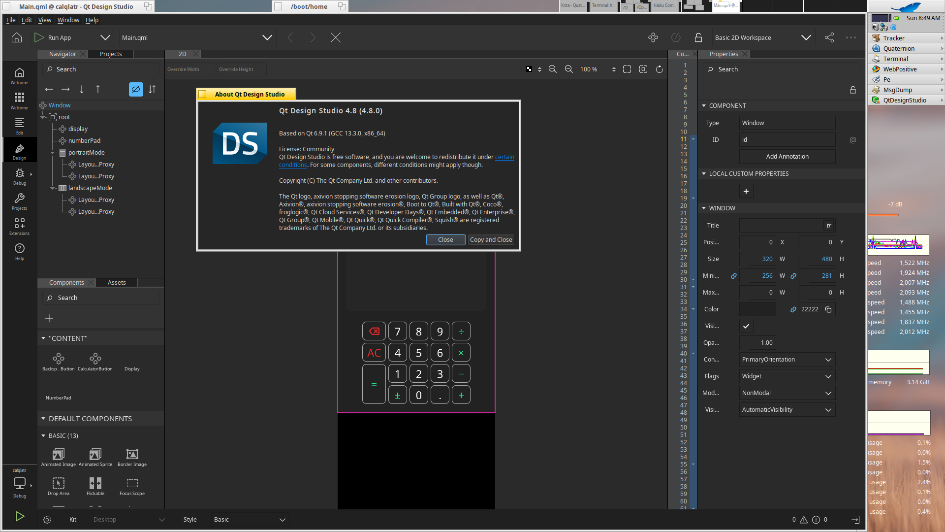

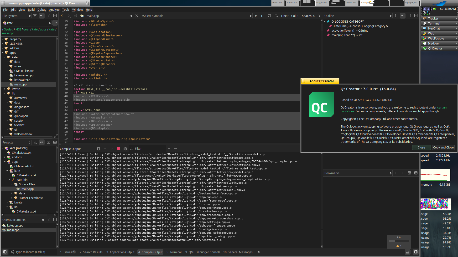

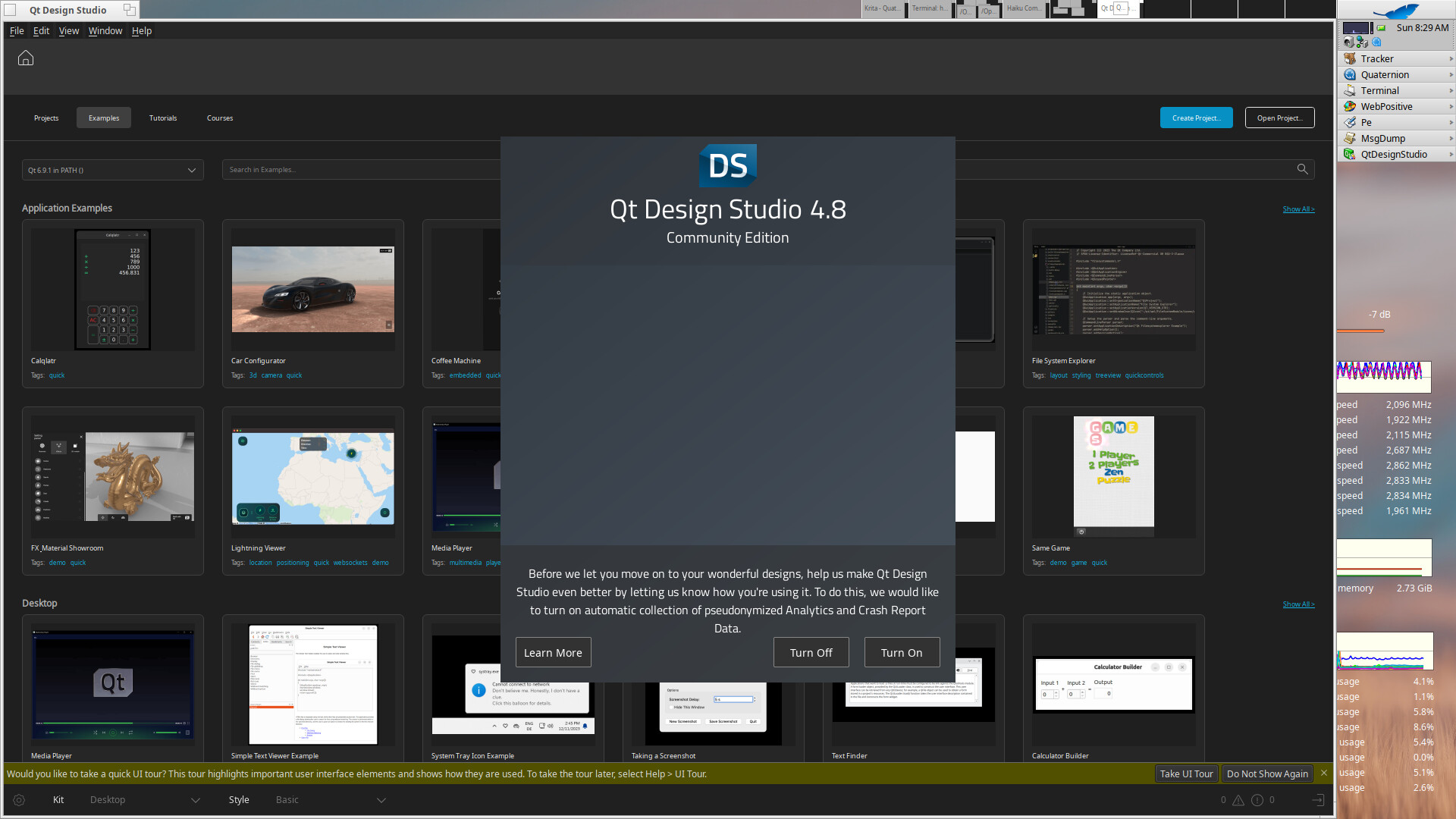

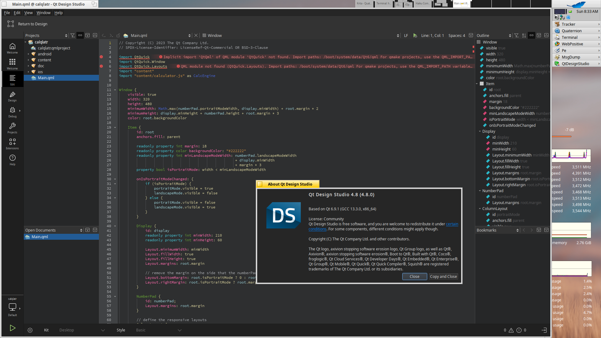

QtCreator 17.0.0-rc1 build with Qt 6.9.1 :slight_smile:

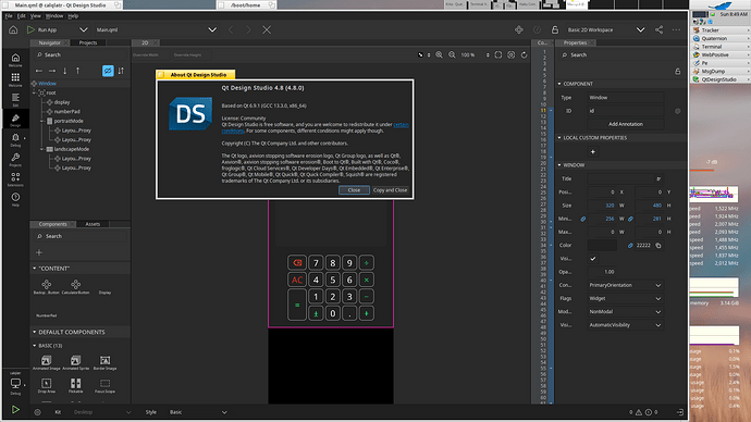

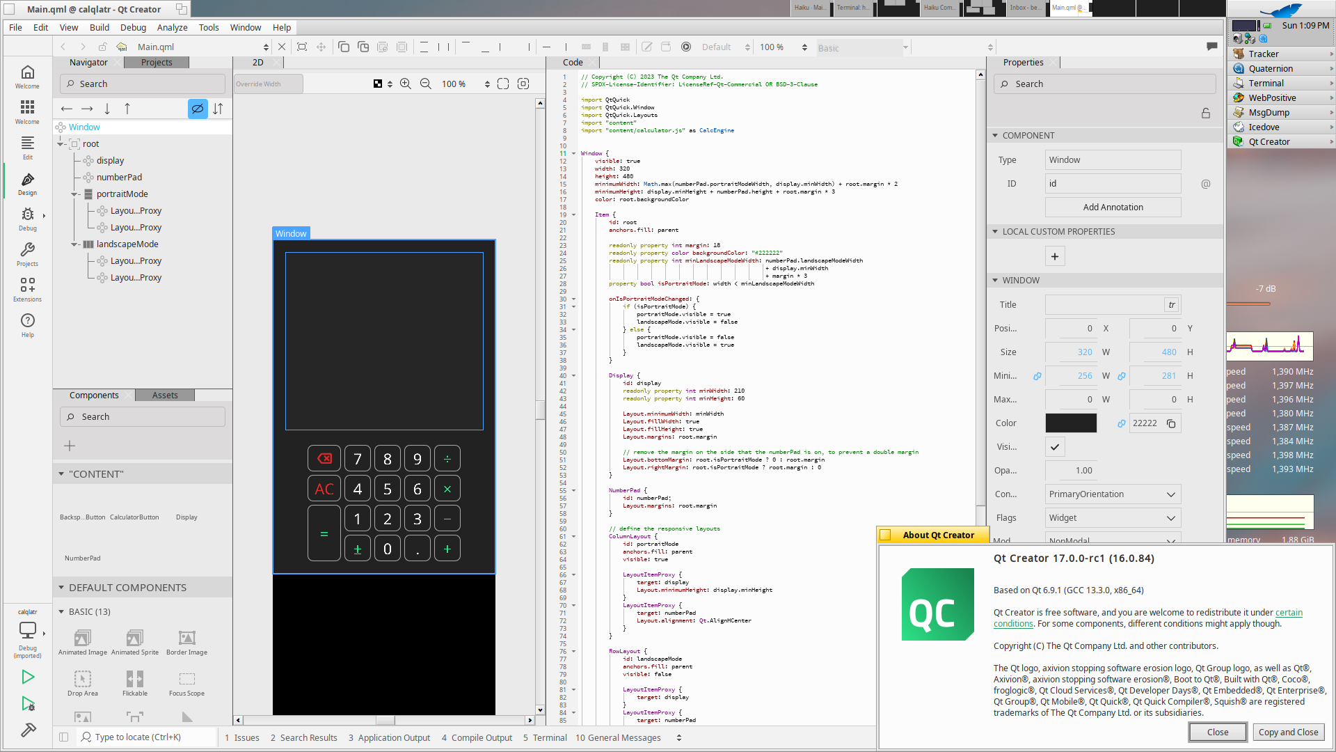

Playing around a bit more with the sources I saw QtDesignStudio 4.8.0 is included also, building works fine and it runs fine also, packaging seems to be a problem as it changes something in the QtCreator binary at the end.
Call me blond :slight_smile: the Design Studio plugin is already available in the QtCreator package, just needs activating :rofl:

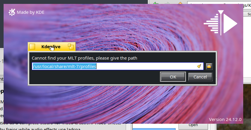

EDIT:

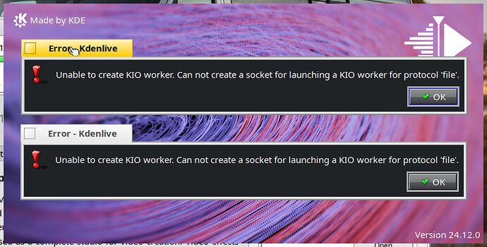

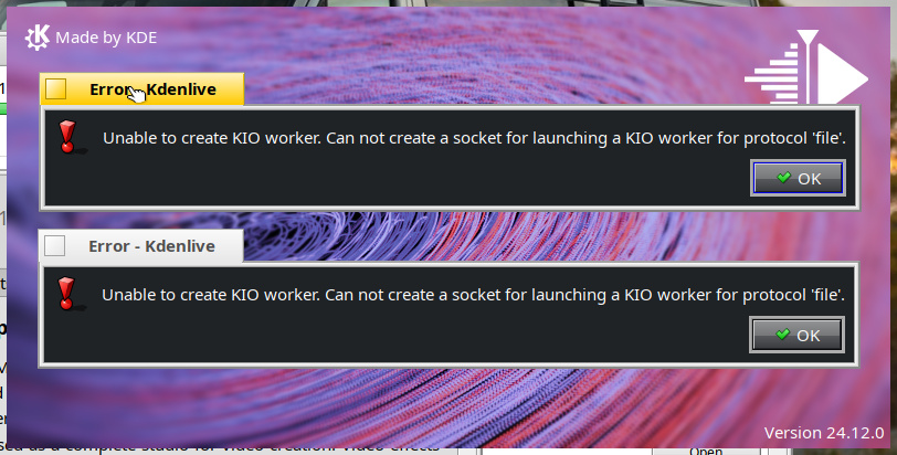

This popped up and the correct path shoud be /boot/system/data/mlt-7/profiles
Once you put that path in and the app opens, I would exit cleanly and re-open the app so the path is stored. Otherwise you will have to enter it again.
Then this popped up, but clicking OK was fine and the app opened. But the error is persistant, it pops up when trying to open or import a video file and the app crashes.
But this is exciting progress! Great work Begasus!
The issue with KIO worker is one of the reasons a few of the KDE applications (read Dolphin and a few others I can’t remember atm) are not defaulting to KF6, others are not directly having this issue.
Sometimes it helps to first install/run the KF5 version and then install the KF6 version, somehow it triggers something so the KIO worker does work. :frowning:

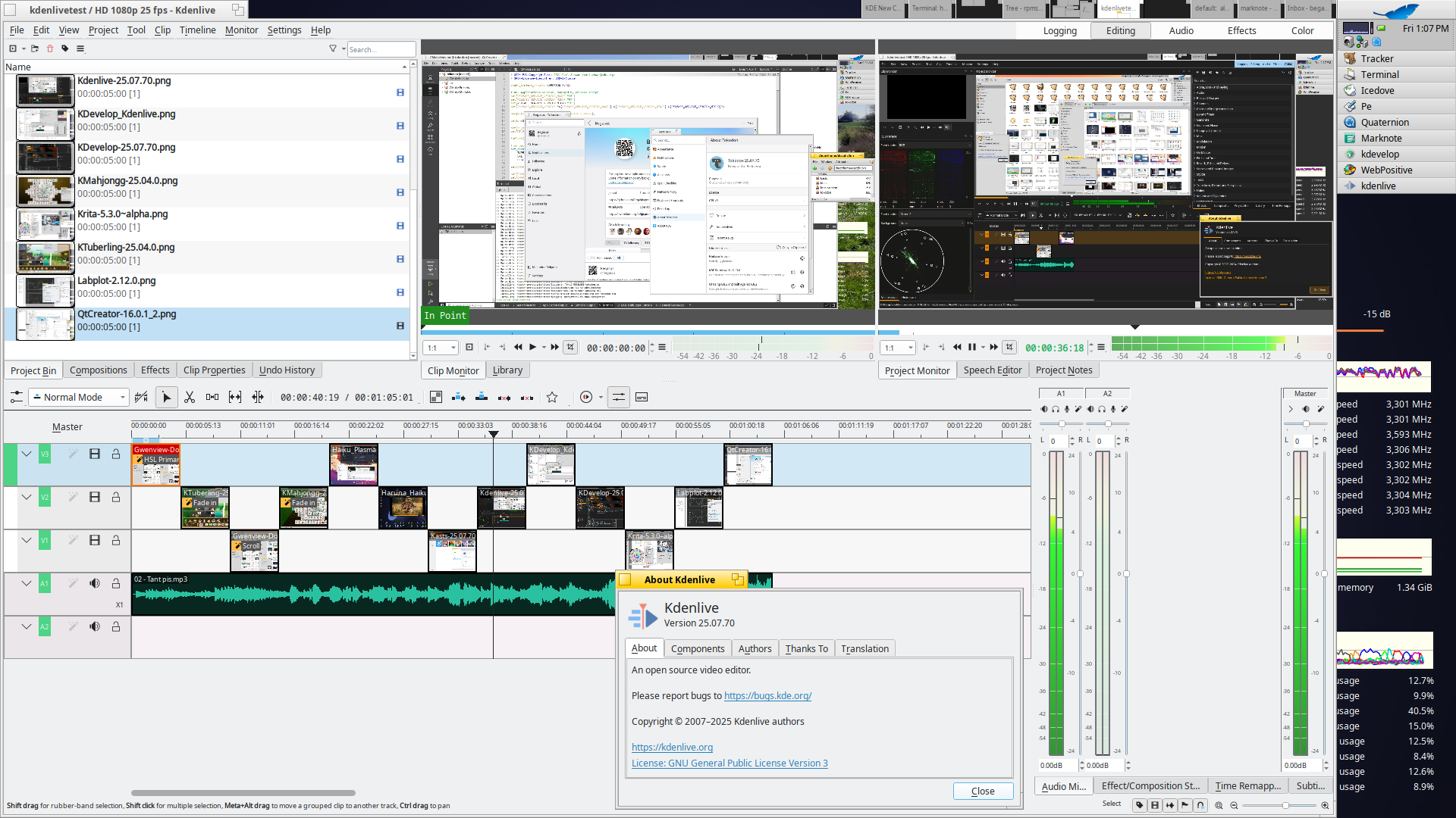

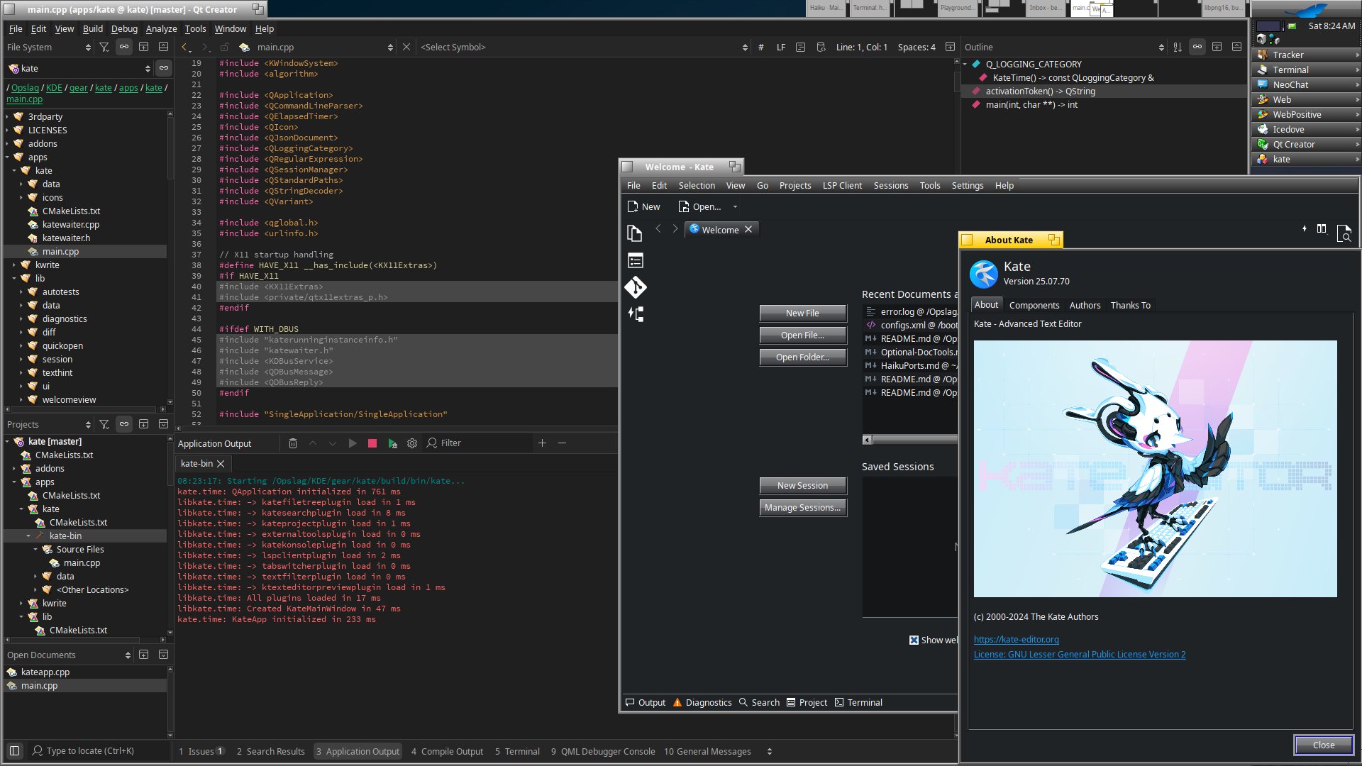

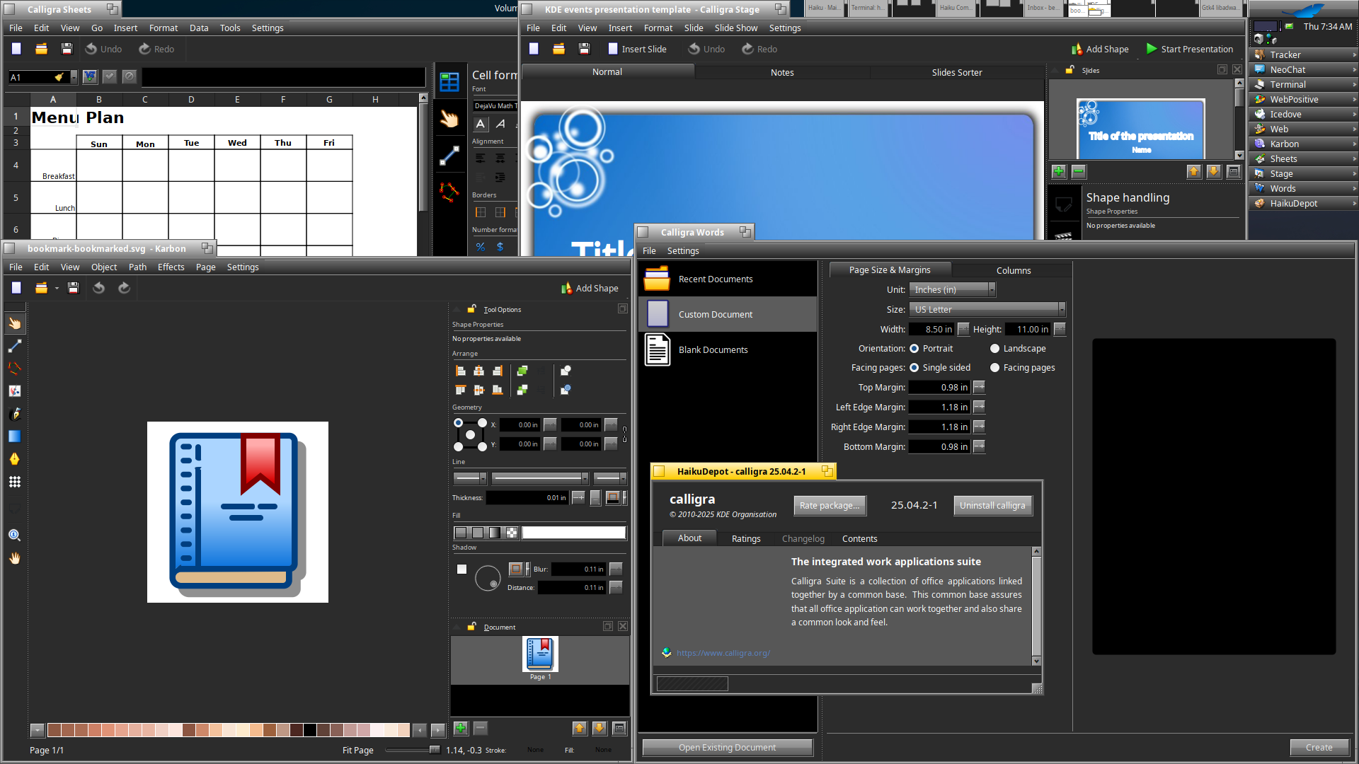

Calligra 25.04.2, needs newer frameworks then the ones currently in the depot (I’ll probably do an update on those next month).
Local build with KF6 6.15.0 and Qt 6.9.1.

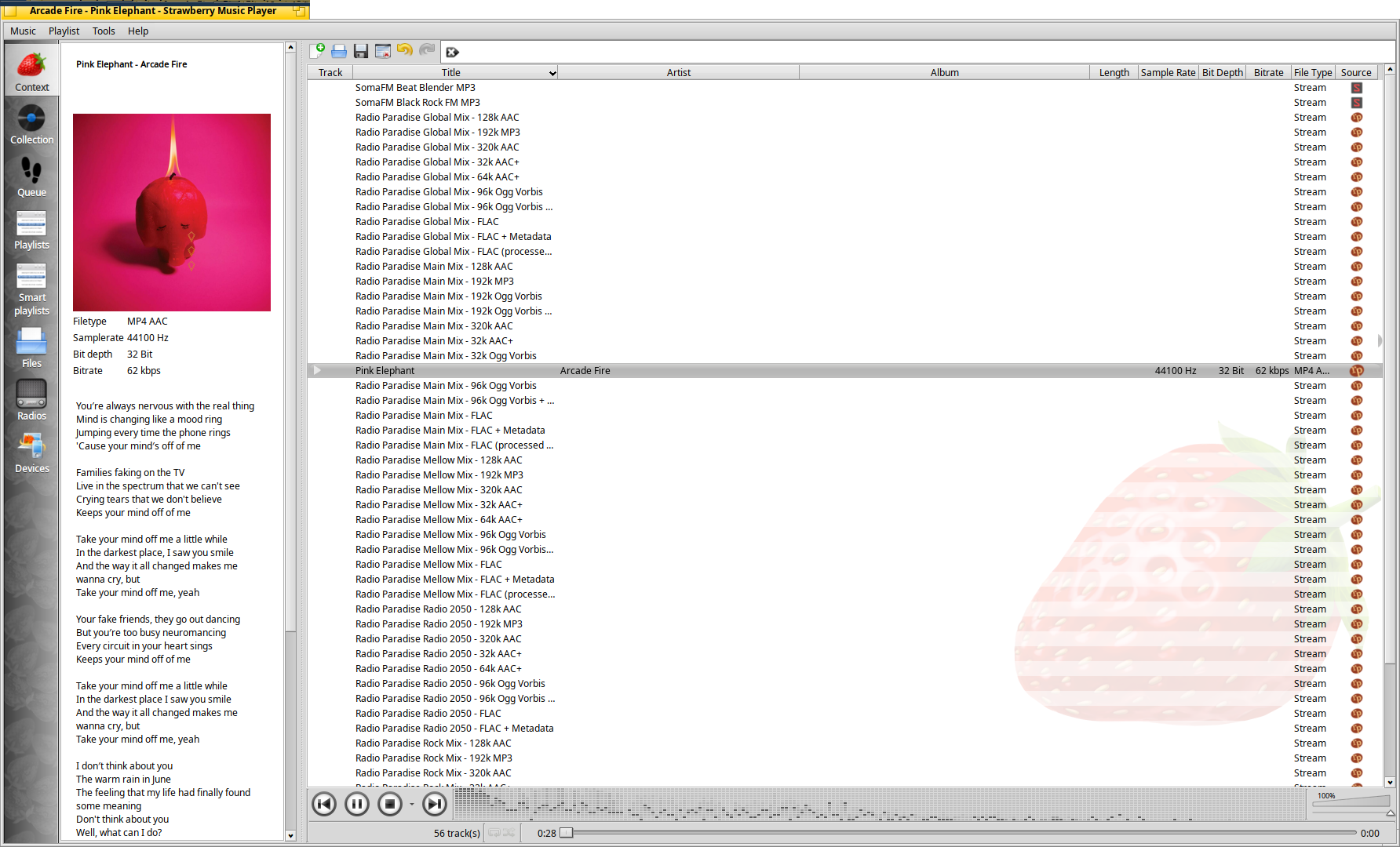

Gstreamer 1.26.2 multimedia framework updated. Ported the FFMPEG plugin, gst-libav, so now AAC works for Internet radio streaming services like SomaFM and Radio Paradise.

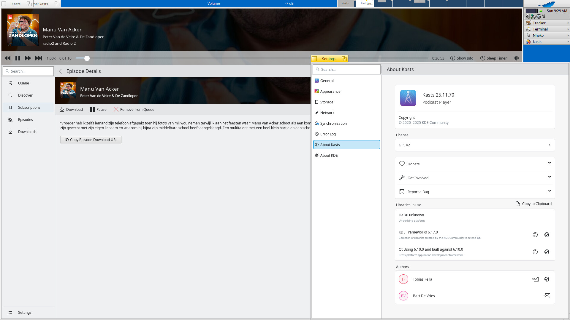

Beta testing :slight_smile: Kasts 25.11.70 with KF6 6.17.0 and Qt 6.10.0-beta1 :slight_smile:

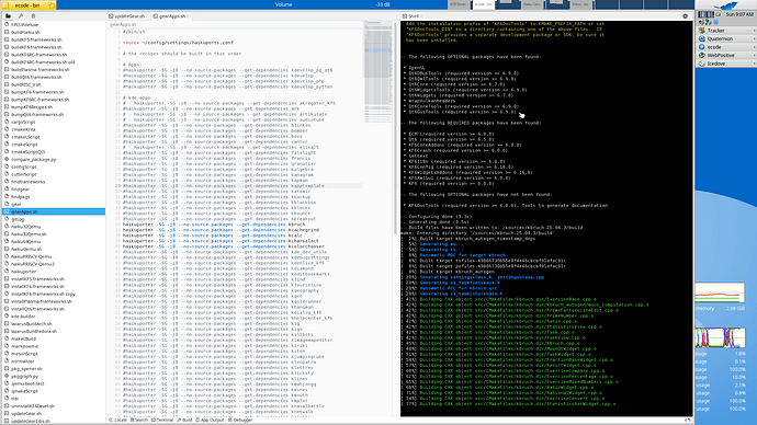

Prepping scripts before gear 25.08 is released (KDE libraries/applications). ecode proves to be handy :wink:
It might benefit from a Haiku UI theme. :wink:
Haven’t checked how this looks on another OS, could you give some hints?
See ecode/docs/uicustomizations.md at main · SpartanJ/ecode · GitHub. You can customize how UI looks with CSS.
One could in principle make a theme that looks native on Haiku.
