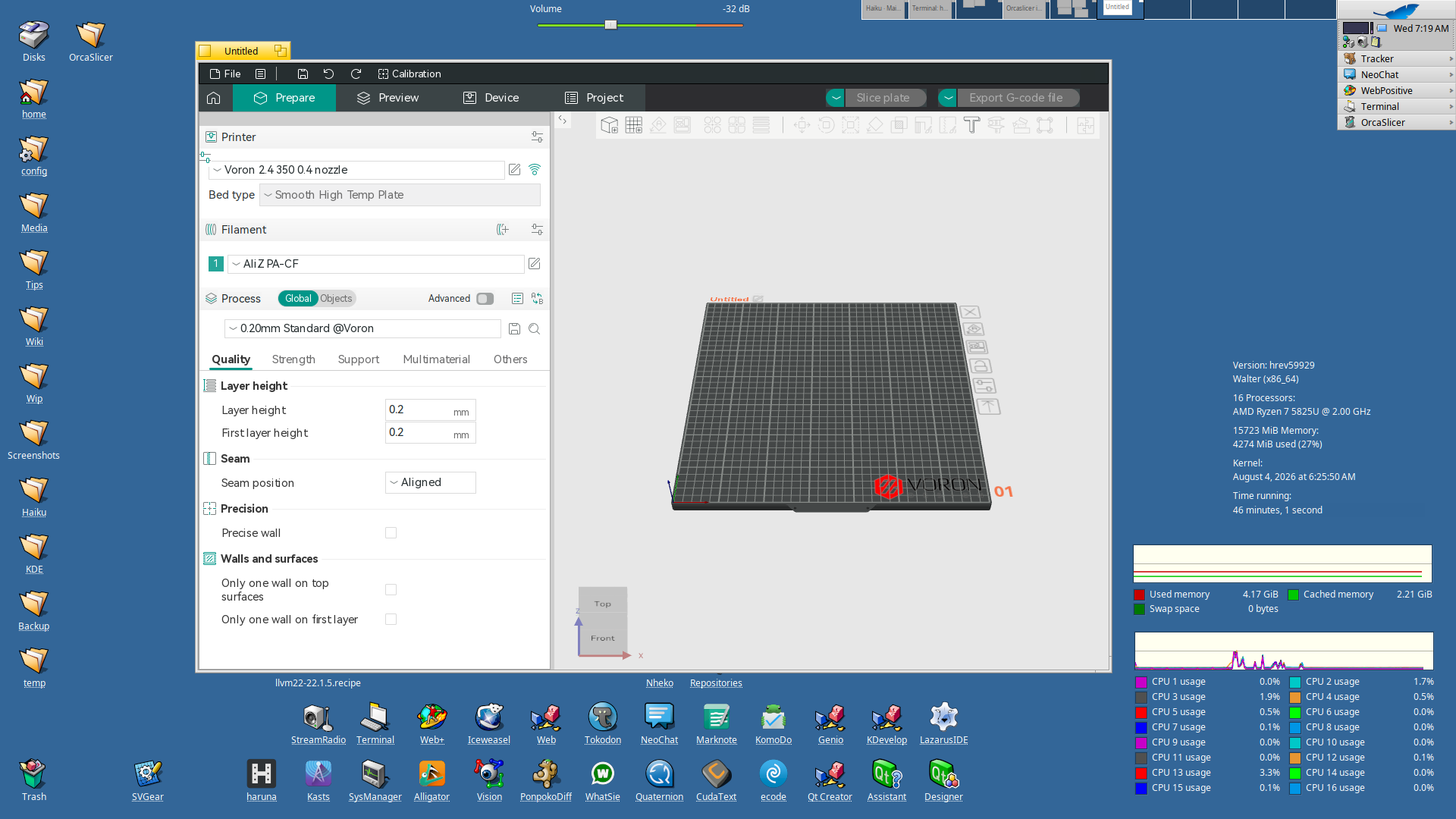

Been looking into webkit_gtk and have a package that helps out with launching some applications (like this one), but it still fails on Epiphany (Web), so not something I’m pleased with in releasing it so far.
Still looking for someone with internal knowlidge to help solving this (no extra information mentioned in Terminal launch or in syslog when launching Epiphany).
