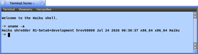

Haiku R1B6-dev (hrev59899 x64)
yt_dlp-2026.03.17-1 from repository system is already installed

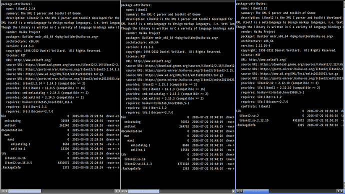

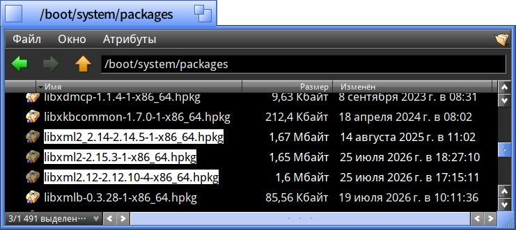

Main problem for now is the switch to the newer libxml2 wich breaks quite some things, good new, we as the haikuports team have been busy with updating major parts to make sure things are on par with the new library, this means having a lot of packages needing a rebuild.
@waddlesplash already did a major revision bump on all packages relying on this, after that we are finishing up on the other parts (haikuports team).
Possible sollutions, uninstall fontconfig_devel and reinstall it (this will bring in the new libxml2), this worked for me on 32bit, then run a “pkgman full-sync”. Or “pkgman install libxml2..12” (this will replace the old libxml2 - still the same version), then try “pkgman full-sync”.
There will be some downfalls, on 32bit haikuwebkit is still broken for the new libxml2 and thus on a full-sync WebPosite will be gone, on 64bit webkit-gtk is still broken, so far major issue for me is that epiphany (Web) can’t be installed, some packages not reported by the buildmasters report are not shown and probably need a rebuild, we can’t tackle them without knowing, so reporting them would be nice so we can have a look at them.
EDIT: please only report things that broken after the full-sync, anything reporting a problem with some package that requires the old libxml2 (2.12.10) package would be usefull.

~> pkgman full
100 % repochecksum-1 [65 байтов]
Проверка контрольной суммы репозитария Haiku…done.
100 % repochecksum-1 [64 байта]
Проверка контрольной суммы репозитария HaikuPorts…done.
Encountered problems:
problem 1: package libvisio-0.1.7-7 requires lib:libxml2>=16.1.3, but none of the providers can be installed
solution 1:
  • keep libvisio-0.1.7-6 from excluded repository
  • keep libgphoto2-2.5.27-1 from excluded repository
  • keep libxslt-1.1.43-1 from excluded repository
  • keep ffmpeg-4.2.9-4 from excluded repository
  • keep haikuwebkit-1.9.30-1 from excluded repository
  • keep libbluray-1.3.1-2 from excluded repository
  • keep aria2-1.36.0-1 from excluded repository
  • keep gimp-3.2.4-1 from excluded repository
  • keep hwloc-1.11.11-3 from excluded repository
  • keep ffmpeg8_avdevice-8.1.1-1 from excluded repository
    solution 2:
  • allow deinstallation of libxml2.12-2.12.10-4
    Please select a solution, skip the problem for now or quit.
    select [1…2/s/q]:
hrev59899 64 bit
~> pkgman install fontconfig_devel
problem 1: package fontconfig_devel-2.18.2-2 requires devel:libxml2>=16.1.3, but none of the providers can be installed
