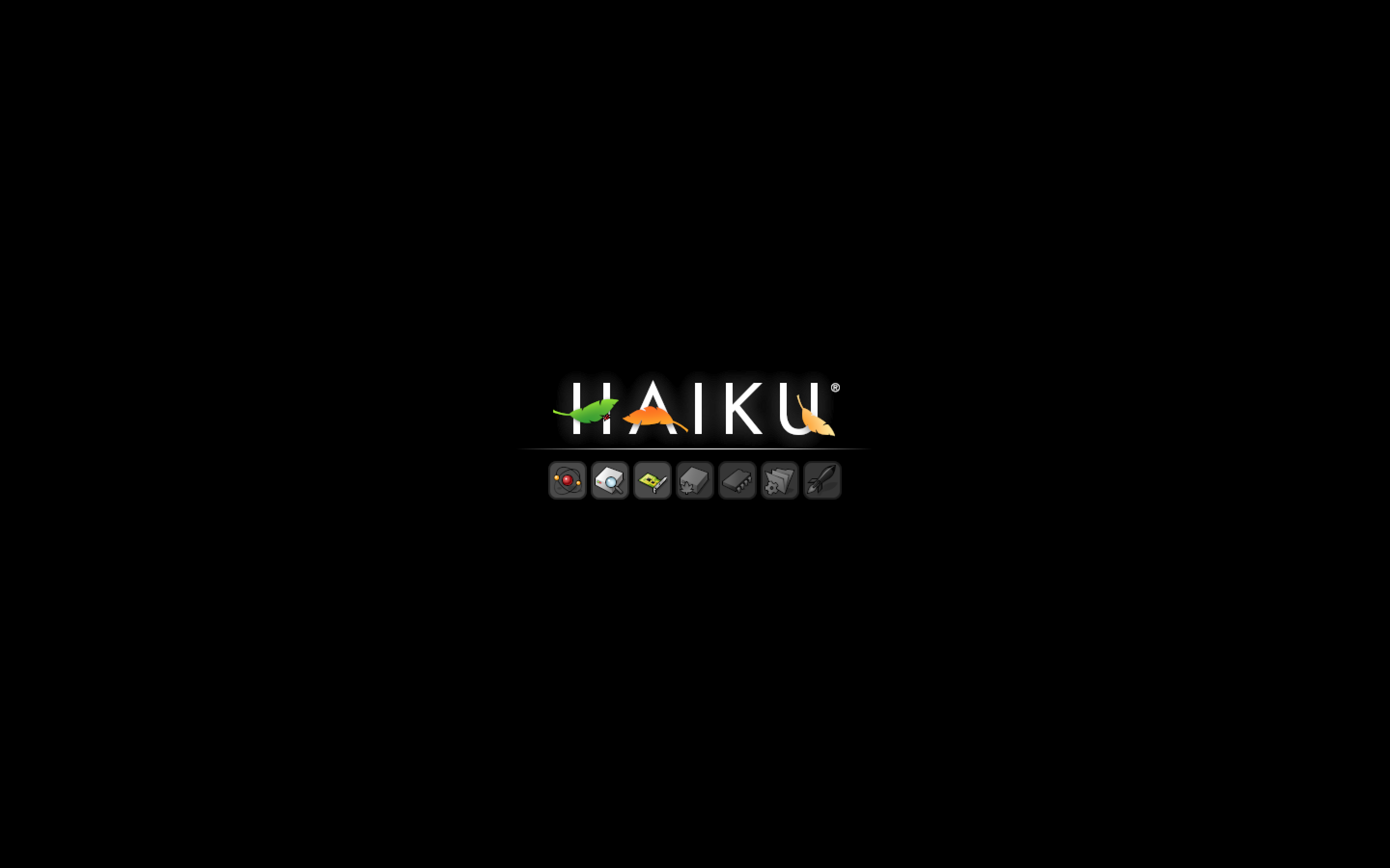

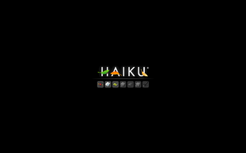

If I try to boot an existing Haiku Beta5 installation using the EFI boot loader from the latest nightly it doesn’t get past the third icon:
I tested it both with a virtual machine and MacBook installation, the result is the same.
Is it a known issue, or should I open a bug?

Well spotted, thanks! It should be Beta5 of course (fwiw I’ve also checked it with an older Beta4 installation, it cannot boot it either)
I am not sure if this is a bug or not. There were a number of changes in the bootloaders after beta5, you definitely cannot boot nightlies with beta5 BIOS loaders at least (the EFI loader may work though.) A syslog up to the stall point would be necessary to diagnose.

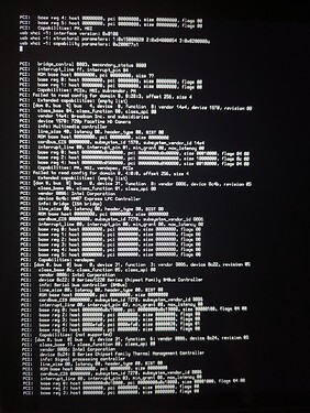

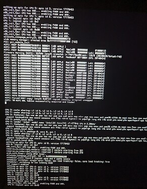

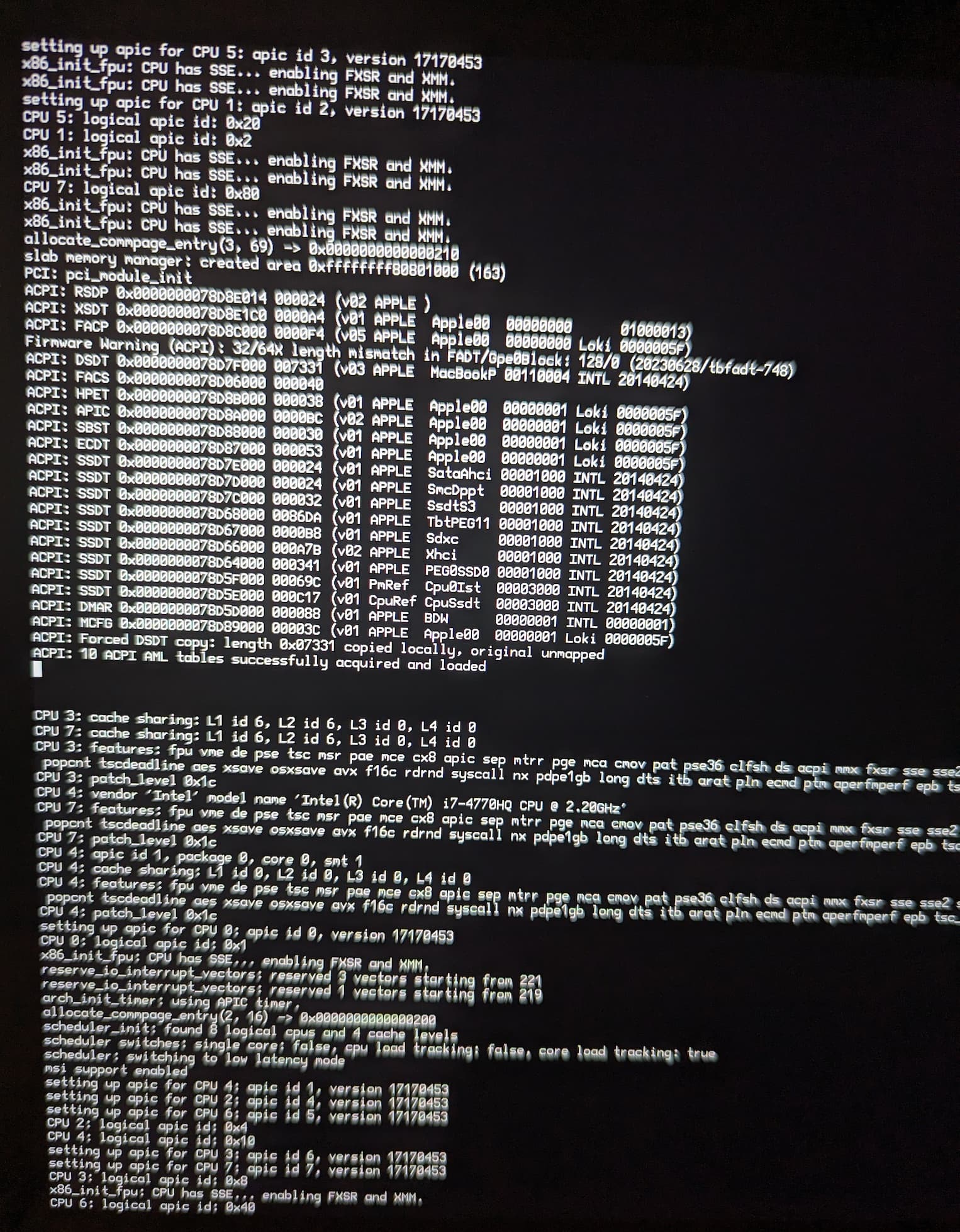

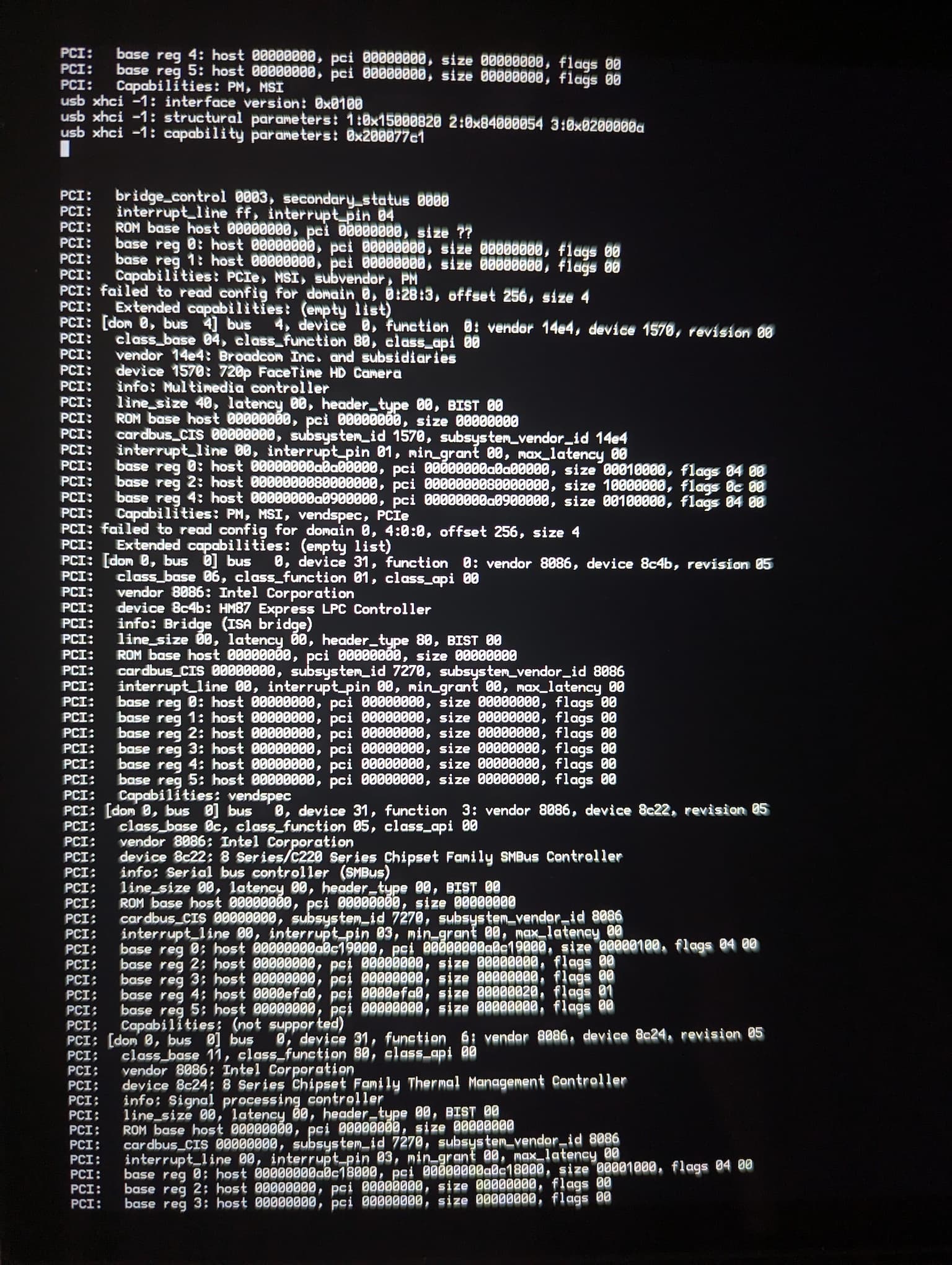

This is the other way around, I’m trying to boot beta5 with an EFI bootloader from a nightly. Here is the photo of the syslog (normal boot and disabled SMP on the right):

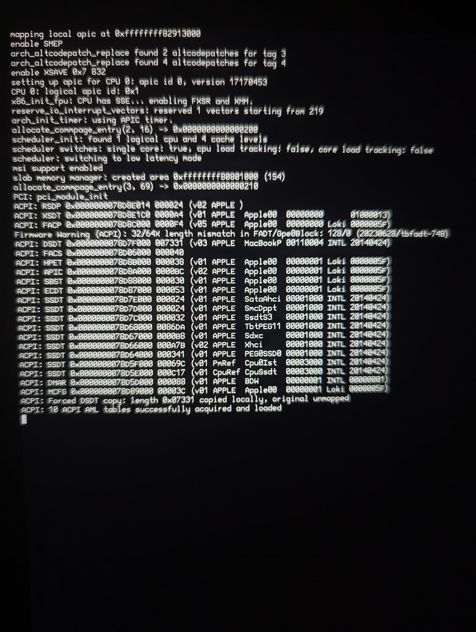

If I disable ACPI it proceeds a bit further and stalls with:
If I disable both ACPI and IO-APIC it boots to the desktop but the keyboard and mouse don’t work.
Ah, I think the problem here is that the APIC timer initialization was moved after beta5 from the bootloader to the kernel. So, indeed this won’t work.
