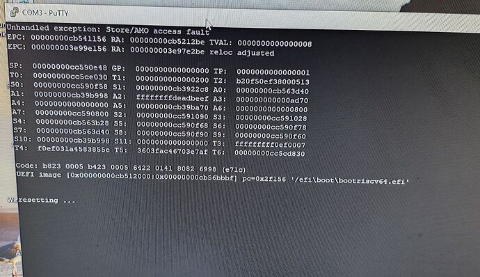

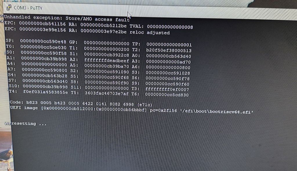

When i use a hrev58684 in VisionFive2, when load haiku uefi made a screen
And I think do upload new U-boot rom? I It’s correct?
Please Help!
I see a deadbeef in register A2. That looks like it probably comes from the new bootloader heap logic that overwrites memory on free().

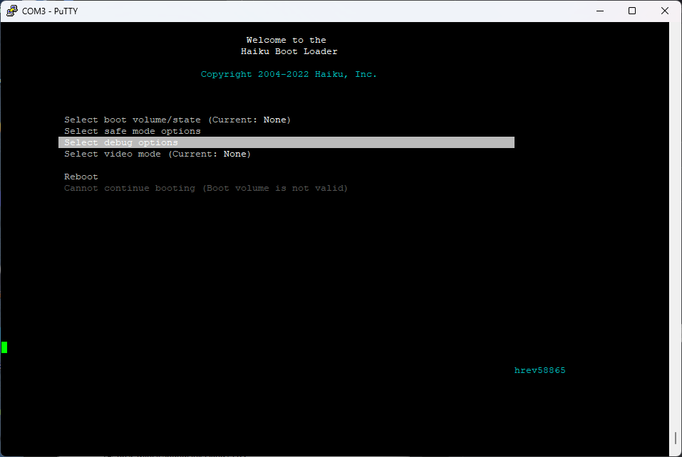

I was able to switch my Milk-V Pioneer over to EFI booting rather then using Linuxboot.
Reference: EDK2 first boot - Pioneer - Milk-V Community
I was able to finally boot in the Haiku boot loader, but haven’t made it past due to some issue about it not finding a valid boot device.
