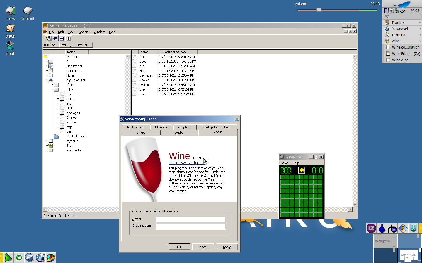

The recipe for Wine 11.8 has landed in Haikuports proper now, so it can be tested by anybody who’s on a development version of Haiku and has Haikuporter set up. The recipe cannot be used on Beta 5 apparently. (The same applies for dosemu2 too btw)
Just a note for future Wine nerds:

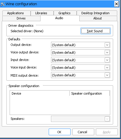

  • Migrate Wine 11.x port from OpenSound (OSS) to Haiku’s MediaKit.

Installed them, and probe again my favourite test executable
î‚Č ïŹ  user  ~    13:21    /boot/system/bin/wine64 /SANDSK256GO/OtherS/DoQ/DL/stresszoldo.exe
bash: /boot/system/bin/wine64: No such file or directory
î‚Č ïŹ  user  ~    13:22    find /boot/system/bin -name win*
/boot/system/bin/winpr-makecert
/boot/system/bin/winpr-hash
/boot/system/bin/winicontoppm
/boot/system/bin/winicontopam
/boot/system/bin/wineserver
/boot/system/bin/winepath
/boot/system/bin/winemine
/boot/system/bin/winemaker
/boot/system/bin/winegcc
/boot/system/bin/wineg++
/boot/system/bin/winefile
/boot/system/bin/winedump
/boot/system/bin/winedbg
/boot/system/bin/winecpp
/boot/system/bin/wineconsole
/boot/system/bin/winecfg
/boot/system/bin/winebuild
/boot/system/bin/wineboot
î‚Č ïŹ  user  ~    13:23    /boot/system/bin/wine /SANDSK256GO/OtherS/DoQ/DL/stresszoldo.exe

Seems what worked under Linux Mint, from a BFS formatted drive .. still needs some further software to work on Haiku that smoothly as well
That means the Buildmasters got updated and recipes got re-triggered, wine couldn’t be built on beta5-based buildmasters.
The same is true for dosemu, which just received a package today as well.
Wine on Haiku needs a lot of work to even come close to what Wine can do on Linux, at the moment it’s just a toy for testing, treat it as such.
