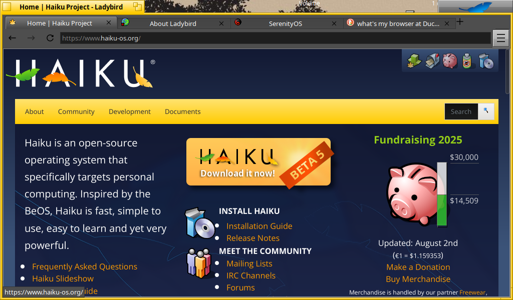

Do you recently tried? I was able to compile it with the 32 bit compiler because I have an Eeepc 900 and I was wondering if this browser could help it. I applied some of your patches manually redoing them because they changed the sources in the meantime, but I also had to change a bunch of libraries because they assume 64 bit compilation… it is very messy process so I do not encourage anyone to try it.
Anyway, after a day or so at compilation I was finally able to reach an end and it started up:
It is very buggy and unstable though, most of the sites will crash it :frowning:
Note: the 32 bit port available in haikuports is very old and unstable as well.
