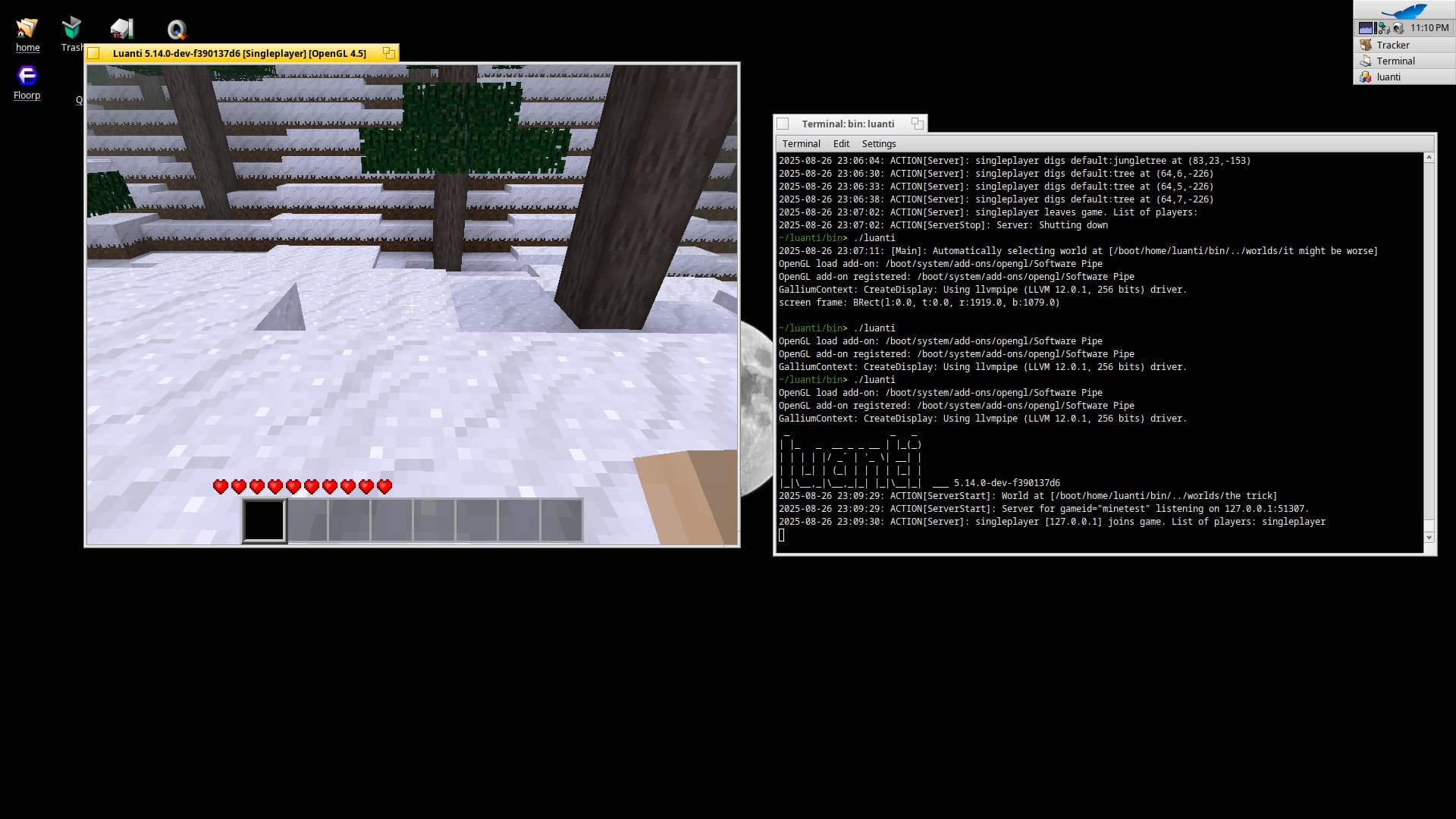

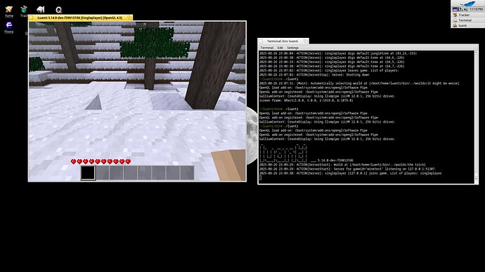

So after installing a few dependencies I was able to get luanti to work, it runs smoothly as long as you keep the viewing range down to 30 or 20 well in my case at lest it may vary for you also just a heads up when compiling the game you have to disable OpenAL I tried installing the development packages for that and everything it just wasn’t finding it

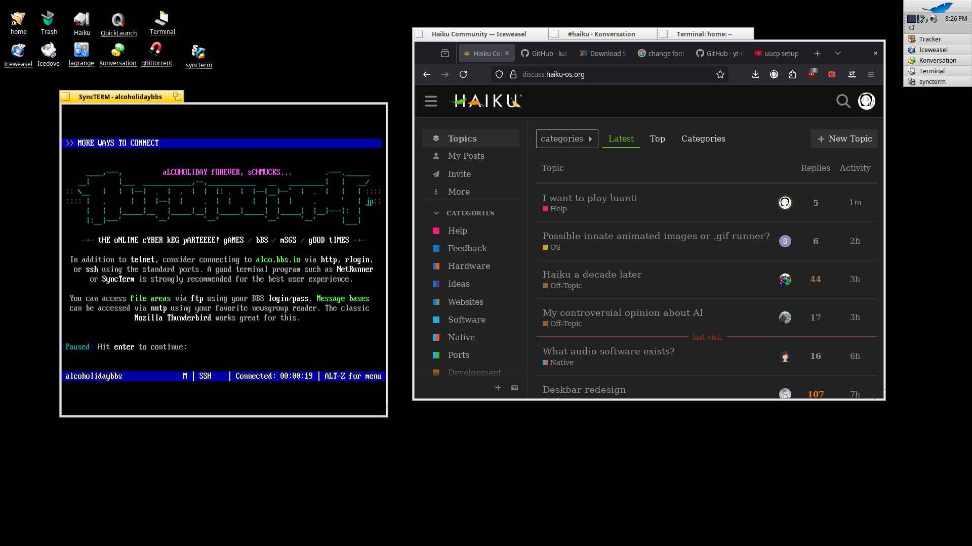

Me jumping onto my favorite BBS server Using the Haiku port of SyncTerm
Alcoholiaday BBS The SSL certificate is expired but not Don’t worry it’s safe

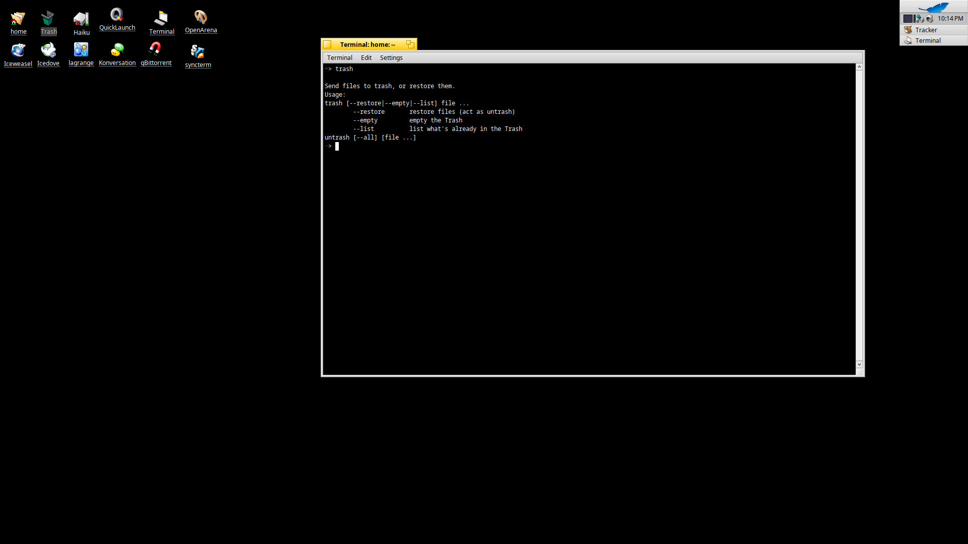

I had to install trash-cli using npm, but it works on Haiku i can confirm that does move files to the trash can and everything
It appears as though you’re running the built-in trash command that comes with Haiku.
I did not know that lol well that’s what I get for not reading things

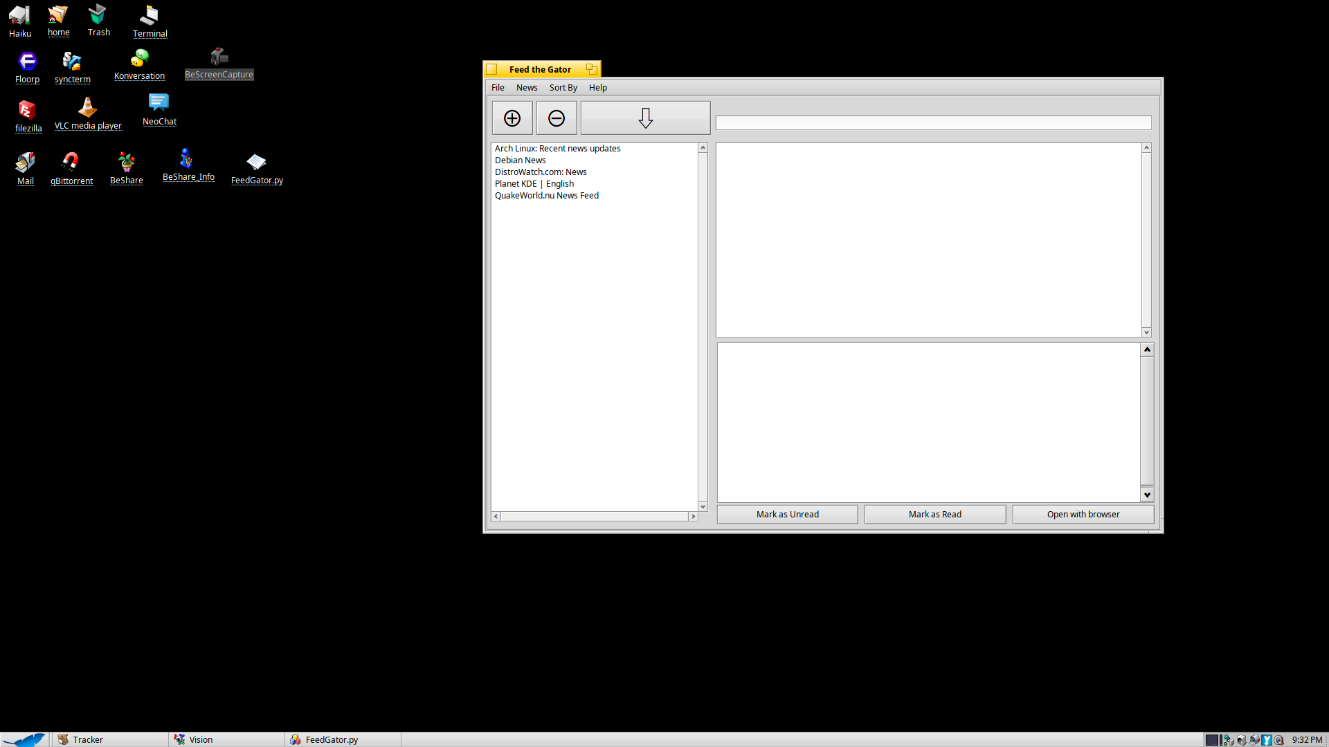

Poking around with feed the gator
