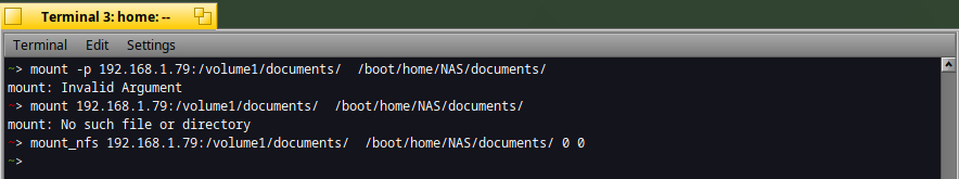

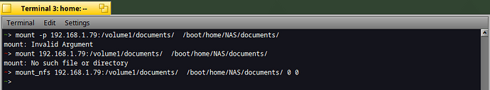

I own a NAS Synology but I never got the ā€œmountā€ command working fine, so instead I have used ā€œmount_nfsā€.
Below are the various tests which indicates there’s no permission issue, however not sure to understand what is wrong with ā€œmountā€ or if an option/argument is not correctly used?
Are you all connecting using credentials? If so how?
Or did you have to create a public/password-less share on you NAS?
AFAIK, NFS is not using credentials but instead IP adresses and uid/guid.
On the NAS, the list of authorized ips is available in the /etc/exports file
If you are using the regular mount command then you must specify the filesystem type with -t nfs4. So, in your case it should be something like mount -t nfs4 -p 192.168.1.79:/volume1/documents /boot/home/NAS/documents
Indeed with that option it’s now working fine!
Thanks :slight_smile:
One comment on ā€œmountā€ with -t nfs4 : the performance is quite better than ā€œmount_nfsā€ which is a good news (it might be due to the nfs version used).
