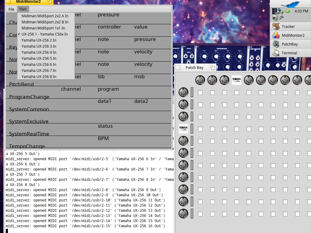

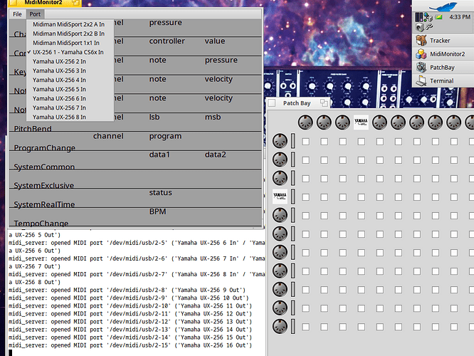

  • Two new features as seen in the screenshot:
    • Per port device naming is now configurable - note the “Yamaha CS6x” actual device name
    • Per port icons are now enabled - note the Yamaha CS6x icon. I also added functionality to convert PNG files for easy user modification, but obviously, they do not look very good compared to HVIF.

Currently I have a format for USB devices, and another format for DIN devices behind an interface. I could make both of those string formats user configurable, but I am really liking the defaults as seen in the picture. I could add another conf setting, that completely overrides the port sting. Then you could name it whatever you like.
I am pretty sure a BMessage is exactly how the adapted midi_server changes icons. The translation kit helps with getting the files into the proper format for the BMessage.
