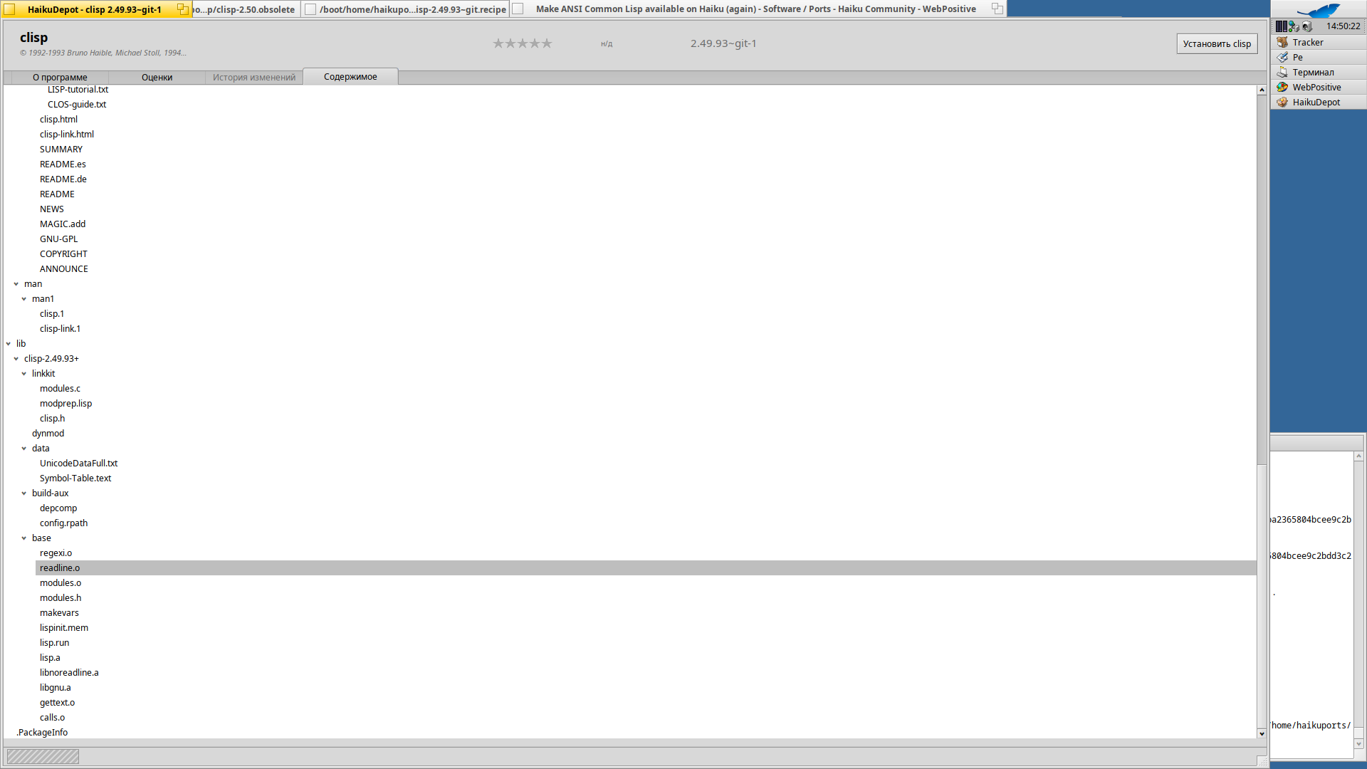

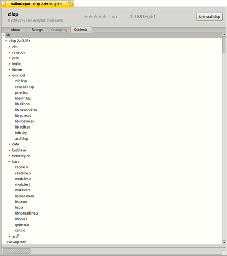

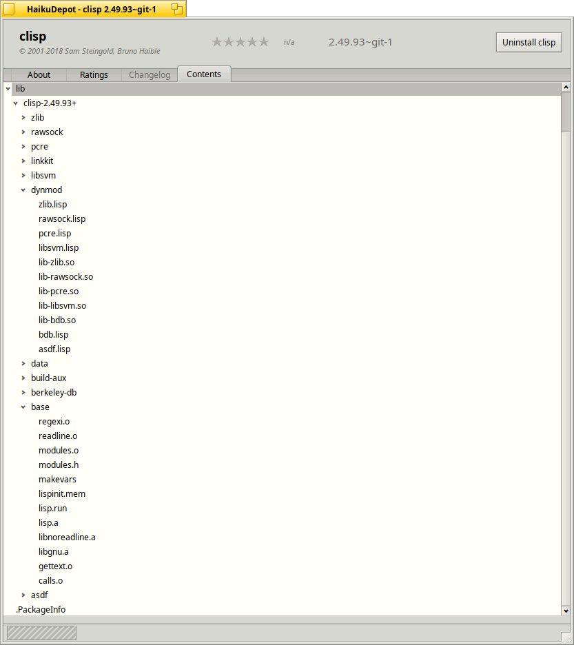

One issue with JIT compiled languages is they generate intermediary code (such as .class in Java), and Lisp, being a very dynamic language, does it quite often. Technically speaking .fas files are libraries (so $libDir is the right place), but they probably need to be placed in a writable folder. Or if they are not changed, and their .fas as well, they could be in read-only folder.
In package content I see .fas files are placed next to their .lisp sources, which is fine. This means, CLISP developers do not expect them to be changed during usage (or there is some other mechanism to overwrite them if necessary), so they are good in read-only folder. However, I see no reasons to have Makefile and .o files there. I do make distclean after make install. But if they are still there, CLISP knows why…
However, users of Lisp compilers will certainly need a write-able folder where .lisp files are translated into .fas ones. Until now, I did not see problems with it in CLISP, given I did not test it extensively. Lisp implementations usually create in user home folder some subfolder where the cache of .fas files is created in a reusable way.
Strange, I do not see the modules as in @Begasus screenshot:

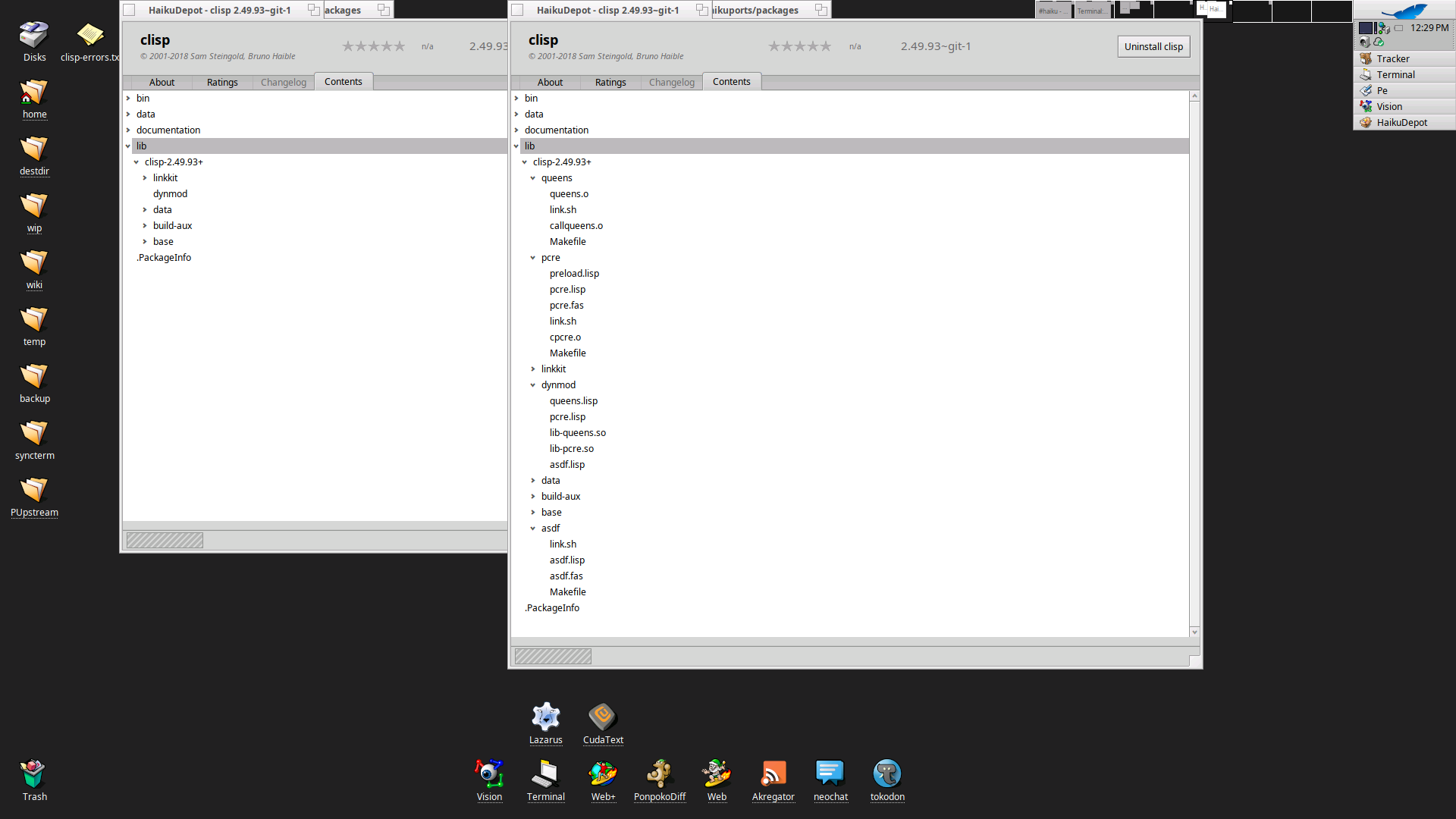

--with-module="clx/mit-clx" - Call Xlib functions from CLISP in old MIT implementation. This is probably not intended to be run on Haiku. There is a newer implementation in “clx/new-clx”, which maybe can communicate with Xlib of Haiku some day.
--with-module="oracle" - may depend on Oracle vendor specific libraries.
Yeah, on some I expect failures, but going through the list nevertheless :slight_smile:
