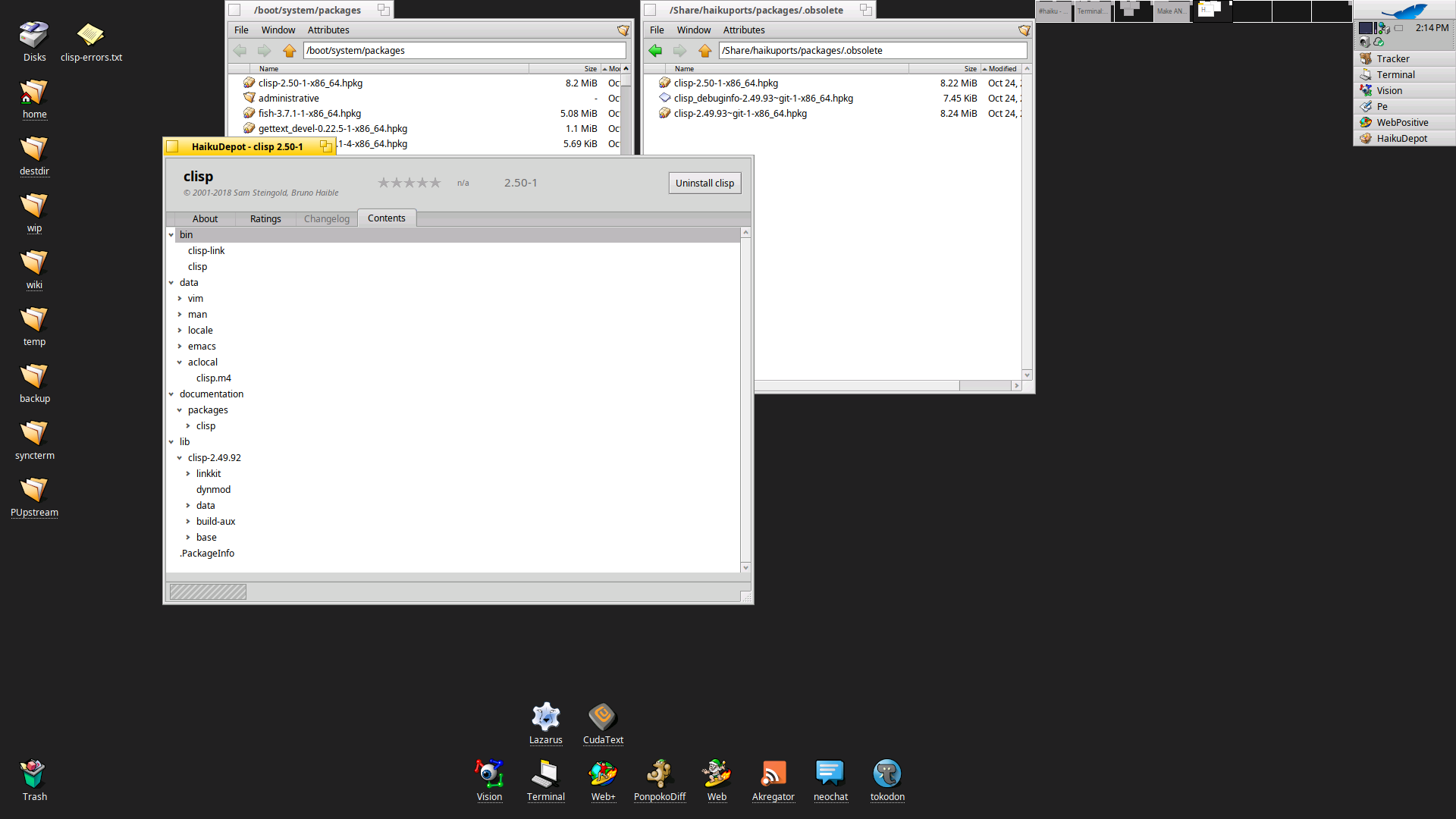

Did you see a message near the end when packaging like “POLICY WARNINGS”?
No, it seems. The last part of the log is:
creating package clisp-2.50-1-x86_64.hpkg ...
----- Package Info ----------------
header size:                     80
heap size:                  8034357
TOC size:                      4018
package attributes size:        718
total size:                 8034437
waiting for build package clisp-2.50-1 to be deactivated
cleaning chroot folder
grabbing clisp-2.50-1-x86_64.hpkg and moving it to /boot/home/haikuports/packages/clisp-2.50-1-x86_64.hpkg
OK, I now see why your required packages are different from mine: clisp-master lists different packages than clisp-2.50.
Not so much of a difference for the 2.50 package here, that’s also +8MB
I meant a bit before that :slight_smile: At the end of “install” part:
