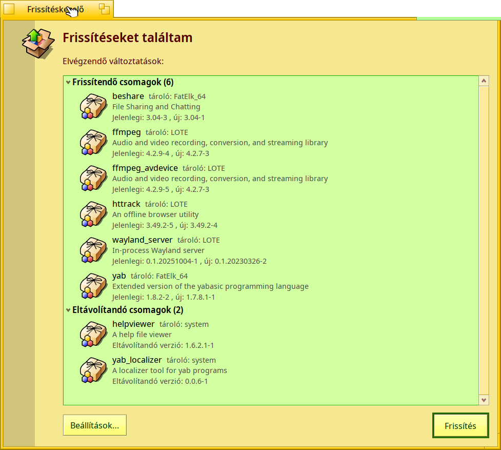

And I thought Softwareupdater might use full-sync - as that once contained many packages earlier, that were in one of resolving scenarios of conflicting packages, so it would have uninstalled on that selection
Now just simply offers downgrades →

I may complete later - I hoped in shorter process, as seemed the separated 1 deinstallations were not collected, meanwhile above to keep seamed to me to enlist the same packages - I not checked, so possibly I just felt boring to do and that way seemed so.
You know that you’re not obligated to try and update your system every so often, right?
Besides that libgpgme, the rest of the problems in your list are already know, and being worked on as we’re able. Why not wait till you see the list of known libxml2 related issues get resolved before trying to update?
More post about the same stuff is just noise, IMO.
I terribly sorry, but based on Begasus’s post I thought it means I can attempt a sync - as I interpreted so, selecting the option 2 at all conflicts are leading to a safe sync with the repo now.
Nexyt time I rather keep the attempt and the result only for me, as otherwise I did.
