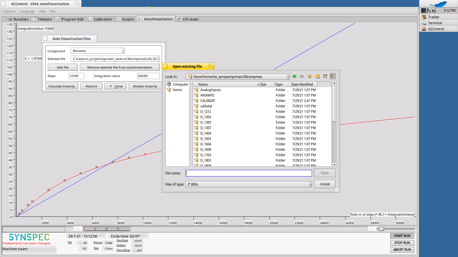

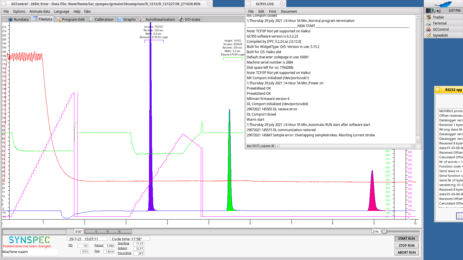

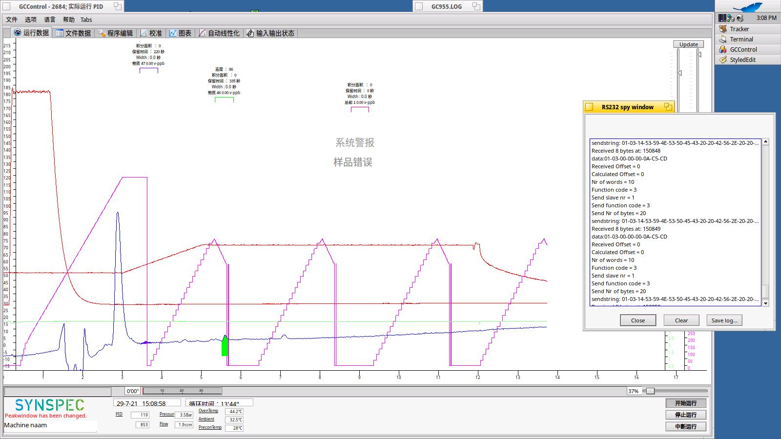

Well, although Lazarus is not really stable (for instance project properties when OKād stops execution of the IDE), I was able to nicely install all optional packages thatās needed for our software (so that recompiles the IDE every time a package is added).
Also I was able to build that software without trouble, for the first time natively on Haiku x64 for Haiku x64. The software runs quite stable, even the serial ports seems to work OK including baudrate setting (will check the termios thing though to be sure). There was one āhickupā: Haiku decided to re-arrange the order in which the USB-RS232 converters where āmappedā so I had to manually update the software config for that.
This is probably caused by the fact I just plugged them in one by one (using 2), and after reboot they were both already there. So Haiku did not bother to set the same adapters to the same port numbers.
For the IDE the font is still very spacial which is not very handy when really developing with Lazarus on Haiku.
Anyhow, I am very pleased with the results! Looking good indeed.
And of course a few screenshots:
