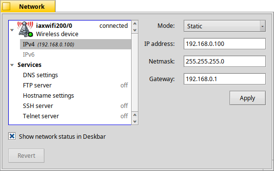

just set a static IP in the Network preferences, see attached screenshot.
Be sure to use a free IP that is not managed/reserved by your router or used by another device.

Ah I see, but a mobile hotspot is just like a wireless connection to Haiku, so it should work in the same way. You might need to configure the hotspot to assign a static IP to your MAC, though.
Update: oh no, seems this is not really possible. You need to check the IP of your hotspot and set it manually for every session, unfort. Everyhing else requires a rooted phone.
