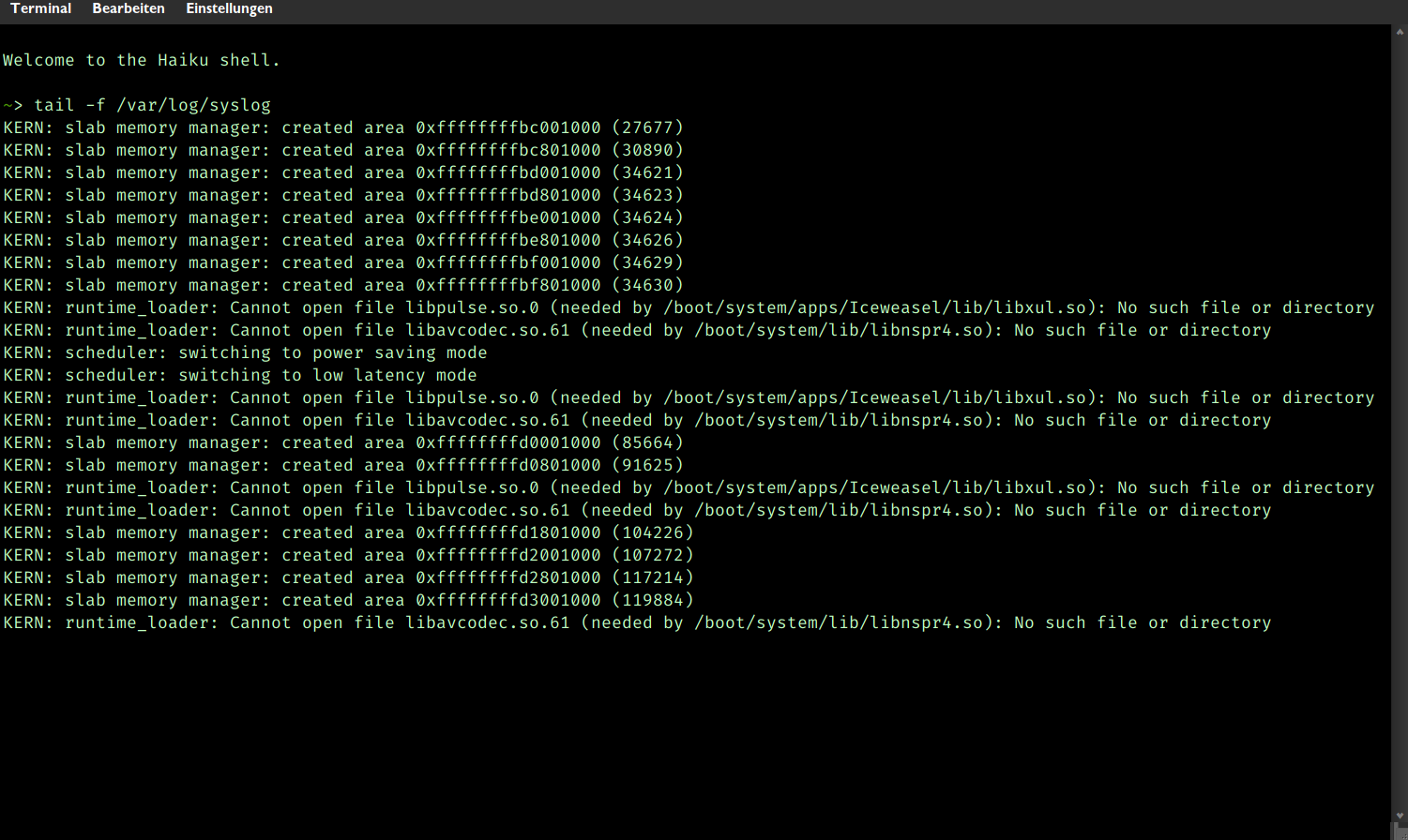

It would be handy for situations like this to have something like log_server, so dev could see OS output during run. See Console in macOS/GNUstep.
open terminal
type tail -f /var/log/syslog
There you have the output during run!
If you don’t have a working keyboard you can copy paste that command, or if you’re really desperate you can drag and drop characters from keymap preferences or character map into Terminal.
The keyboard is not working. How would that not be a bug?
Using tail -f /var/log/syslog
I cannot get this bug triggered atm!

EDIT: Plugging in an external USB-Keyboard does work!
And yes turning on power saving mode makes the laptop/notebook keyboard not respond! So looks like duplicate of #19477, hope it helps!
