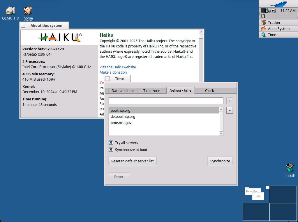

Not sure that I see the problem. Assuming you have beta5 and that your networking is up, ntp is right there in the Time Preference Try adding different servers.
It does connect fine when I do manual synchronization and at boot time, but there are cases where it loses sync like if I have the VM running but put my laptop to sleep for some time and then come back to it. It would require or manual sync each time. I assumed there is an NTP daemon to do that work ported to Haiku first. So far, my cron solution is OK, but I have to sit with it a little.

Yes, at boot time with the possibility of doing it once with the button. So you can to set time right after install or daylight saving changes and not use ntp. At least, in a virtual machine, your host is already synchronising so it shouldn’t be needed to do it.

So the network settings in the Time preferences is not intended to be used to maintain time sync, but only to sync when manually pushing the sync button or (optionally) at boot?
