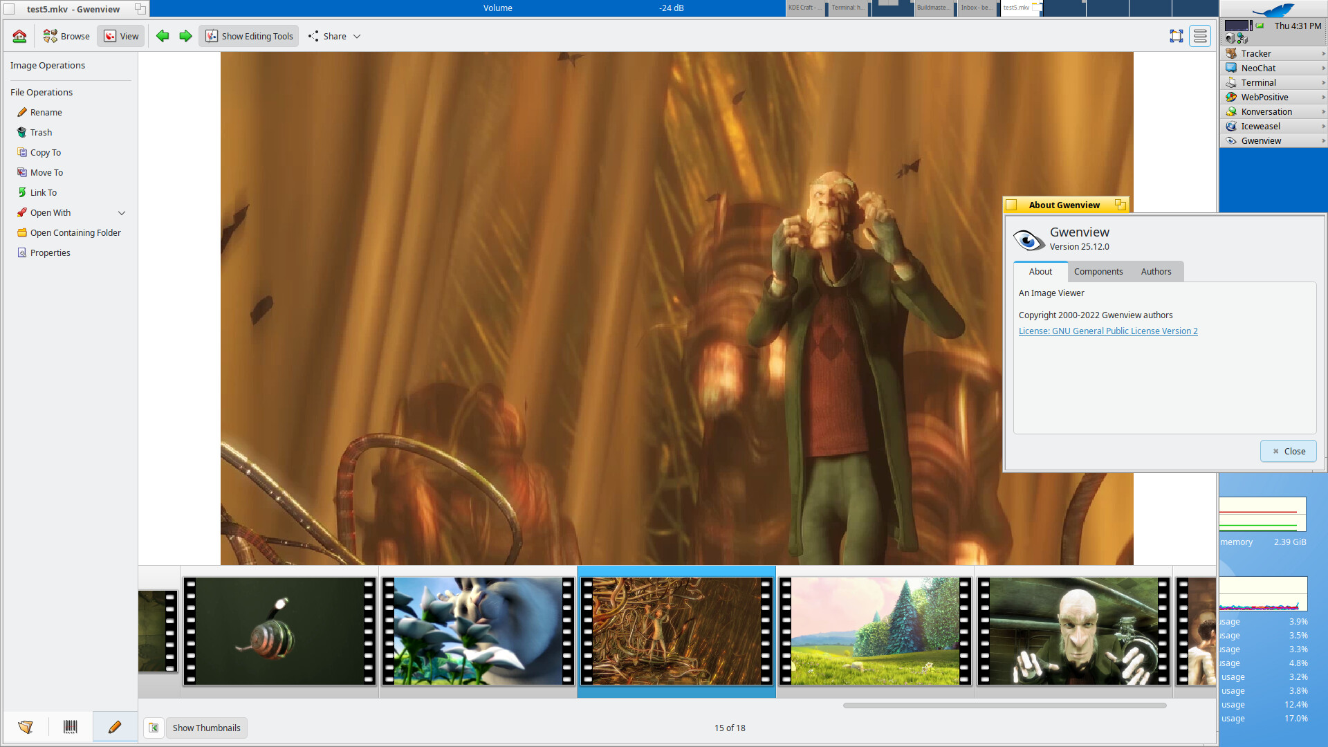

First one is Gwenview, both KF5 (needed revbump for new exiv2 package anyway) and KF6 version are build on buildmaster.
I haven’t checked new installs for those in a while, I had issues with the KF6 one earlier (KIO worker related), so had to install the KF5 one first (seems to triggered something, after that KF6 one works fine, same for a few others where there are packages for both frameworks)

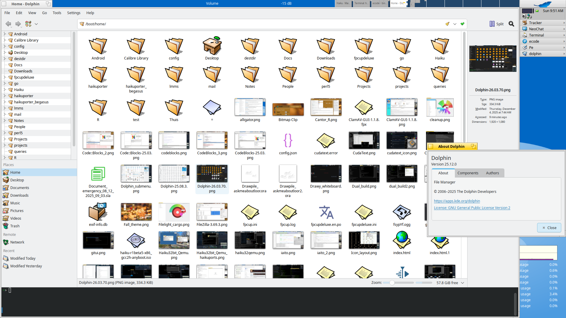

Gear 25.12

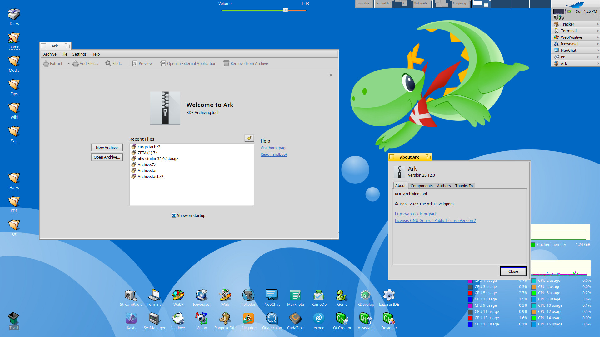

Gwenview 25.12.0
Ark 25.12.0

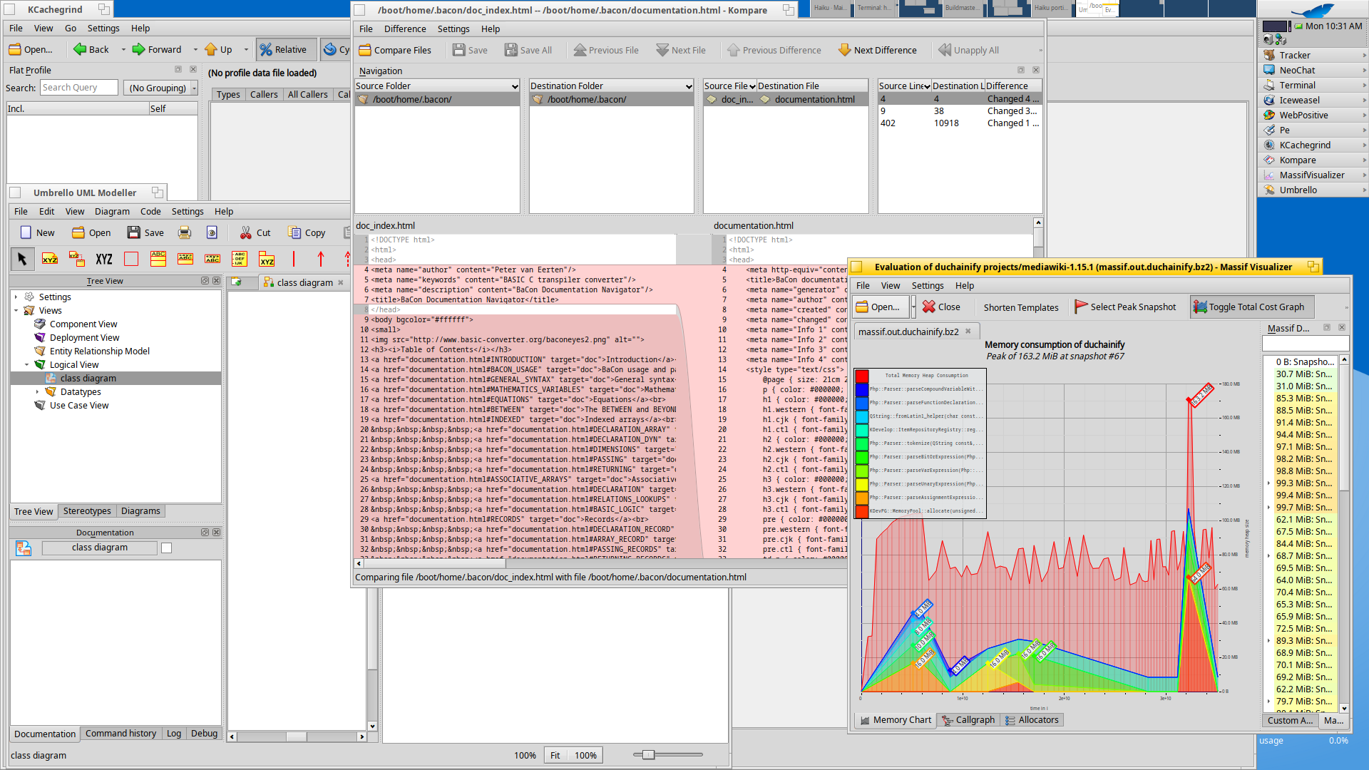

KCacheGrind, Kompare, MassifVisualizer and Umbrello 25.12.0

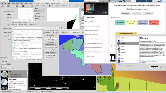

Cantor, KBruch, KGeography, Kig, Kiten, KLettres, KmPlot, Marble, Minuet and Step 25.12.0

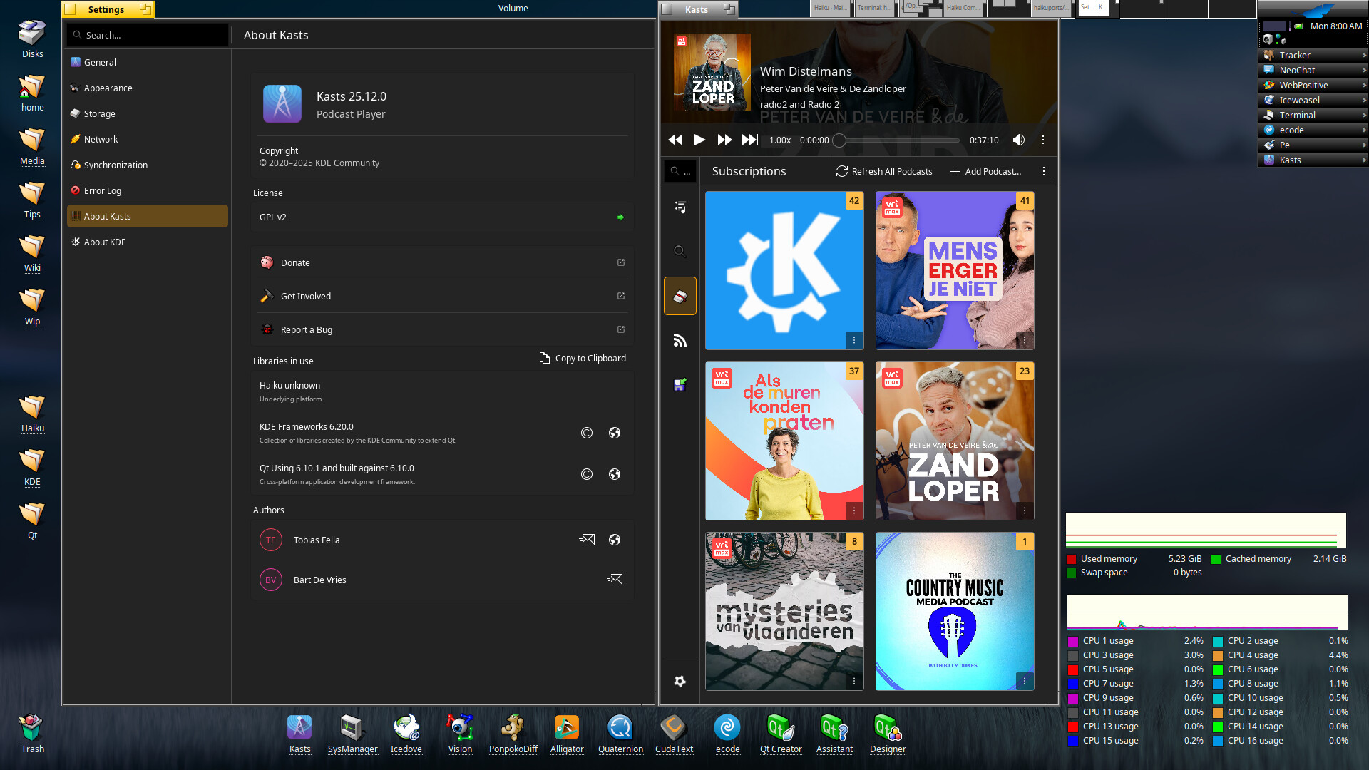

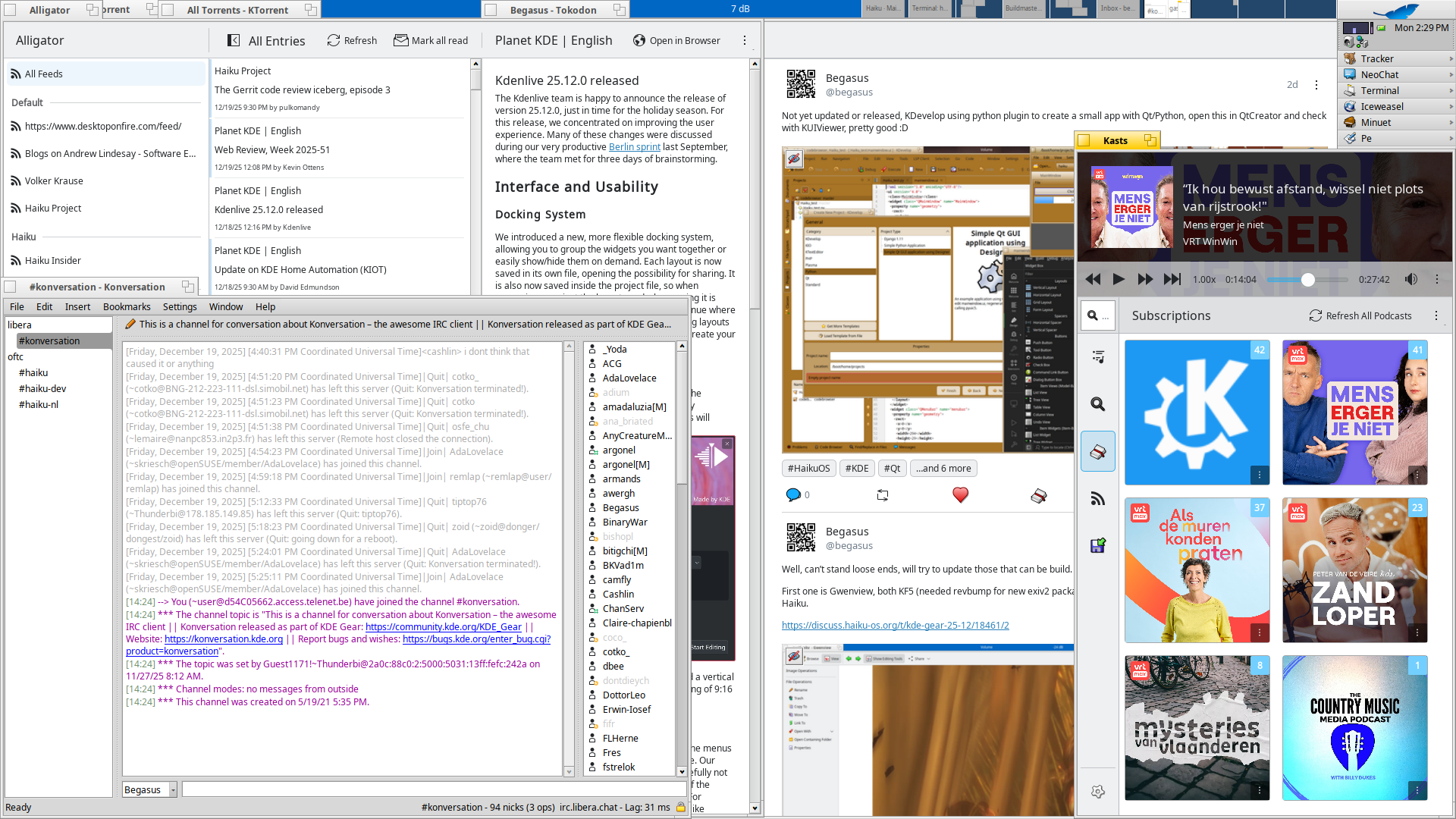

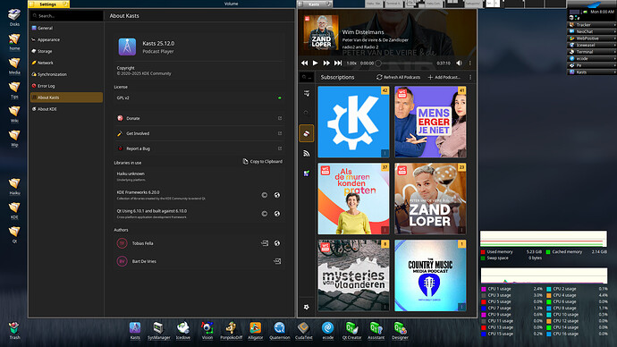

Alligator, Konversation, Tokodon, Kasts, KTorrent 25.12.0 (NeoChat 25.08.3 latest crashes)

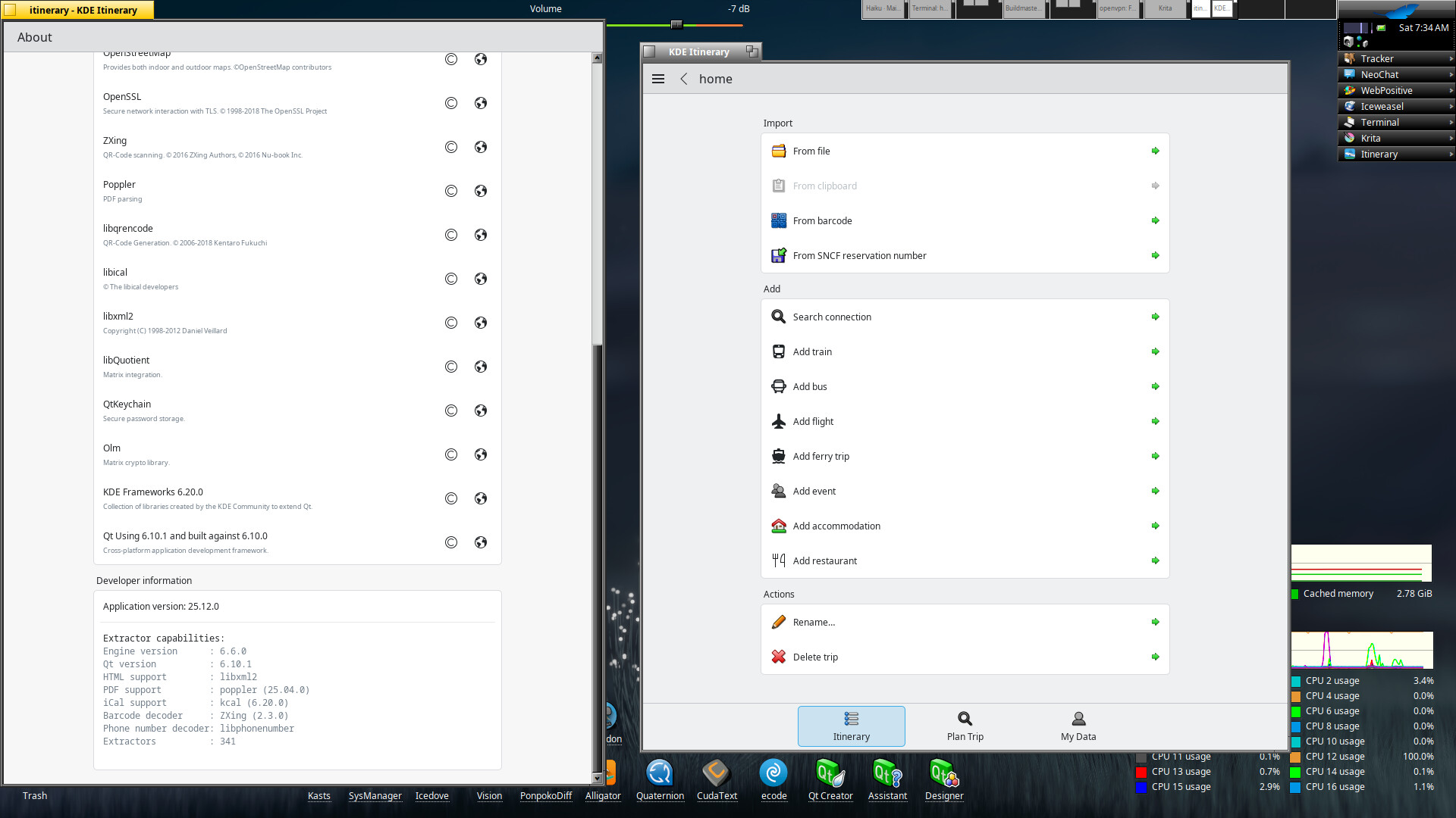

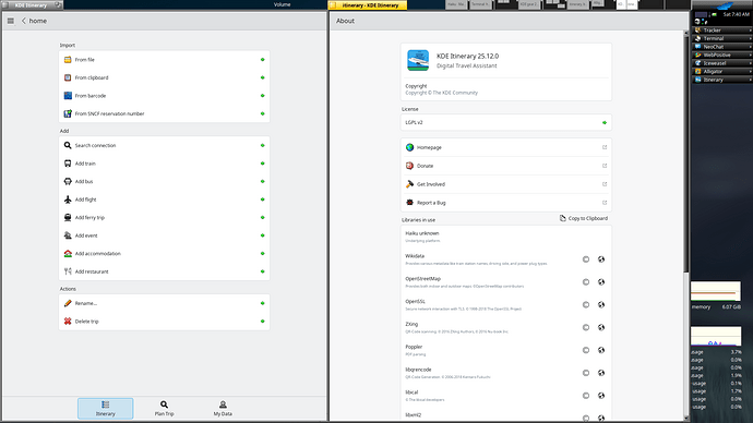

Itinerary 25.08.3 (local 25.12.0)

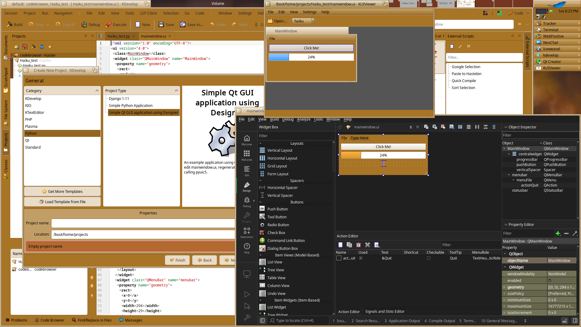

Build failure for KDevelop, updated to 25.08.3
KDevelop 25.08.3 (local 25.12.0)

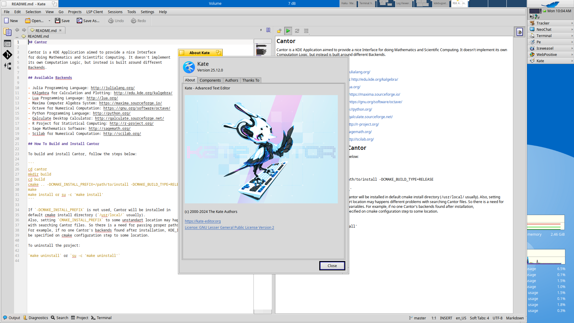

Kate 25.08.3 (local 25.12.0)

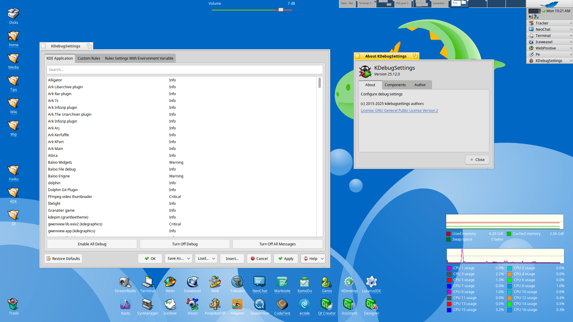

KDebugSettings 25.08.3 (local 25.12.0)
