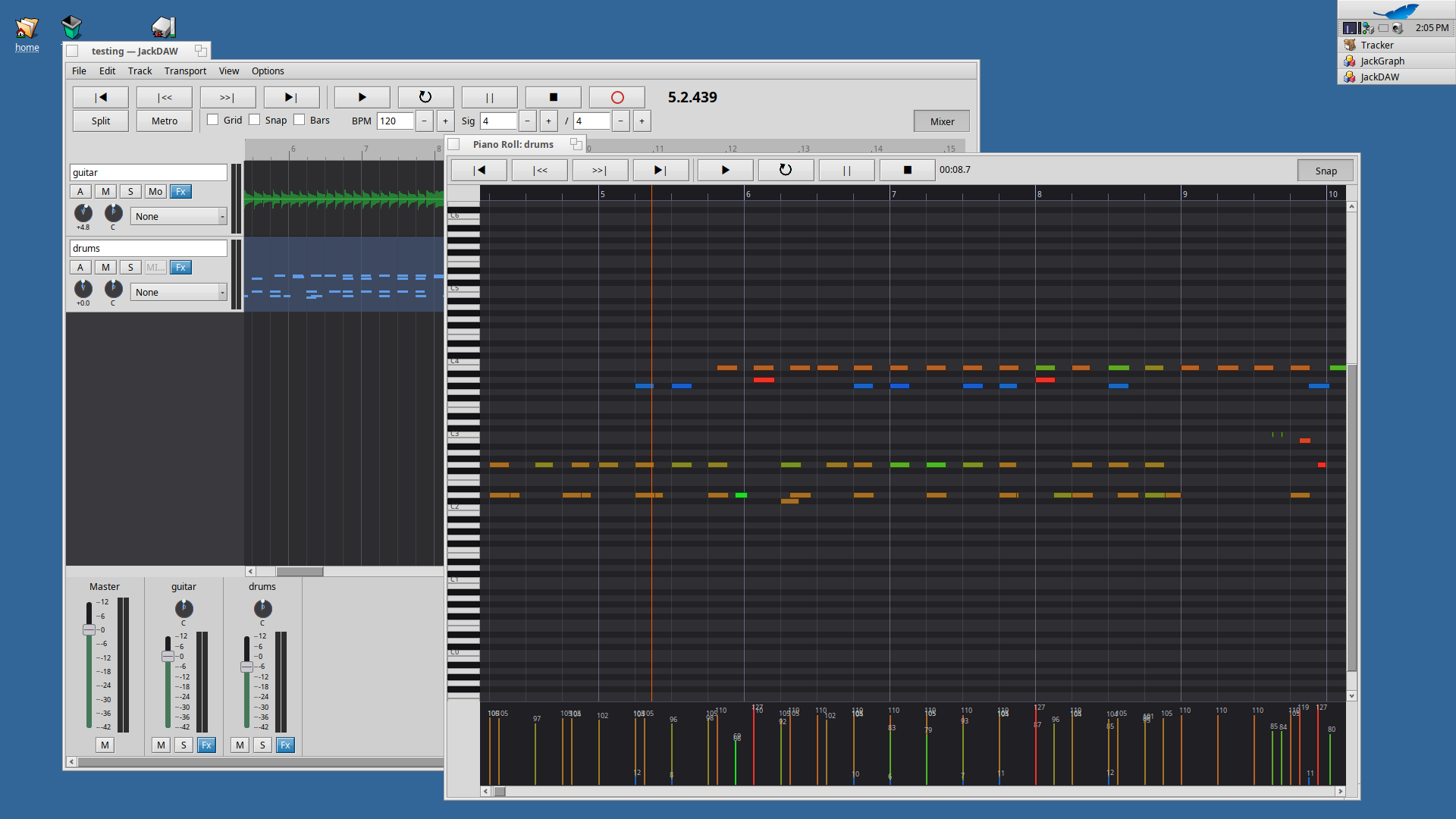

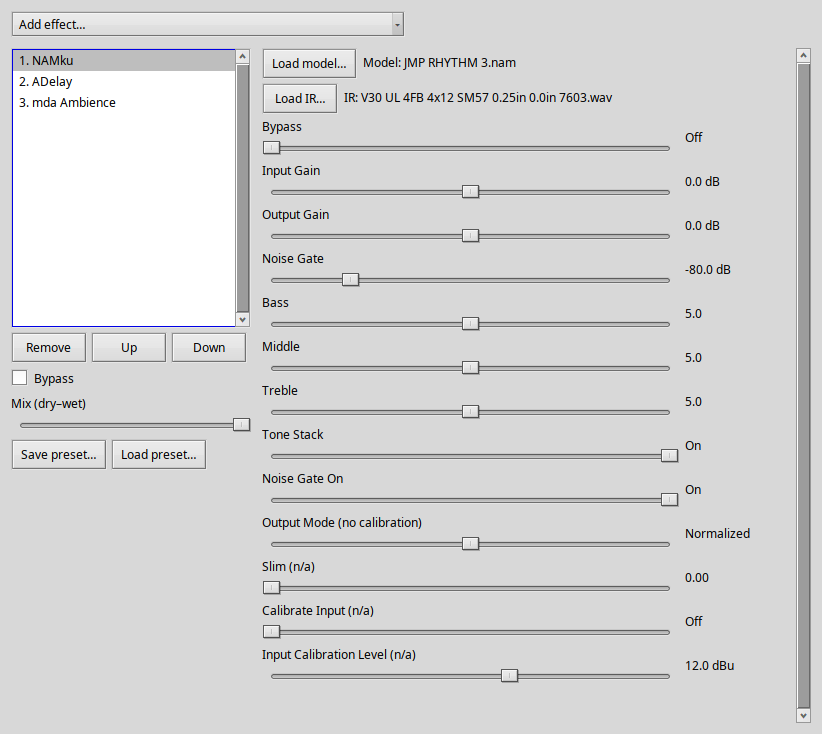

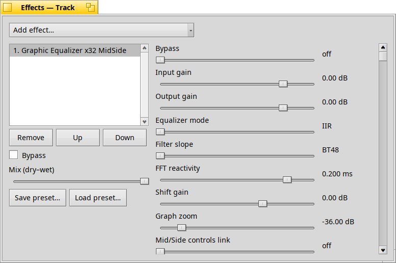

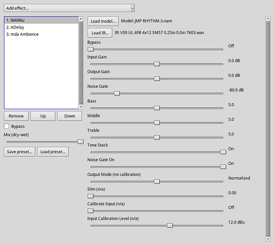

Hi, First of all I used AI. It helped me get my USB interface going by adding to the xhci driver, only enough for audio. Then I used it to port Jack2, Jack example tools, the VST3sdk and Neural amp modeler. There is no GUI for VST3 so the NAM player only uses sliders. It supports the new A2 captures.
If anybody is intrested in this stuff and would like to try, you can build from source from each repo on github or I made packages all in one place here Releases · rations/jackDAW-haiku · GitHub The main thing is to get your interface working first and that info is here haiku-kernel-usb/dist/INSTALL.md at master · rations/haiku-kernel-usb · GitHub This is all built on hrev59846
Depending on your hardware you can adjust Frames/period in Jack settings using the patchbay Jack Graph. On my laptop 256 seems to work well. The DAW does the basics, it ain’t no Reaper or Ardour

Thanks for the feedback. Yeah gui support would be great but i haven’t worked on that part of the VST3sdk yet so it just uses sliders in the fx window. I also ported LV2 an included gui support. I compiled some gx plugins but they also use sliders as their gui does not support haiku.

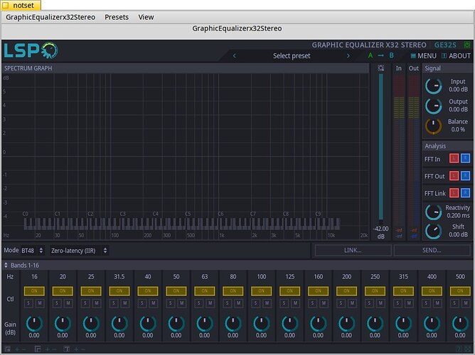

Also as information about some requirements for proper working on Haiku target, like paths, UI behaviors or lifecycle of plugin. And for concept here working VST2 plugins with native UI with VSTGUI 3.x and LSP framework (with native backend of course).
Those screenshots look great. Thanks for the offer, the code is there for all, you can do whatever you like. It uses vstgui4. I’m more of a fan of LV2 and for now I am working with that.

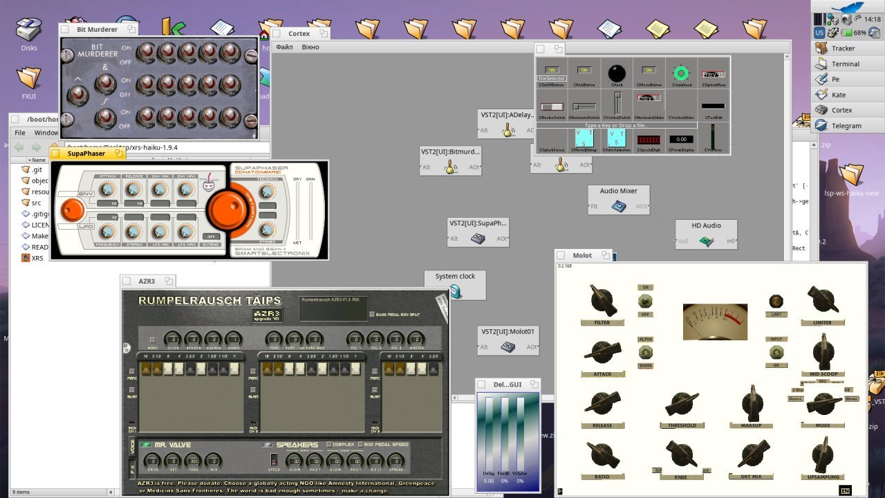

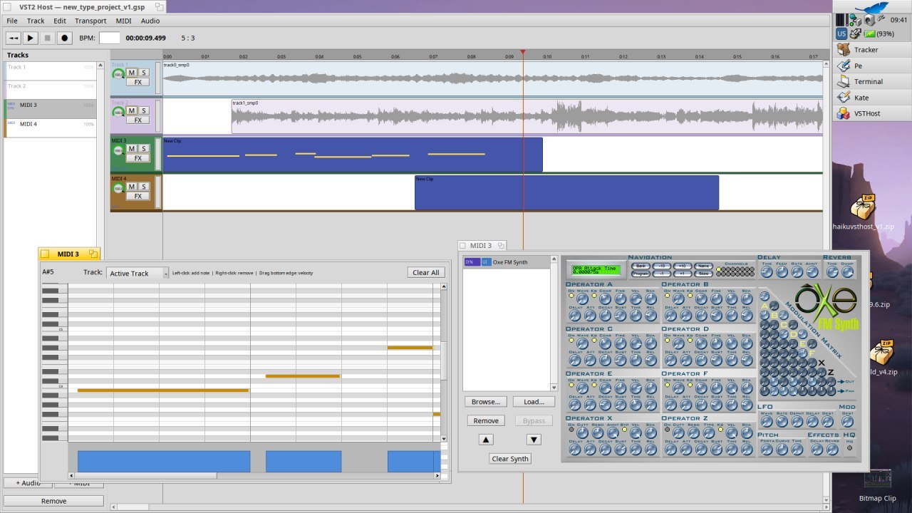

Already in Haiku base system vst_host.media_addon, clean room reverse engineered host for wrap plugins as media add-ons for MediaKit, and XRS, software for creating loops. UI by default supported only in XRS (with some limitations, cause some things need to be debugged and fixed, like properly close of all plugin instances after exit), patches for host add-on need to be refactroed, cause some architecture problems like how correctly close window and surface after node release, separate synths/instruments and effects and some other smaller things.

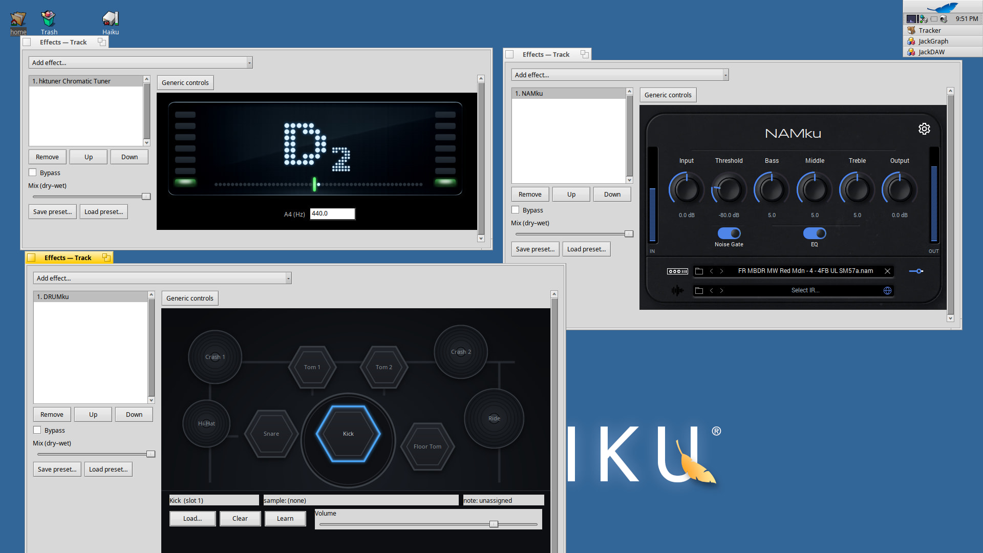

I added GUI support for LV2 and VST3. VST3 uses IPlugView. It is documented in HAIKUGUI.txt in the repo. Added the gui to NAMku and made a basic GUI for DRUMku. hktuner is a plugin made using LV2

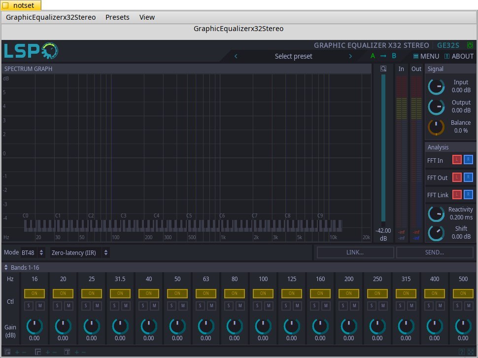

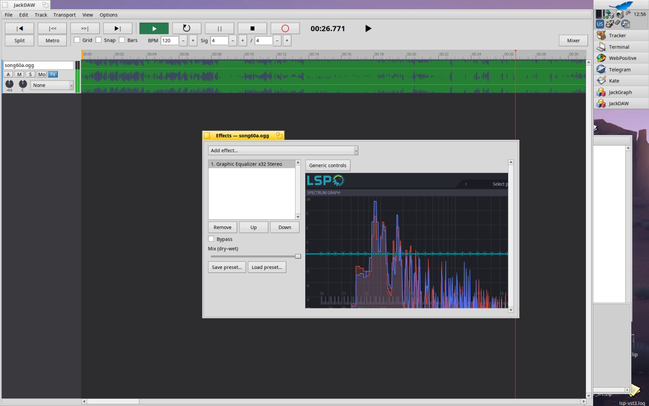

Did you build package with that version for testing purposes? I tried to build my port of LSP plugins in VST3 format (they did not use official SDK and all things reimplement in their own code) and it works good without any errors while I add plugin to track
I build jackdaw against my Haiku port VST3-haiku, but that’s only for the host side. It doesn’t require anything from the plugins. So any plugin that implements it correctly will load, whether or not it uses the official sdk. Thanks for testing.
VST2 version works with small issues but mostly correctly (hint 1: layout need to be done after resize of plugin frame by itself, hint 2: canonical path for VST2 plugins in haiku is only add-ons/media/vstplugins, for other formats (for example ~/config/non-packaged/add-ons/media/(VST3/CLAP/LV2)) they need to be placed also in media sub directories, as canonical path, and unlike *NIX’es we did not using .folder-name, for that purposes we have ~/config hierarchy. Hint 3: in BeOS VSTPluginMain is not only the symbol for main entry point, we also had same symbol and its default - main_plugin). Also you can done test with mda plugins package from repository and using layout form that package.
Forgot yet another thing to hint, VST2 plugins not usually had .so extension, generic BeOS era plugins usually does not have any extension, so helper need to be tuned for correctly work in that cases

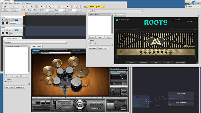

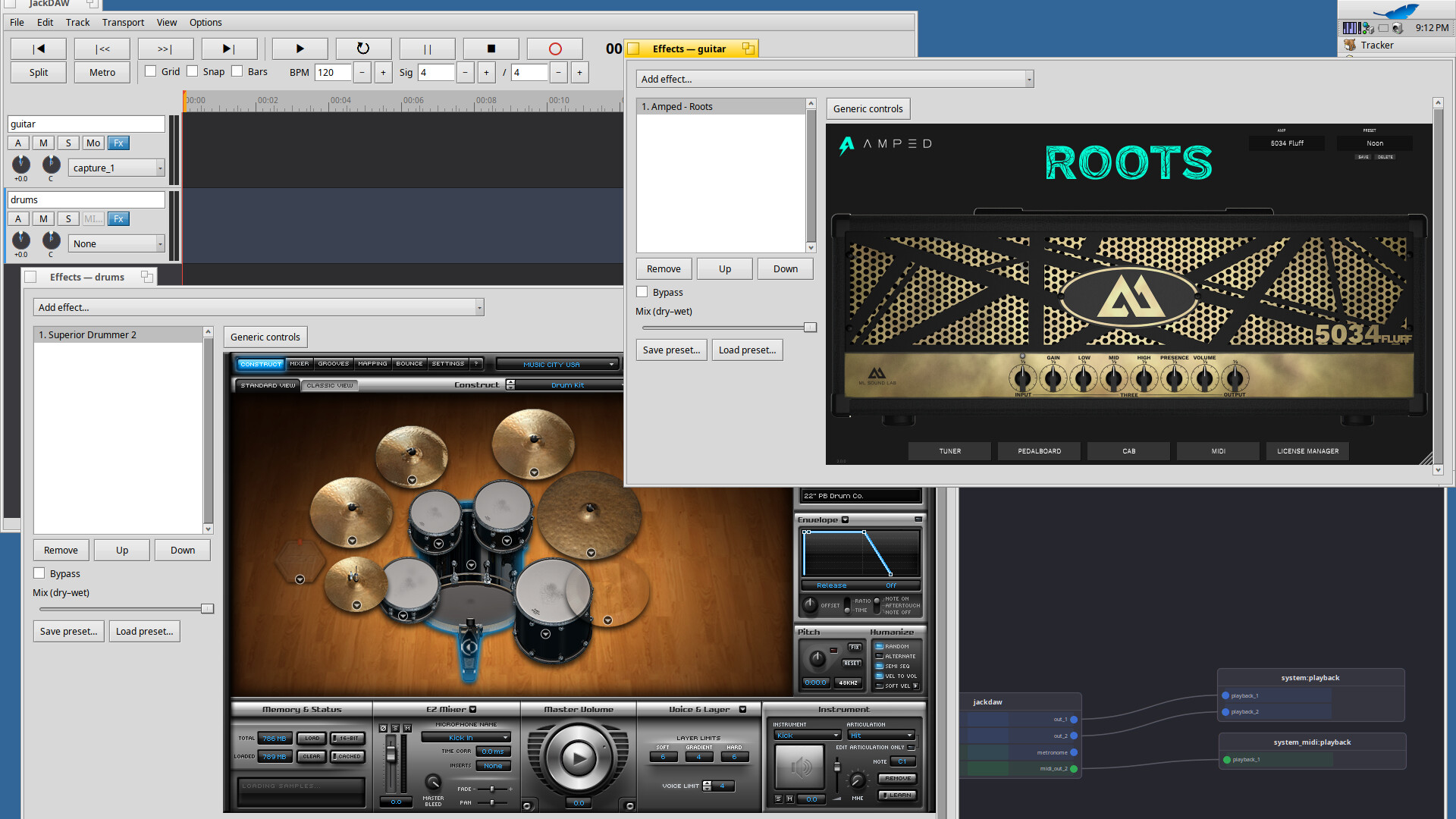

Thanks for the tips. I’ll look into them. I added some patches to wine and got some of my windows plugins working. Superior drummer is vst2 and Amped-Roots is vst3
I’ve been updating these packages. Using wine 11.19, got ilok and Neural DSP working.
