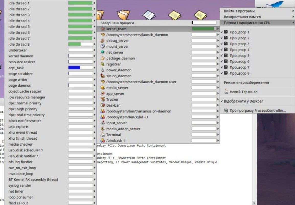

Increased processor load with kernel team at ACPI task on hrev59759
After update I had performance issue with ~50% one core CPU load in idle, so I checked what task increase load, and I think it’s issue happened after acpi: Always read EC_DATA after burst enable command · haiku/haiku@588830e · GitHub

For more full report my hardware setup is Lenovo Thinkpad T14 gen 1 with 10th gen Intel core i5

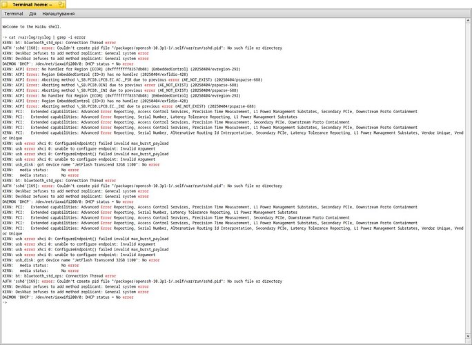

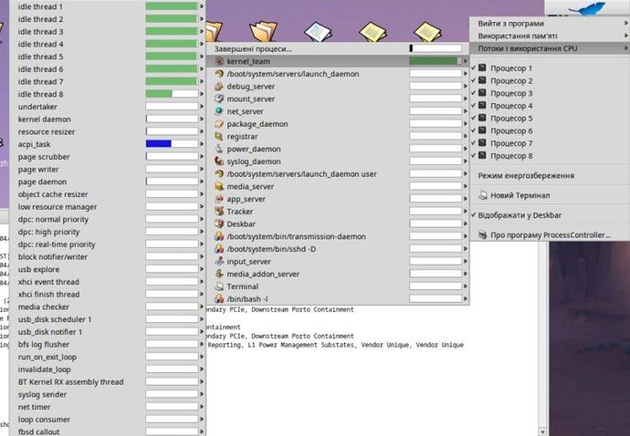

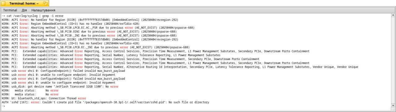

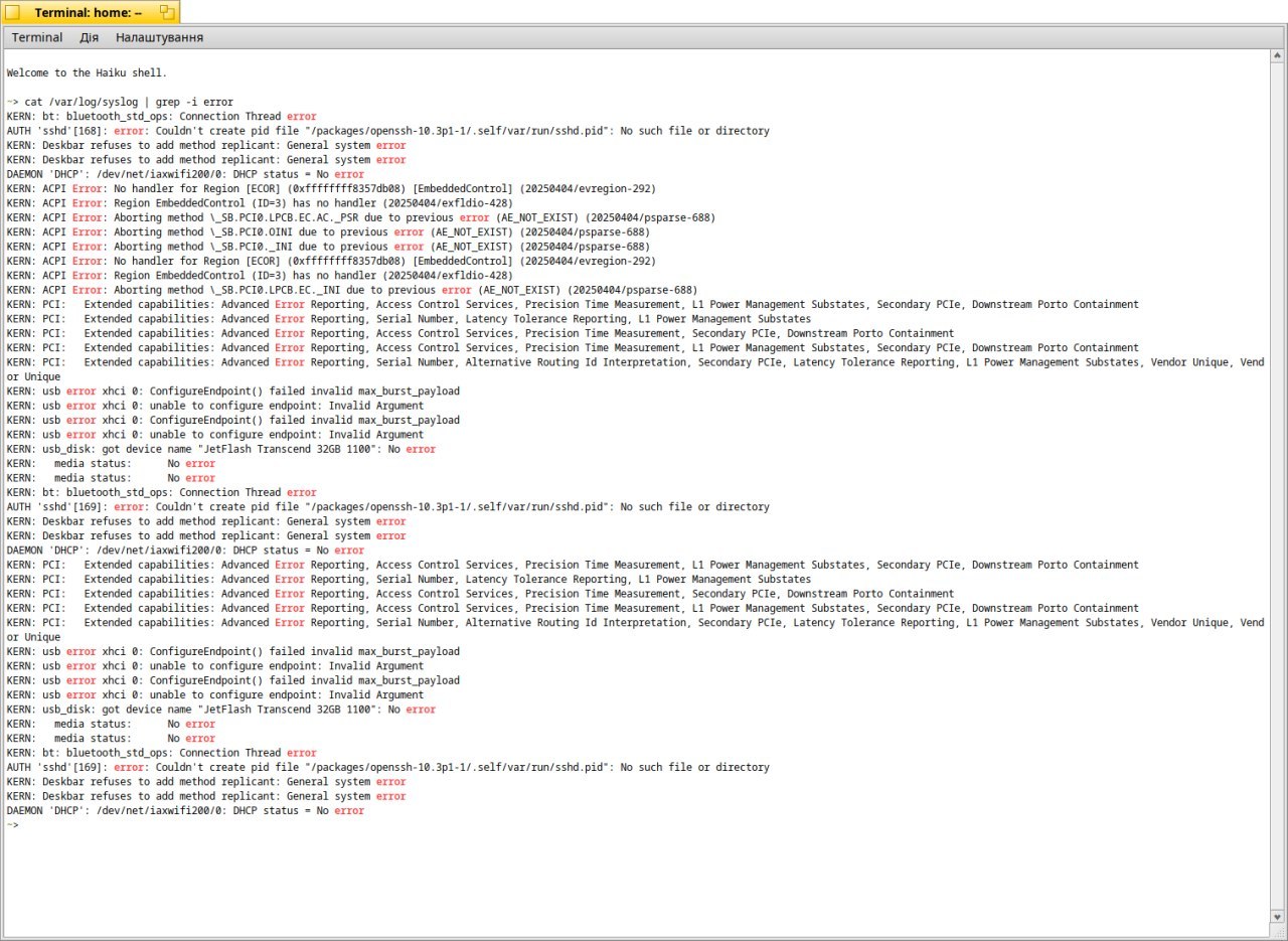

Unfortunately issue still exist, I update my system to hrev59772, and still have same output in syslog and same acpi_task with high CPU load. I can provide more information for analysis if that helps to fix that
