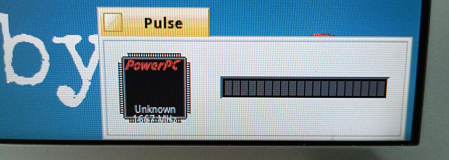

I have made some progress on the PowerPC port
I’ll see if I can try my MDD G4 and my G5 in the next few days.

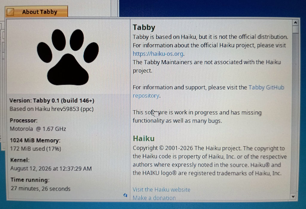

First time posting here — thanks so much for the work on Tabby, it’s great to see PPC getting this kind of attention. Wanted to share a test report in case it’s useful.
Tested on a PowerBook G4 12" (PowerBook6,2, BootROM 4.7.5f1), Tabby hrev59853+146+dirty.
USB-booted the installer fine (needed probe-all before OF would see the stick, and a single backslash in the boot path rather than \\). Install to internal HDD completed cleanly, 347/347 packages.

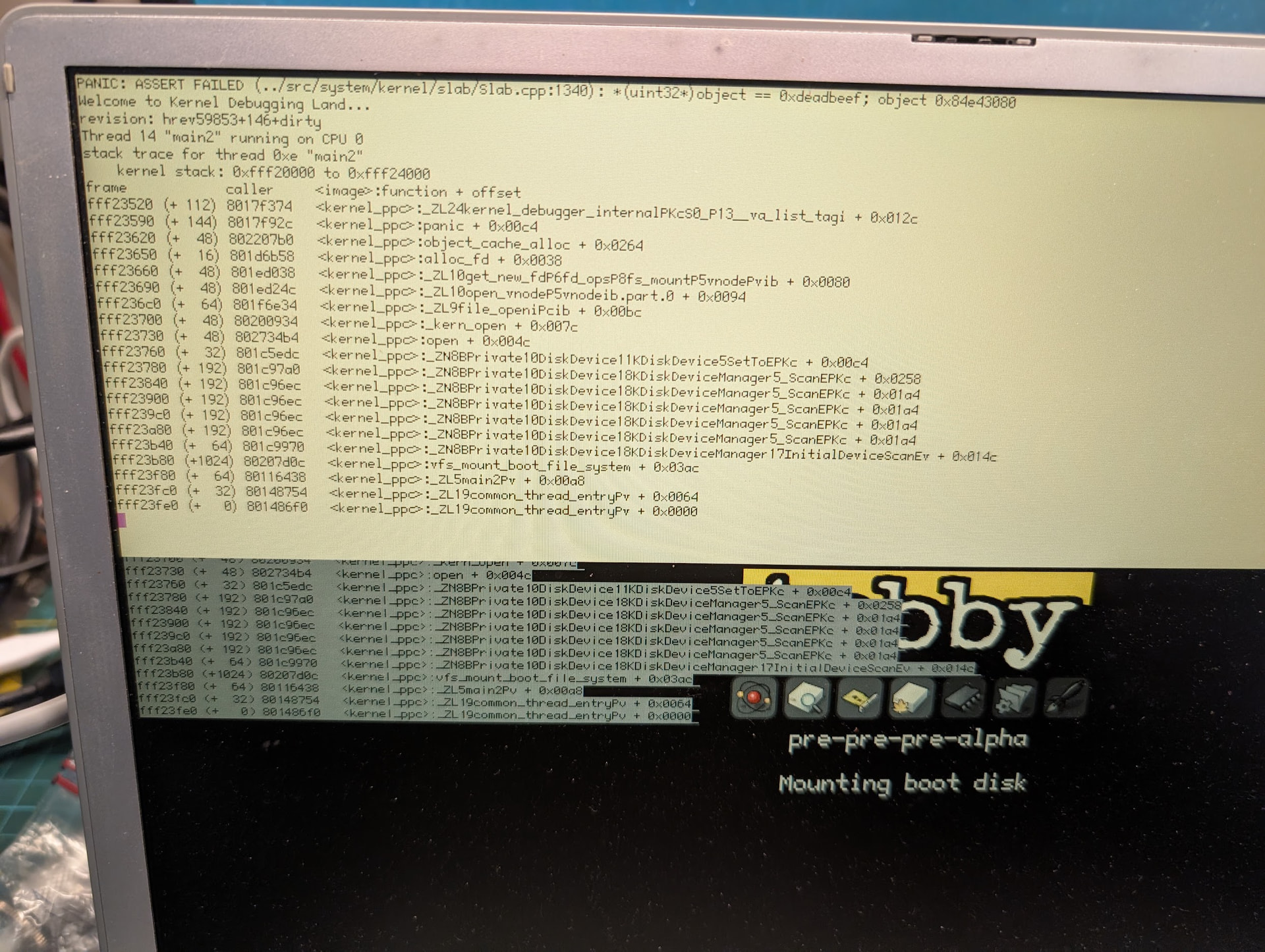

I tried it on my A1046 G4 PowerBook5,2 (sic) with no luck — it dumps into KDL while trying to mount the root filesystem; screenshot below. The good news is that it behaves identically booting from either USB or CD (I was too chicken to try it on the real hard drive).

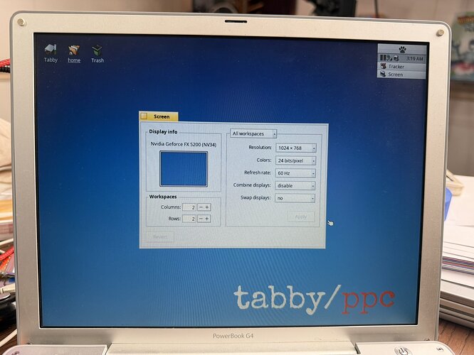

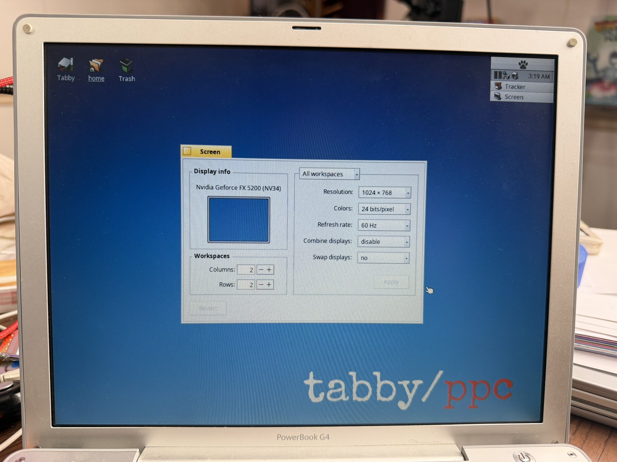

But mine is missing the Trackpad-Support and has a ATI Radeon 9700 not a Nvidia 5200 like the 12" models which get a real GFX driver in tabby

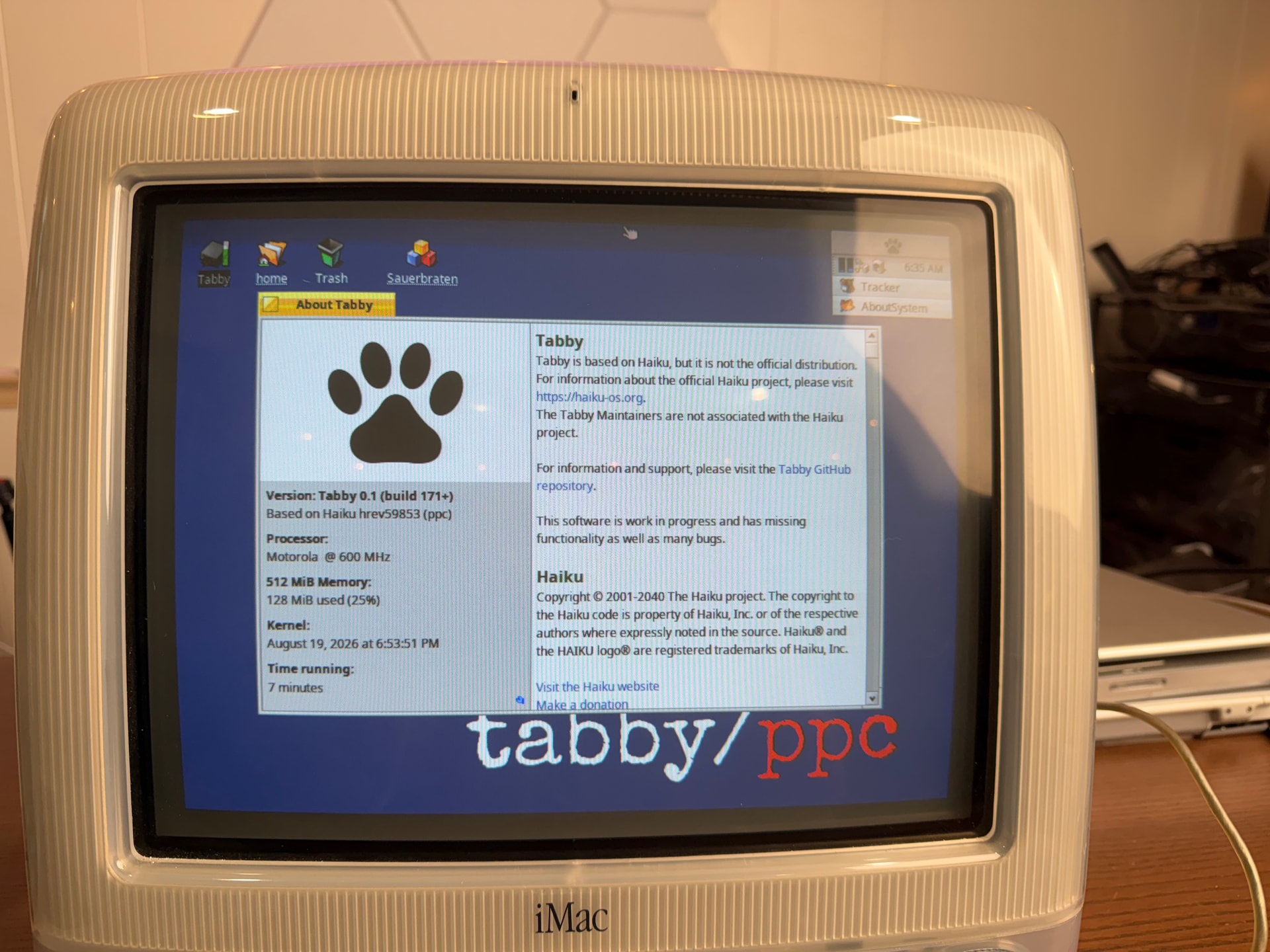

600mhz iMac G3
the Flower Power units will be back ! :slight_smile:

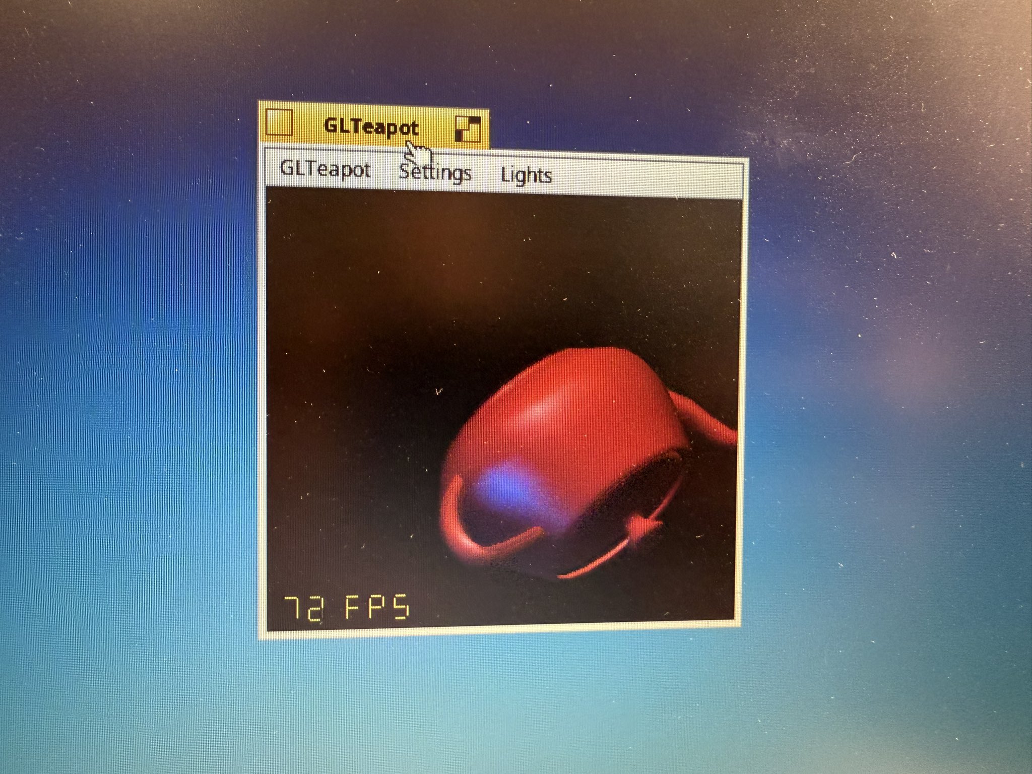

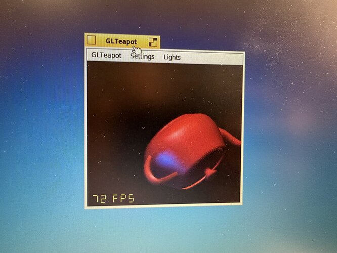

Would like to know how well it runs on that thing. Like how’s the performance? Also I see Sauerbraten installed, how well does that run? Also, how’s the G5 progress going?
