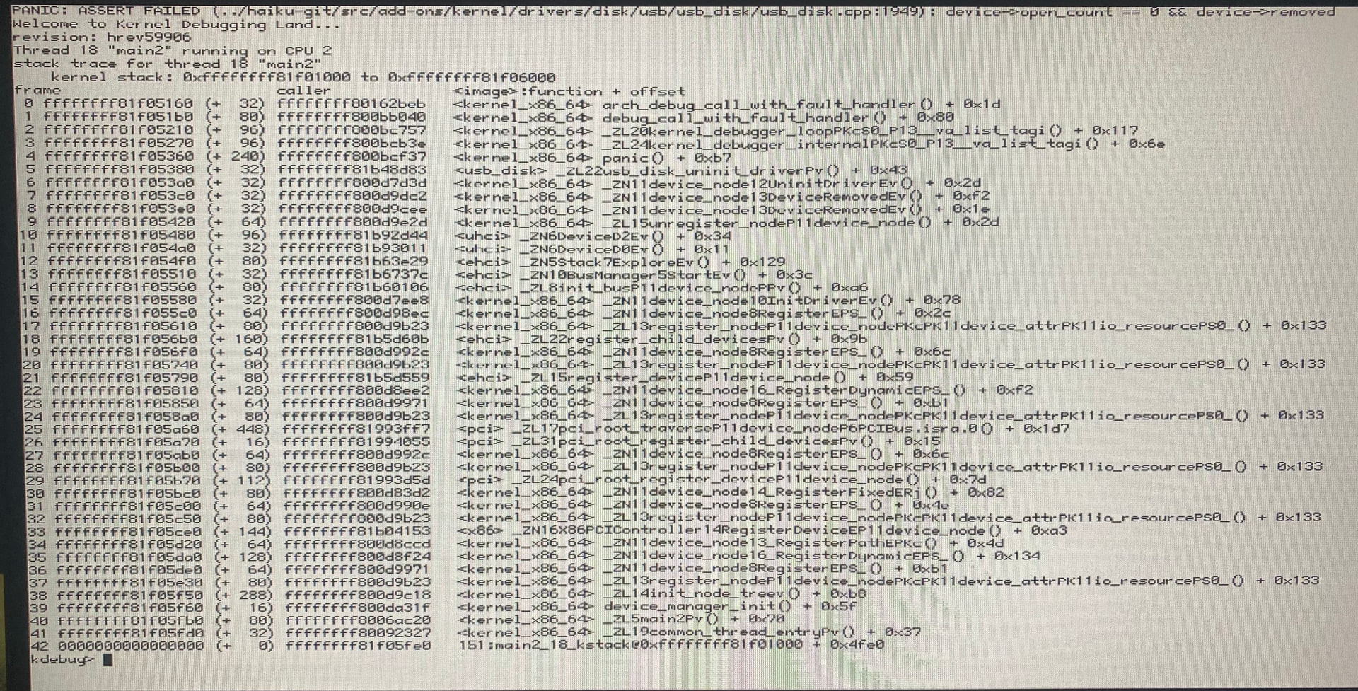

I have the same or similar issue on a 2012 MacBook Air. Since it is an experimental laptop for me I reinstalled the latest nightly to the same issue. Looks to me like a possible USB or a device issue but I didn’t have time to probe real deep. I did notice some USB WiFi dongle code changed recently and I use one. I am on the road till the 13th and I will play again. Hopefully issue is resolved by then if not I will look deeper to see what is amiss.

Thread x “main2” running on CPU x error has been occurring for me since hrev59917.

hrev59917 - Crashes after 3rd (add in board) icon with the error listed here in this thread. So first thing I did was a full reinstallation just to be sure it wasn’t something I was doing…
but it wouldn’t boot past 3rd icon again. So I:
  1. Boot in safe mode - disable ACPI in settings/kernel/drivers config file - reboot and all is ok.

When I rebooted my Haiku box the next morning, the error came back… so I:

Then this morning I booted my hrev59921 and again the error reappered, forcing me to disable ACPI in the config file again.
I think I might be misunderstanding the boot process.. Doing a reboot from the haiku menu seems to trigger a different set of results than from powering down and rebooting fully.
Since it is now 100% repeatable and I know how to trigger the error, I want to file a ticket but which log files should I include? Any help appreciated.
That screenshot does indeed look more to be like an issue with the usb_disk driver.
It would definitely be worth opening a ticket at Trac (https://dev.haiku-os.org) and attaching that screenshot of the KDL. It sounds like @GraXXoR 's issue is different to @qionm549 's issue but still worth doing the same, opening a ticket and attaching the screenshot and steps to reproduce.

waddlesplash already asked you to open a ticket, please do that instead of writing about the issue again in another topic :slight_smile:
(but yes, there is a difference between the “reboot” operating and a shutdown with subsequent new power-on)
