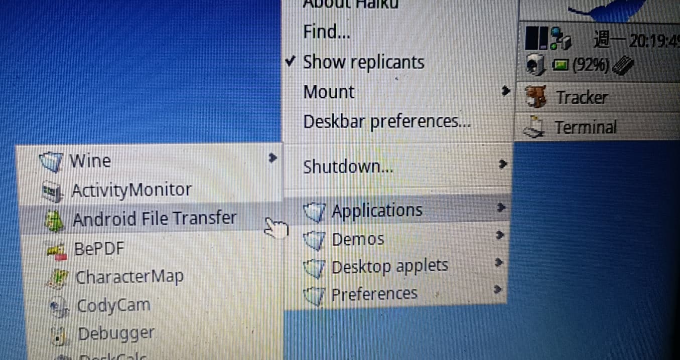

Your screenshot is very unhelpful to investigate the crash.
If you can share a debug report from the crash, maybe I can investigate.
ok, upgrade the system to the current status, and then well done.
but ,
it is too hard with my cpu.
and there is no changing at the dialog box in all time. so, i.don’t know the real progress.
i think it should be connected before launching the software with my phone.that’s why crash.
how strange the application “android file transter” can read one android12 phone ,but not the other one . so, is it about the model of phone , even built by the same company ?
(this is OK.)
