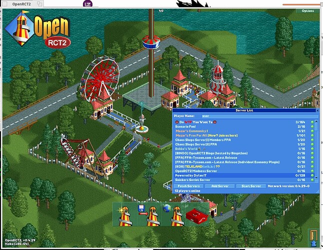

As some of you may know/remember, in the last few months I’ve been trying on and off to port OpenRCT2, an engine capable of running Rollercoaster Tycoon 1 & 2 on modern OSes.
The port compiles and runs beautifully on 64bit Haiku on just software rendering.
