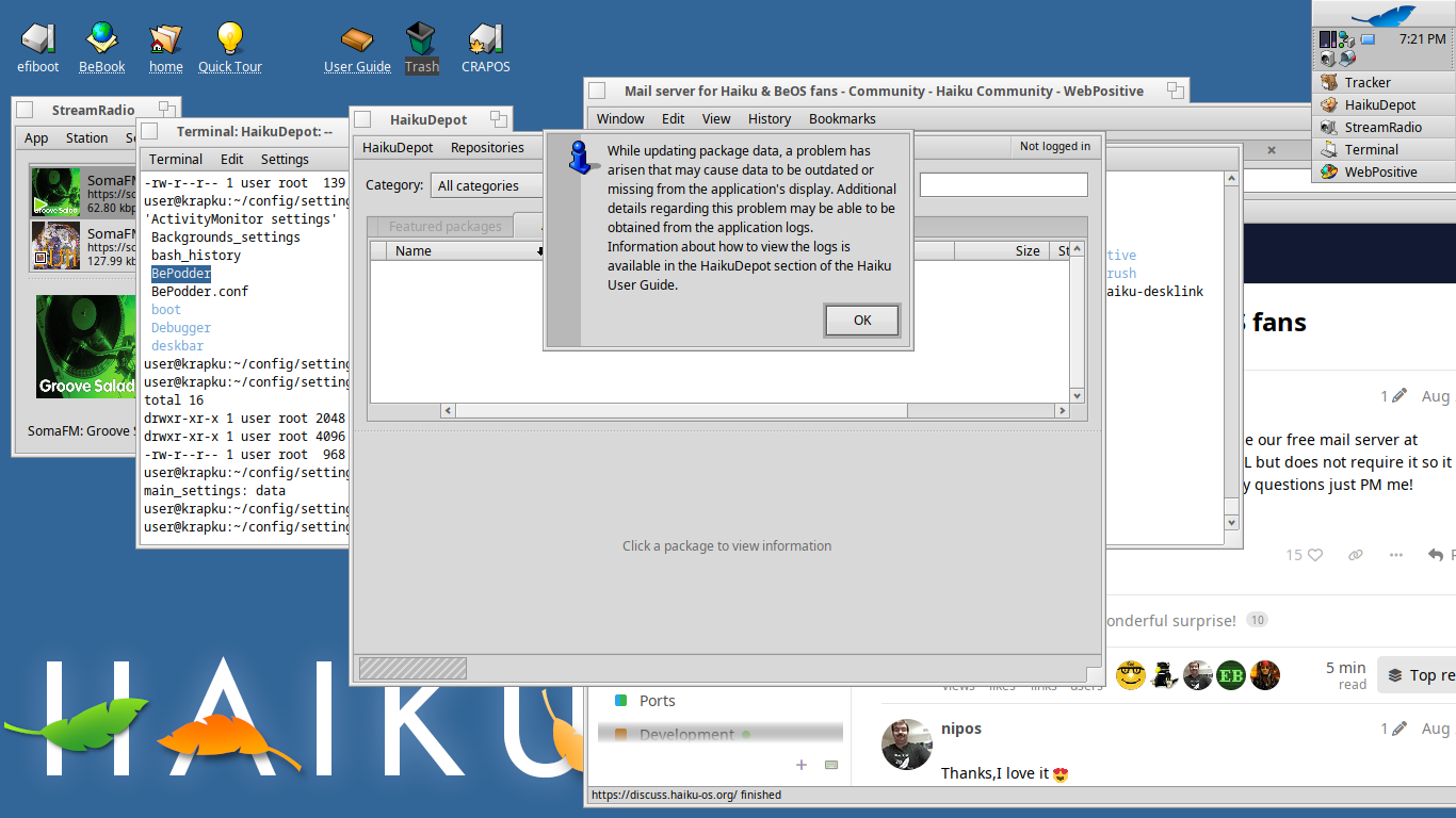

Hello.
Have a problem today with HaikuDepot. Am attaching a screenshot of the error. I did create an account and perhaps it was after that when the error appeared. I logged off and the error is the same. Also deleted the settings for the app in config but that did not work. Thanks in advance.

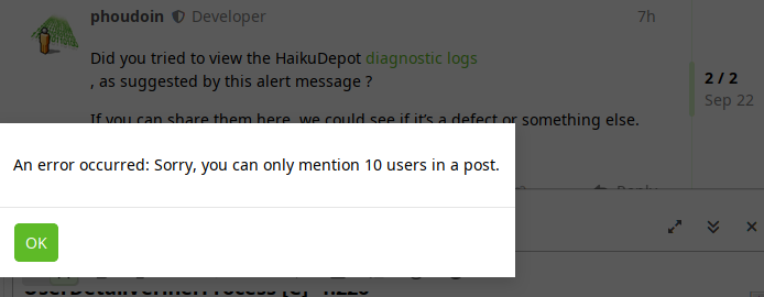

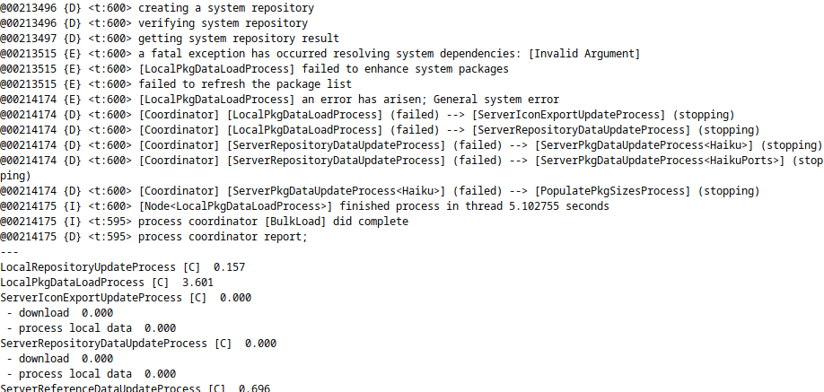

Did run the app from the terminal with the -v option. Can’t post it here within the message because I get this when trying to reply:

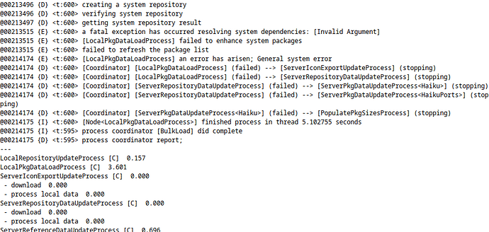

Best I can do is an image of the error in the output
ah, yes, discourse saw many @xxxx on multiple lines, and though you were trying to spam with too many user mentions :wink:

Hello @kilomike ; Thanks for raising the issue. I assume you no longer have the environment where the problem was happening? :thinking:
It looks like something has gone wrong with the package solver. I can see where it is happening in the code but it’s not clear why. It would have been good to try the pkgman on the command line to see if it also encountered an issue and/or had any other logging.
