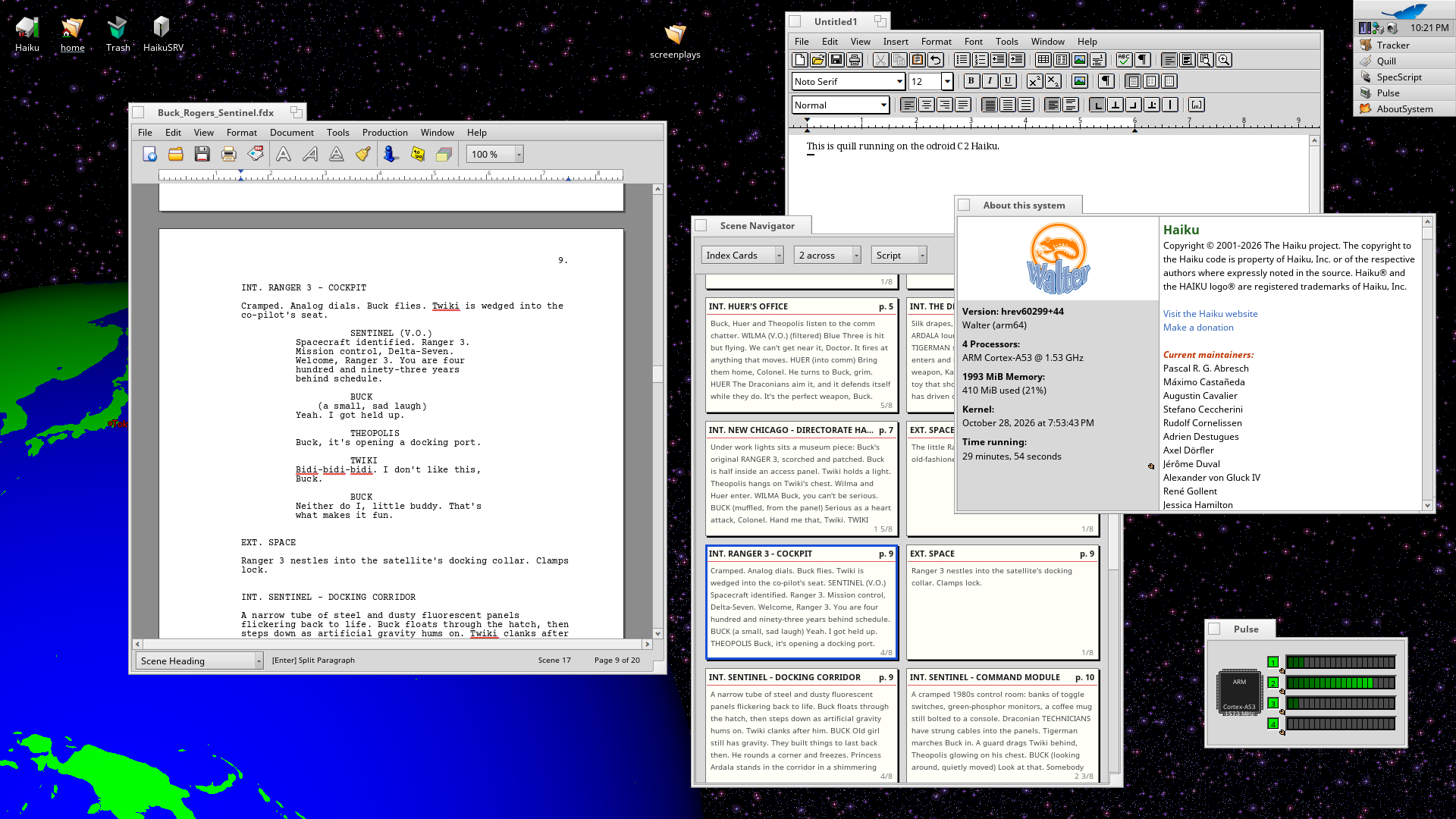

This shows my vibe coded screenplay app called “SpecScript” as well as claude’s port of xearth and the Microsoft Word 5.1a clone “Quill”.

I had Claude change the name to “ZeOS” for this Haiku “Distribution” mainly so I could tell the difference between it and my other Haiku machines. “ZEOS” was my old 386 that became a Pentium that ran R5 at some point.

I have no intention of forking or distributing this build as is, I will upload Claude’s patches and maybe a disk image to my github once i’m done but I will remove any custom logos I have added and make sure it is fully labeled as AI modified. This is purely a hobby project and I am not a programmer :sweat_smile:
if you do make a disc image then you have to change the logo. tabby/ppc has done the same
I’m following what GitHub - haiku-pi/haiku-rpi: Haiku on the Raspberry Pi 4 — coordination: scripts, tools, docs, manifests · GitHub is doing which uses the dev source and still has the “Walter” logo from the dev source so technically it’s not the Haiku logo anyway… If I’m going to be hassled for a hobby project then I just won’t distribute a disk image.
Looking at the screenshot you posted here 3 days ago, you have already changed the logo, so there is no trademark violation.
You are just fine, so please don’t let unwarranted comments stop you from distributing your much appreciated work.
my bad, was not aware
