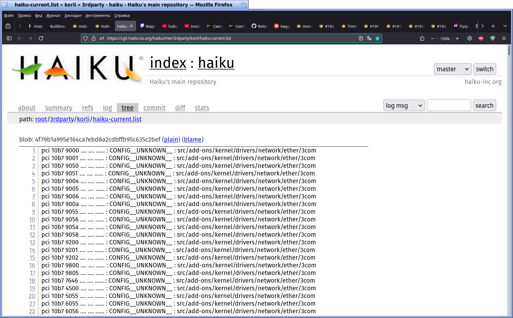

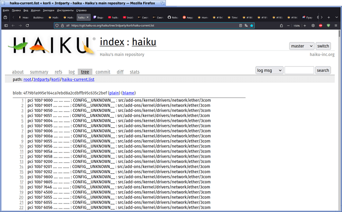

https://cgit.haiku-os.org/haiku/tree/3rdparty/korli/haiku-current.list
  • supported devices (pci and usb)
That results in a 404?

When it doesn’t give me a 404, this is the only thing I see using the supported devices -link.
