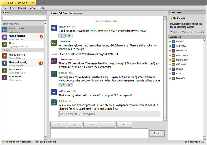

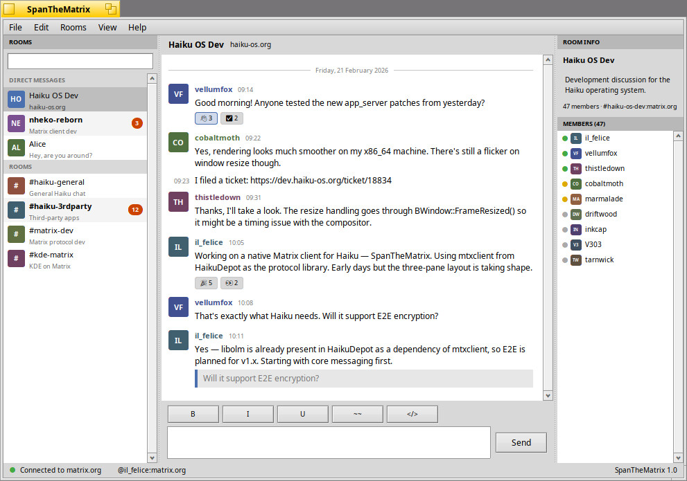

Some time ago I thought about making a native Matrix client for Haiku, but I never got around to do it beyond a UI mockup. Sharing that mockup in case it serves as inspiration for the UI.
(Ignore what’s shown in the message box; it’s all fake) :sweat_smile:
Edit: changed the screenshot to use fictional user names.

Can someone explain why my post with a UI mockup very relevant to the topic was flagged???
I can 'splain.
It’s because the mockup uses real people’s names with generated text attributed to them.
Sorry no one had contacted you yet; I don’t think anyone thought you were being malicious.
Did you not read the disclaimer???
Well, not personally; I didn’t notice that the image used real usernames either because I don’t use Matrix and I generally trust your intentions so I was just skimming. But I’m not the one who flagged it either. :slight_smile:
I think they were correct to, though. Using real usernames in a mockup is a bad idea, and using them in a mockup conversation is a really bad idea even if you think the fake statements are totally innocuous. And a disclaimer really doesn’t make it any better.
I don’t know Matrix, so I can’t speak to whether the design in that mockup is useful but it’s certainly pretty. i hope you repost it with fully-faked text.
EDIT: this sort if thing is exactly what lorem ipsum was created for; saves the effort of having to make up content and makes sure the content doesn’t accidentally upset someone.
Fair enough. Screenshot changed to show fictional user names. I would appreciate if the post is restored after this.

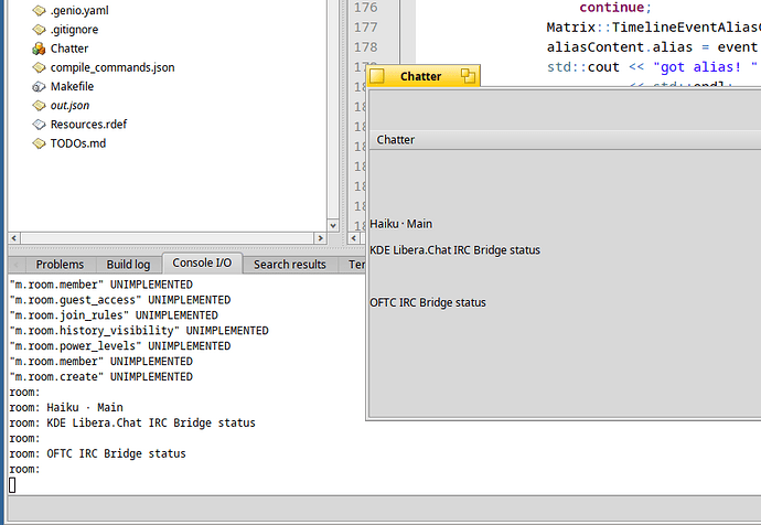

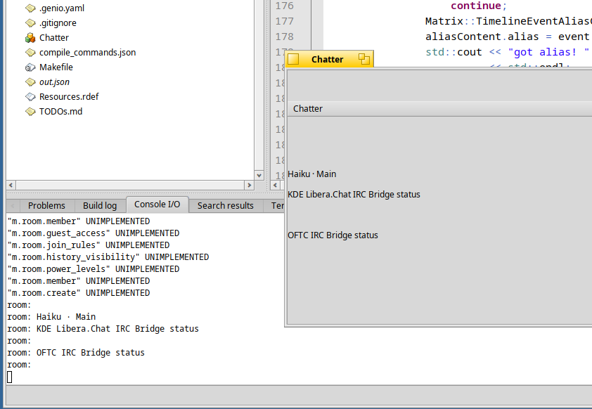

events are getting parsed!

I’ve made some solid progress, I know have the channels and their messages neatly organized in memory and ready to display, though I fear it probably will need rewriting as the UI catches up and I get a better understanding of the Matrix API.
Okayokay! I now have a list of rooms. The empty ones are DMs or small group chats, which will require more logic to get all together. The parsing code will be retold throughout generations as a terrifying campfire story.
I also have all of the messages in each respective channel together, pending UI implementation. It’s coming together!
