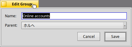

No need to apologize! :smiley: Coding should be fun. If you want specific suggestions on what to improve you should show some UI code though ;) in this case the layout would be interesting, how you arrived there
Here for example a layout that aligns both text entry boxes above each other with the “Username” and “Password” strings right aligned could be an improvement.

I don’t know if it’s the right Haiku way, but I use a grid in my apps to keep fields and their labels aligned. Something like this (just an example).
Hope this helps.
That’s actually very helpful - thank you!
