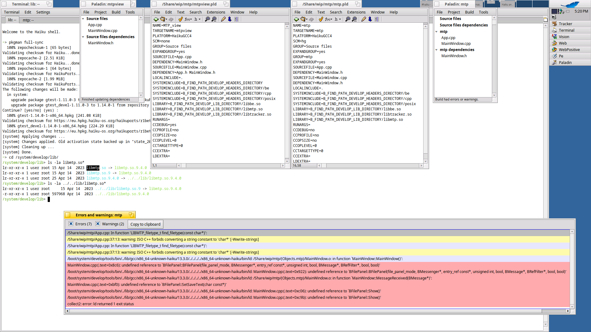

Failed with Paladin:
I see linker errors in Paladin output. Does new libmtp installed correctly? If not you can edit pld file by Pe and write a correct path.
For my test machine locations of libmtp.so is:
Same setup with last attempt here:

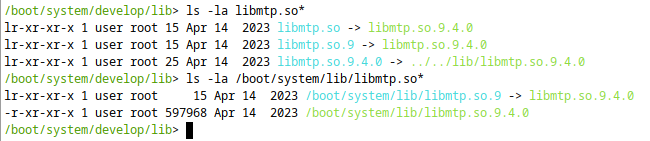

/system/develop/lib> ls -la libmtp.so*
lr-xr-xr-x 1 user root 15 Apr 14 2023 libmtp.so -> libmtp.so.9.4.0
lr-xr-xr-x 1 user root 15 Apr 14 2023 libmtp.so.9 -> libmtp.so.9.4.0
lr-xr-xr-x 1 user root 25 Apr 14 2023 libmtp.so.9.4.0 -> ../../lib/libmtp.so.9.4.0
/system/develop/lib> ls -la ../../lib/libmtp.so*
lr-xr-xr-x 1 user root 15 Apr 14 2023 ../../lib/libmtp.so.9 -> libmtp.so.9.4.0
-r-xr-xr-x 1 user root 597968 Apr 14 2023 ../../lib/libmtp.so.9.4.0

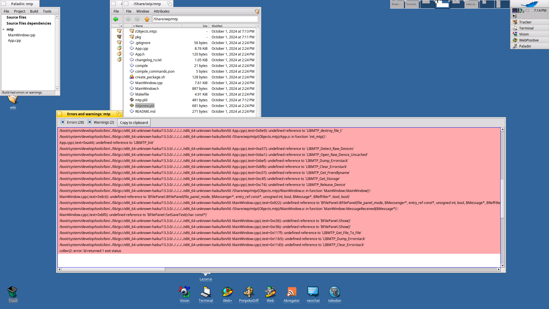

mtpview builds ok with Paladin, it’s mtp that isn’t:
I can reproduce this errors if uncheck libtracker.so from Setting->Change system libraries. But on this case libtracker.so removed from pld-file too (you have it). I don’t figure out what happen.
