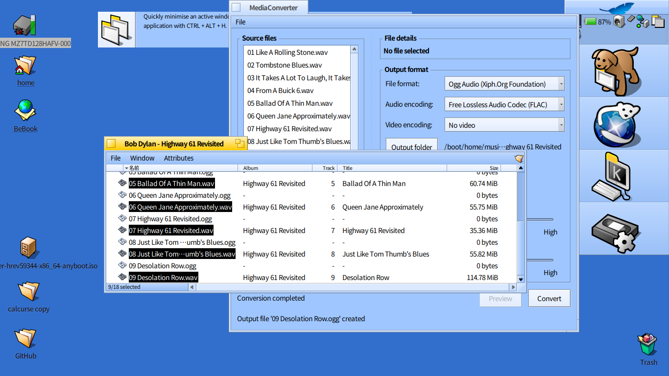

Is there a way to convert the WAV files to .ogg, or .mp3s? I tried using Media Converter to convert from WAV to .ogg but for some reason the .ogg files were all zero bytes in size…
Oh, well… MediaConverter should have worked. Running it from the console I see it spits errors, depending on encoder: unsupported codec id, no extradata present… finishing with Error writing frames.

MediaConverter is using the media kit. The media kit does not use ffmpeg correctly because it pretends that the container and the codec are two completely independant things. In theory that’s allright, you can put mpeg4 frames in an ogg container or vorbis audio in an AVI file if you want to.
But in practice, there is always some interaction between the two, and in ffmpeg, it’s really needed to have the two parts talk to each other, especially for encoding.
See Making sure you're not a bot! for details. Until that’s fixed, the Media Kit is mostly unusable for encoding. At some point I had a few combinations of containers and codecs working with our hacks, but it gets broken with new ffmpeg versions. So this should be properly fixed instead. We can probably make the Media Kit a lot simpler if we stop trying to support mix and matched containers and codecs, and enforce that the add-on handling the container also handles the codecs inside (I think that should be fine in 99% of cases at least).

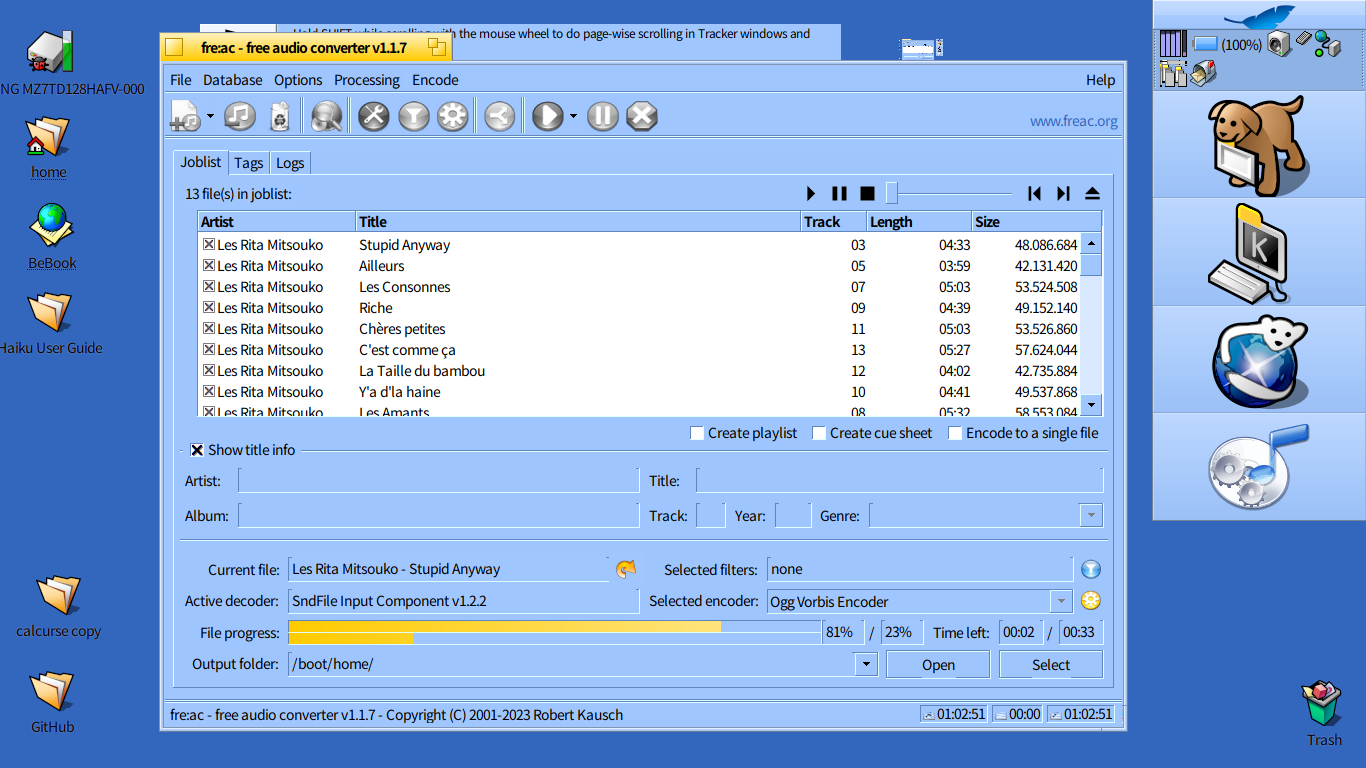

There is also fre:ac in HaikuDepot if you prefer a tool with an UI
Thanks. I installed Fre:ac from HaikuDepot and it was able to make short work of converting the WAV audio files to .ogg format files.
