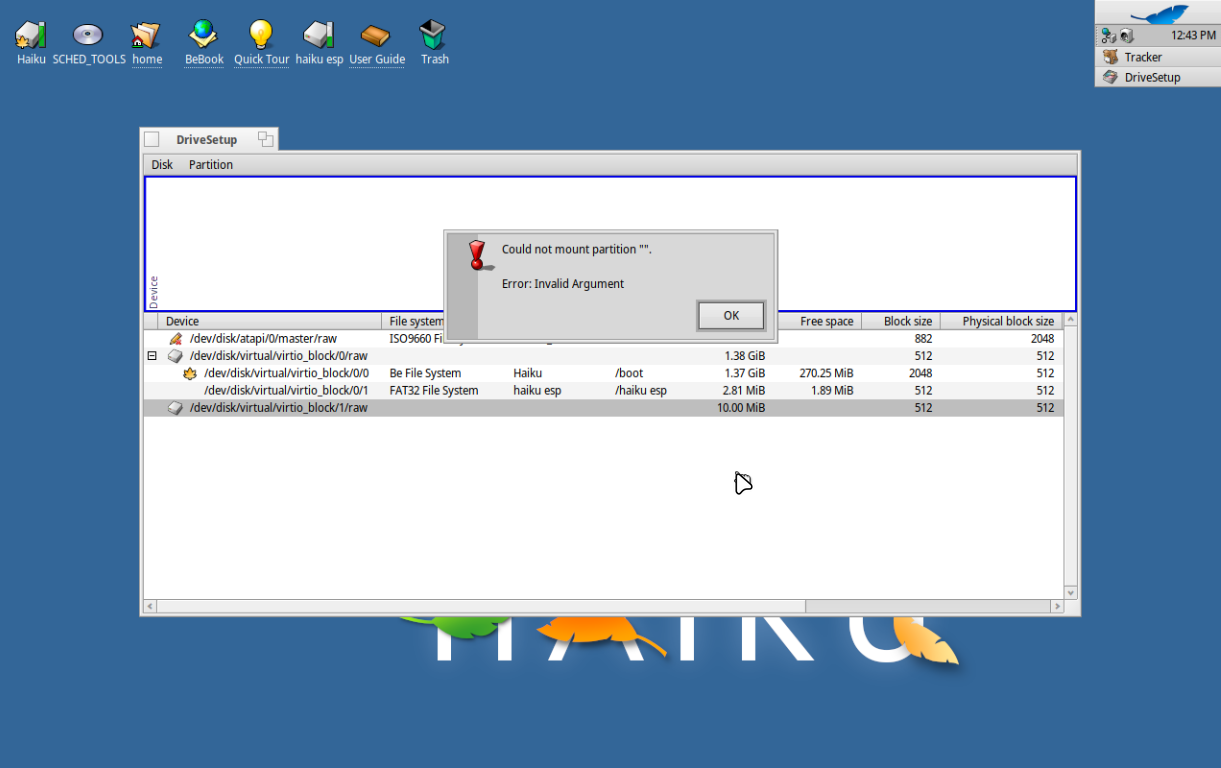

I assume this is the error that was mentioned in the GSoC page? Of the UFS2 partition not being accepted in the actual system?
Edit: Tried with Linux Native partitioning and as well as FreeBSD partitioning, as well as raw disk itself, all provide the same error when trying to mount a ufs2 file.

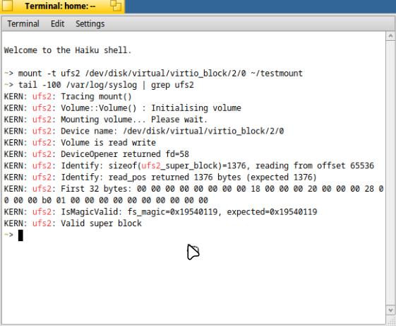

Check your syslog (in /var/log/syslog) after trying to mount the partition, it should have some details about the error.
But there are very few calls to the TRACE macro in the ufs2 code, so you may need to add more of those to better understand the issue.

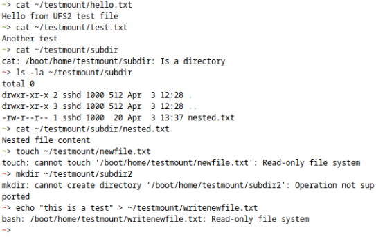

2026-04-03 21-37-46

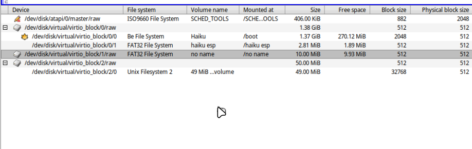

I have attached screenshots, basically mounted a ufs2 driver onto the system, loaded it in, then mounted a file written for the ufs2 format, and tried checking it.

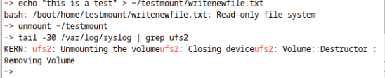

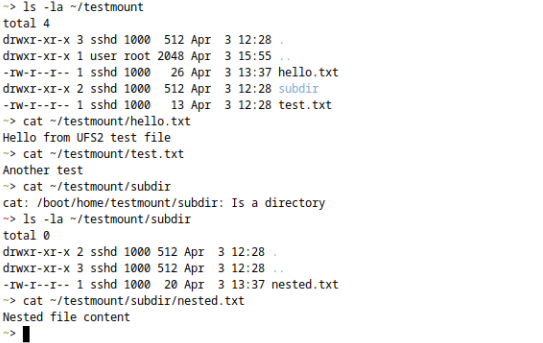

Currently, the ufs2 driver only allows to read files, and checkout nested directories as well. No support for writing or creating sub directories/files. Unmounting and mounting works too.

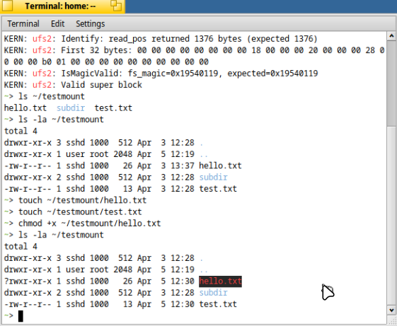

I have managed to allow give write_stat() additions, such as touch, chmod, etc to the ufs2 file implementation.
