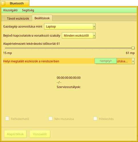

I would be happy if I would get a message as Haiku - at least - found my BT device !..
   user  ~    03:58    listusb|grep tooth
413c:8143 /dev/bus/usb/2/0/4 "Dell Computer Corp." "Broadcom BCM20702A0 Bluetooth" ver. 0112
   user  ~    03:59    listusb -v /dev/bus/usb/2/0/4
[Device /dev/bus/usb/2/0/4]
    Class .................. 0xff Vendor Specific Class ()
    Subclass ............... 0x01 (Unknown) (255:1:0)
    Protocol ............... 0x01 (Unknown) (255:1:1)
    Max Endpoint 0 Packet .. 64
    USB Version ............ 2.0
    Vendor ID .............. 0x413c (Dell Computer Corp.)
    Product ID ............. 0x8143 (Broadcom BCM20702A0 Bluetooth)
    Product Version ........ 0x0112
    Manufacturer String .... "Broadcom Corp"
    Product String ......... "BCM20702A0"
    Serial Number .......... "3052CBEA81BC"

   user  ~    03:59    uname -a
Haiku HiQ_R1Nitely_512GO.szabadpart.n R1~beta5+development hrev59485 Mar 16 2026 06:02:24 x86_64 x86_64 Haiku
   user  ~    04:07    ps bluetooth_server
Team                                                  Id #Threads  Gid  Uid
/boot/system/servers/bluetooth_server                719        2    0    0
Thread                                   Id    State Prio    UTime    KTime
bluetooth_server                        719     wait   10       29       45
BT Kernel-User Event thread             722     wait   20        0        0
Some hours ago I updated my Haiku 64bit R1Nightly, just as I seen so many BT patches on gitore so I became curious : how much visible of it , for us, end users … not much actually :))
Nevermind. I will follow them on gitore and on the forum too !

Well, my Broadcom device is built-in, not a dongle, however Dell always uses USB bus to insert BT devices, and they are basically Broadcom products (chips).
Only one exception - If I could replace the all Dell (Broadcom) Wireless MiniPCIe with a combined Intel WLAN+BT device, like
Intel Dual Band Wirelles-AC 7260 HMW (it includes an Intel BT 4.0 version device)
In case older MiniPCI I can replace DELL (Broadcom) BT device only with a separate dongle - in a USB 2.0 port …
As I recognized, Dell provided 2 kind of radio devices (WLAN and BT) earlier
Broadcom ones under its Dell brand
and
Intel ones …
at least in the all 4 Dell (one really old Inspiron and 3 Precision Workstation grade) laptops.
