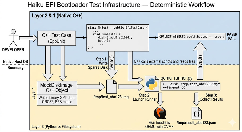

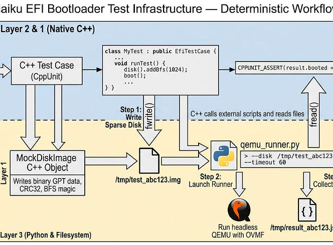

Sure, why not. That’s the whole idea behind writing mocks, to be able to test it in a controlled local environment. Have a look:
mocking would allow us to control the UEFI hardware input to the Firmware.
We still need QEMU environment to run the firmware? isnt it ?
I am able to reach here.
Here is my Proposal
the final workflow I am able to reach,

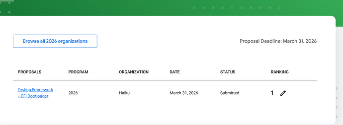

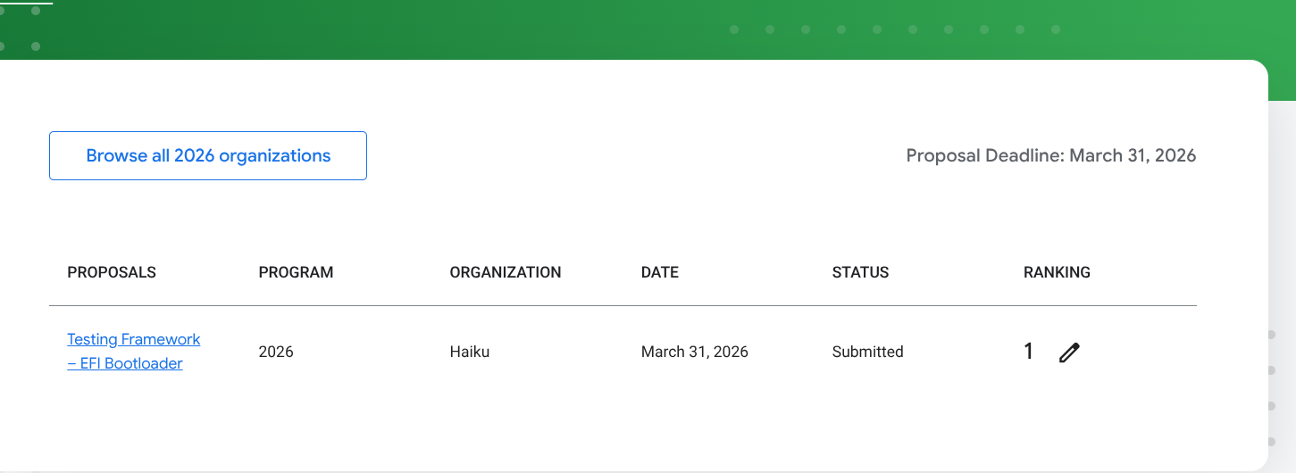

the submisison has closed ….
Got it, thank god, it was glitch and took my soul instantly.
I have submit the proposal
