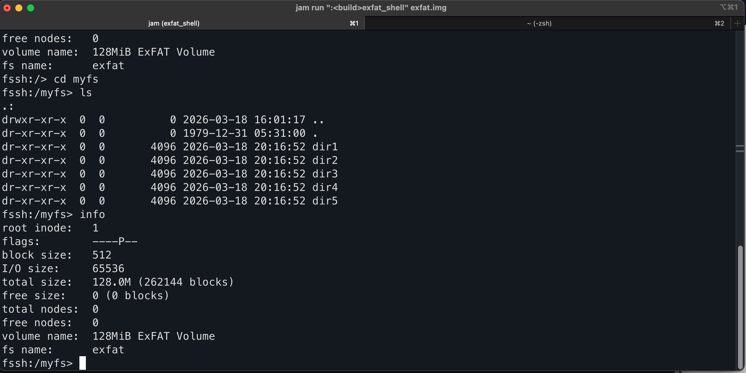

Hello @Halonix
The way fs_shell is written it emulates kernel behaviour through its own headers defined in headers/private/fs_shell/{shell_headers}.
Idea is to use those headers for all fs related hooks functionality that you would normally need from kernel during actual boot/mount.
We can identify all those headers and then separate it out in system_dependencies.h file so that there are no conflict in either version.
I looked at exfat code to check and I see there are particularly two utilities method which is not available in current fs_shell headers.
  1. notify_io_request: we can check how bfs handles this call for fs_shell and can simply add guards there.
  2. convertutf.h: This header is not present in fs_shell headers so we can either make already present header compatible with fs_shell as well (This could possibly not be recommended since we may break something in actual system) or we can create one for shell itself.
    I tried to create one for shell and it worked.
Ofcourse we need to include header paths in Jamfile for shell and remove kernel header instances from code and only reference system_dependencies.h
Please check my branch: Comparing haiku:master...sleipbyte:change-10476 · haiku/haiku · GitHub which contain above fixes so that you can be unblocked so feel free to use this.
Note that I made changes very quickly so you may need to discuss with developers if my approach is correct or not :wink:
