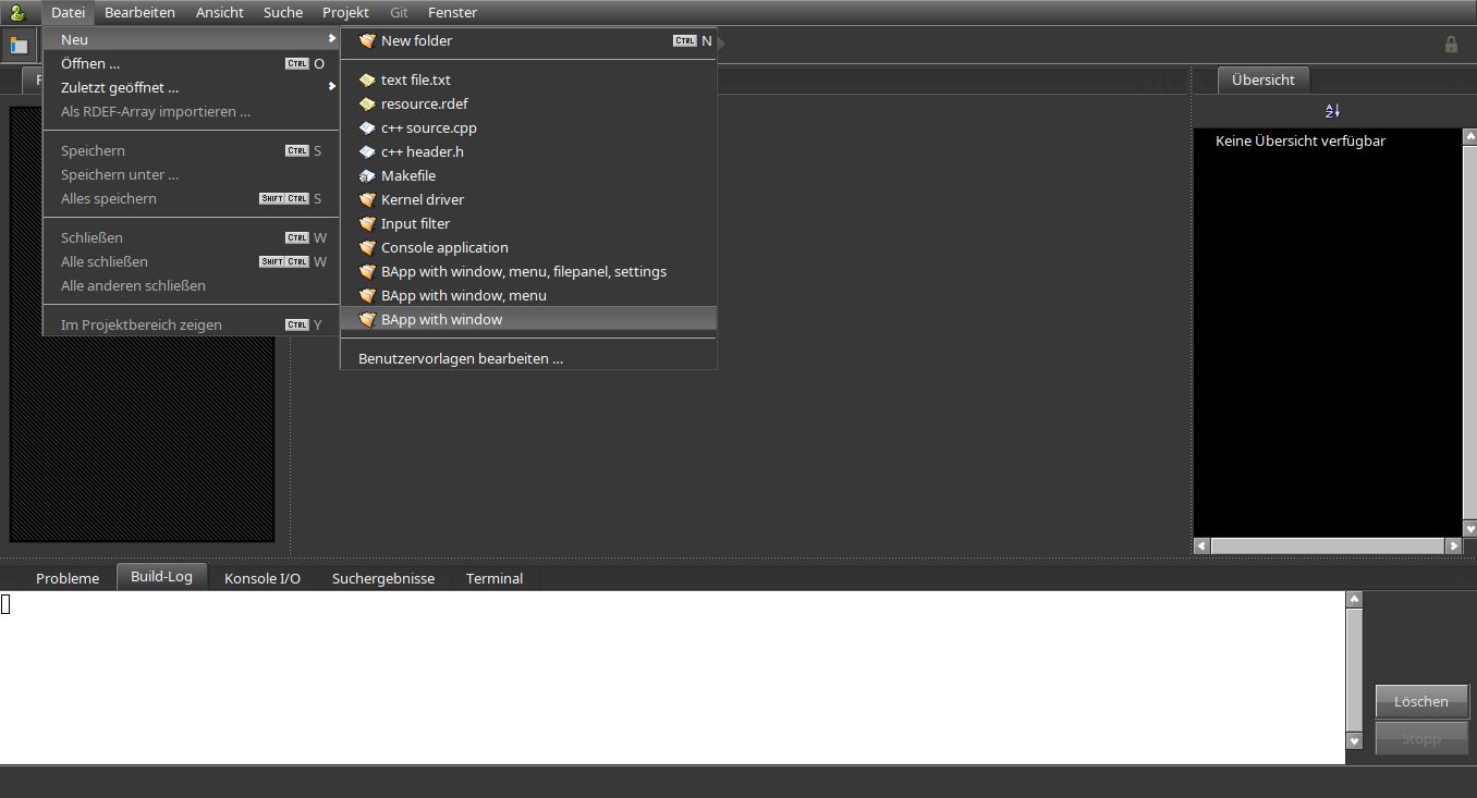

I’m a new project. For this I take the template with window and menu.

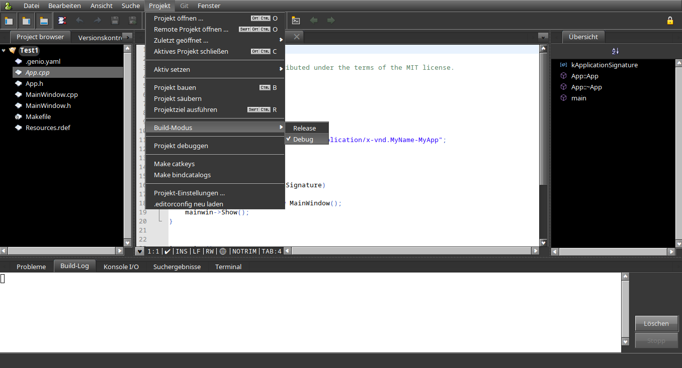

Then set the project to debug.
Clean once and recreate. Then click on the normal play button and app opens.

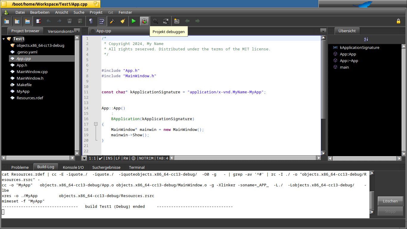

And the play button with the debug symbol?
He doesn’t care. Can someone explain to me what I’m doing wrong?

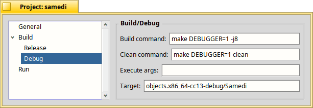

You need to tweak the “Project settings”, see the Genio documentation.
Just like you may have to adjust the defaults under “Build / Release”, you need to tell the build system how to do a debug build.
For example, if the Makefile generates a debug build with “DEBUGGER=TRUE”, you put into the “Build command” line:
  • make -j8 DEBUGGER=TRUE (-j8 just being the number of build threads, ofc)
The “Clean command” would then be:
  • make DEBUGGER=1 clean
The “Target”, if the Makefile puts resulting executable into objects.x86_64-cc13-debug, would say:
  • objects.x86_64-cc13-debug/{TheAppName}

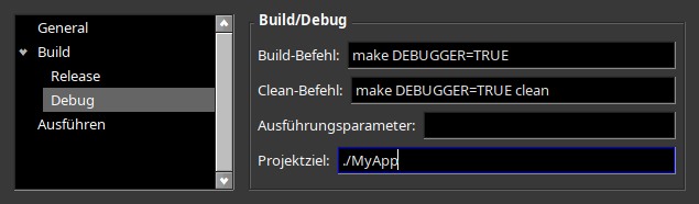

Here a screenshot of the project settings of “Samedi” as example:
Now, after building in debug mode, a click on the bug-play icon opens Debugger with the built app.
No Debugger opens.

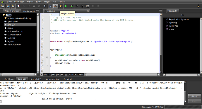

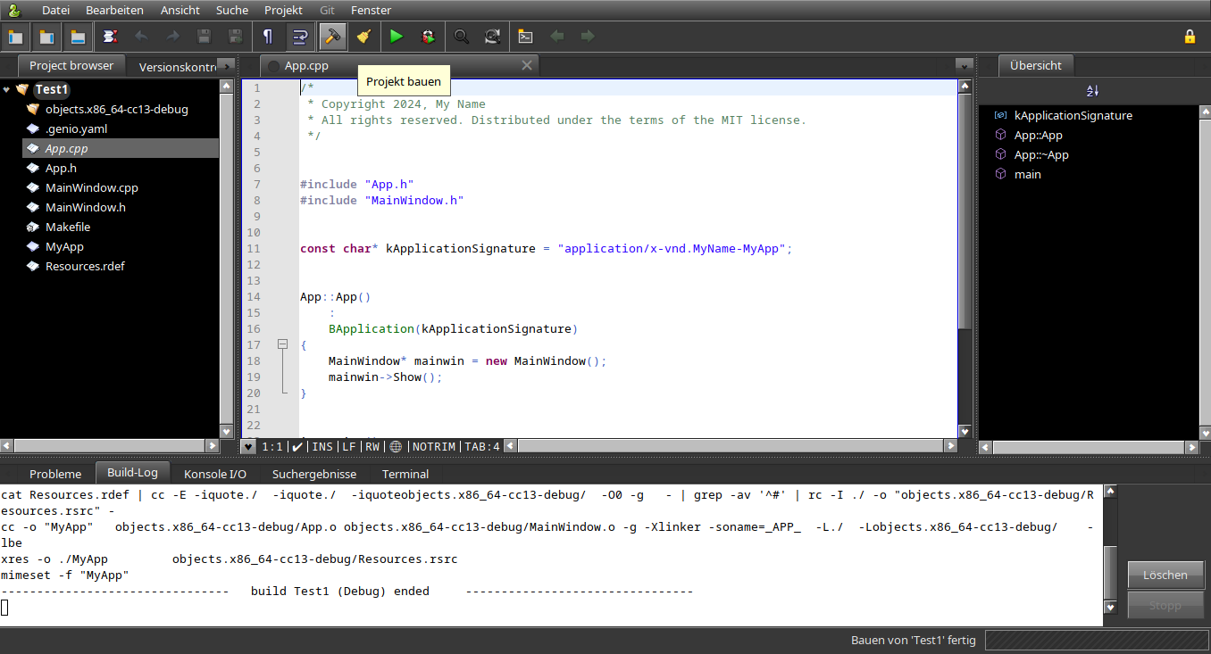

Steps 1
Step 2
Step 3
Step 4
This Button do nothing.
Thats the Settings…

In Terminal, i go to the folder and type “Debugger MyAPP” the Debugger starts but nothing in Genio.
i have change the Path from “./MyApp” to “MyApp” nothing change…

Is there any enlightening output when you launch Genio from Terminal and then build and “Debug project”?
The Button do nothing…
That is the output from Terminal
/boot/system/apps> Genio
