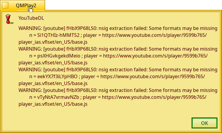

if you have issues downloading videos… always double check by trying to call yt-dlp directly from the command line, ie: yt-dlp -F <video url> (to see the which formats are available) and, just for example, yt-dlp -f 160+249 <video url> (to download one of the smallest versions).
Those “nsig extraction failed” type of errors are pretty common when Google/Youtube changes something, and yt-dlp hasn’t yet caught up (or you are still running an outdated version).
Solutions: update yt-dlp via pkgman update yt-dlp, help HaikuPorts by either reporting that a new yt-dlp version is available (assuming that’s the case), and/or, open a PR for such update. Somtimes you just need to wait for the yt-dlp project to come up with an updated version first.

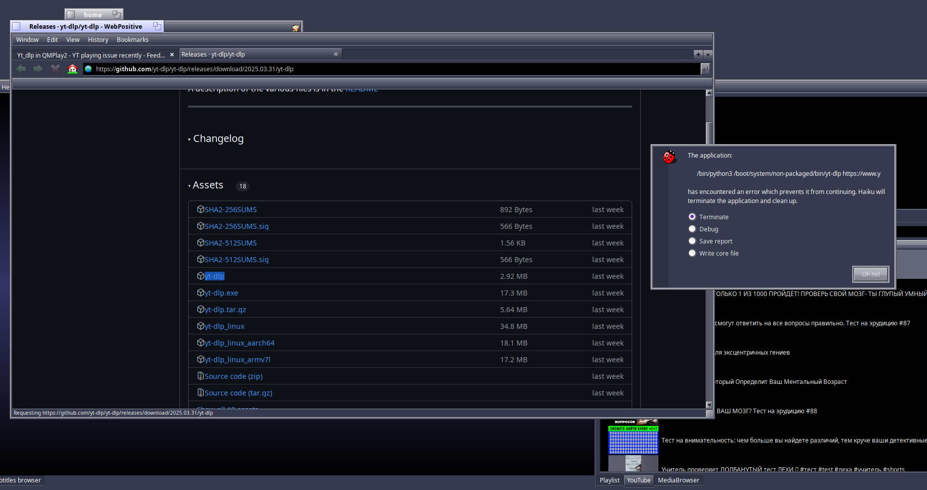

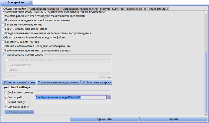

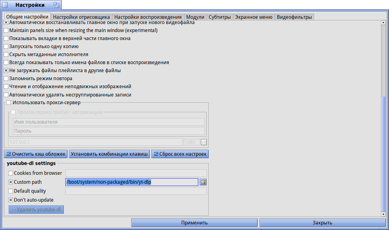

download to /boot/system/non-packaged/bin/yt-dlp
If using the standalone version works… good workaround!
Let’s hope that the issue of python+pip on latest nightly can be resolved soon enough.
using this binary: https://github.com/yt-dlp/yt-dlp/releases/download/2025.03.31/yt-dlp
still does not work
