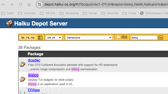

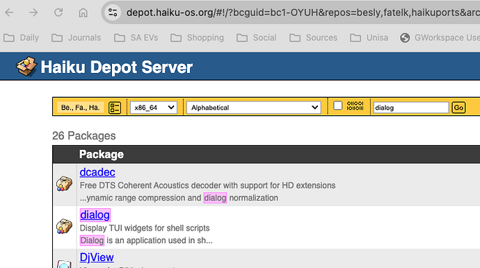

I’ve successfully built a C++ app using FLTK on Haiku. Tcl/Tk apps also work fine. In the terminal, you can use ncurses with confidence, but the dialog utility isn’t in the repos for some reason(?!) Haven’t tried much else, but Perl and Python are preinstalled, though Tkinter is infamously still broken. Javascript is also an option, and so are niche languages like Nim or Vala.
Could you give a bit more information on this? afaik there is no issue tracked in this regard on haikuports. :slight_smile:
Dunno, it’s just, dialog doesn’t seem to be preinstalled, and pkgman search dialog doesn’t help either. Maybe I’m missing something obvious, and it’s just a nitpick. Only mentioned it because this came up.
Builds straight out of the box, shouldn’t be fairly simple to add it to the depot if there is a need for it :slight_smile:

EDIT: should check first, it’s already in the tree dev-util/dialog-1.3_20170509.recipe :smiley:
That’s weird. I know that I’ve installed and used it. Were you thinking of xdialog?
We don’t have whiptail, though
No, I mean plain old dialog. That’s weird, I’ll try again. Thank you.
Remember you can use the cmd: form of search (e.g: pkgman search cmd:dialog) for when you want a specific command.
Posted a PR at haikuports for this, bringing it up to the latest release, maybe you could check it out (before I merge)? :slight_smile:
I could find it and install it this time, go figure. Not sure what I was doing wrong before. It works, too. just seems to misidentify the terminal size(?) Going to do more testing later, can’t right now. Thanks a lot!
