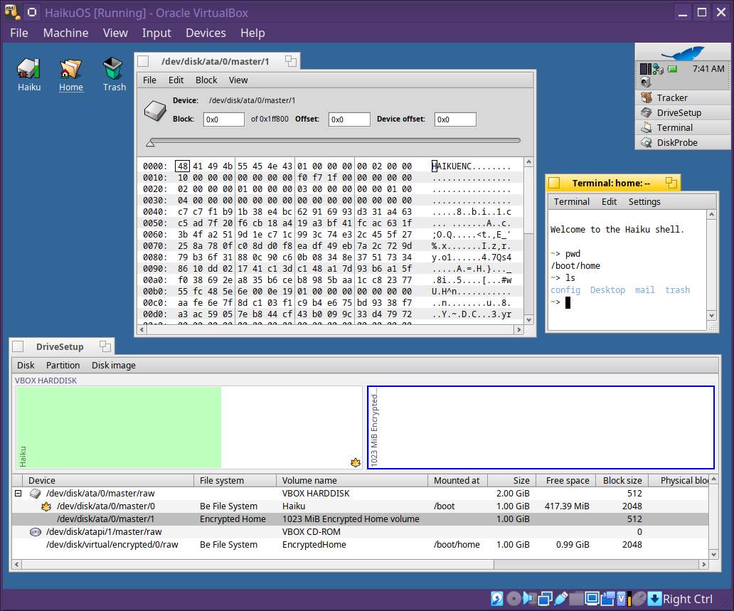

I have been working on an Encrypted Home system for Haiku. The goal is simple: let users install Haiku with /boot/home stored on a separate encrypted partition, unlocked during boot before the desktop session starts.
This is not full disk encryption yet. It protects the user’s home volume while keeping the system volume bootable in the normal Haiku way.

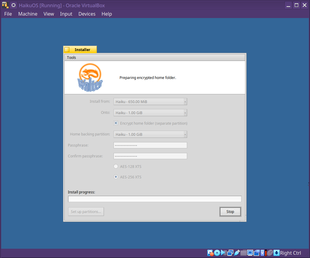

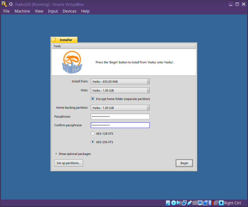

The installer now has an Encrypt home folder option. When enabled, it asks for a separate unmounted home backing partition, a passphrase and AES-XTS mode. The selected backing partition is formatted as an encrypted volume, mounted at the target system’s /home, and the installed system is configured to unlock it on boot.

  2. Home backing partition selection

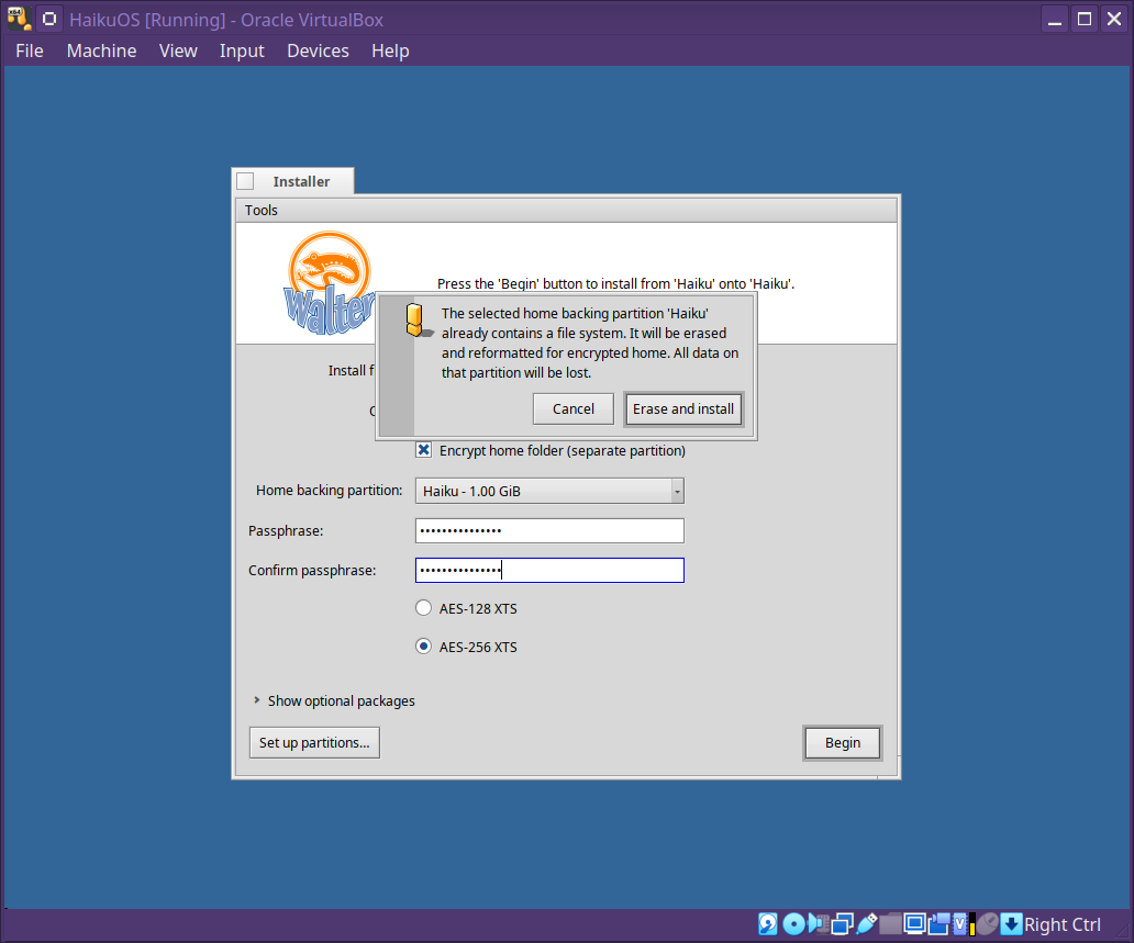

  3. Erase warning for an existing backing partition

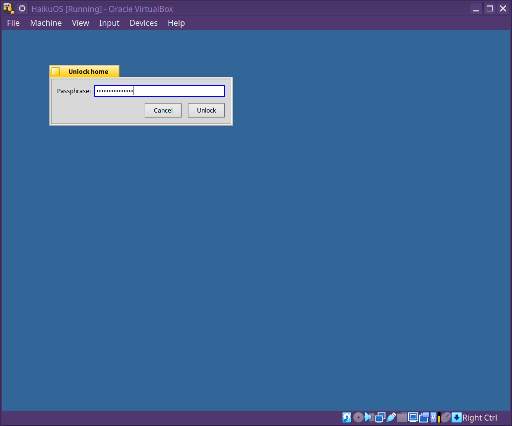

  5. Boot unlock flow

The implementation includes:
  • Encrypted-home volume header format with redundant primary and backup headers
  • Argon2id passphrase-based key derivation
  • AES-128-XTS and AES-256-XTS payload encryption
  • Kernel virtual disk driver for the unlocked encrypted block device
  • Disk-system and filesystem detection support
  • Installer provisioning flow
  • Boot-time unlock application
  • Launch ordering changes so the desktop waits for home unlock
  • Unit, integration, image preflight, and static-analysis gates

I haven’t looked at your solution at all yet, but I wonder why the distinction between AES-128-XTS and AES-256-XTS is that important to bother the user with it. I would just make the latter the default. It would also make sense to be able to reuse an existing volume for this.

Hi Axel,
I added AES-128-XTS as a lower-level format/test option, users shouldn’t need to choose it during install I just haven’t removed it from the installer screen yet. I’ll make AES-256-XTS the default so it’s not confusing for users.
Do you mean we should reuse an existing BFS home volume while preserving its contents?
We don’t currently do that in this initial version. The installer can select an existing BFS partition as the backing partition, but it will reformat it into a new encrypted-home container and creates a new BFS filesystem inside that container.
