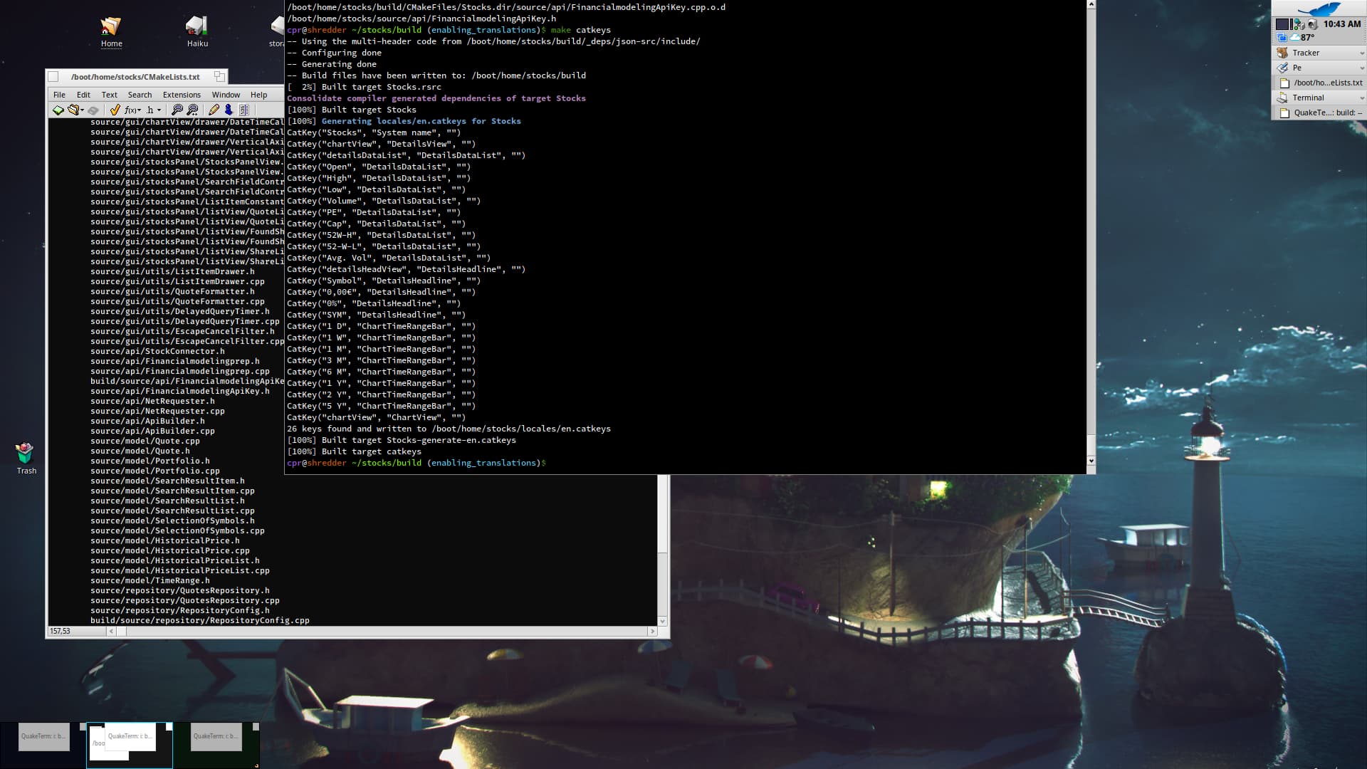

There is something odd with the file paths for the two generated cpp files. When I change their paths and prefix them with the build directory then make catkeys is successful. Hopefully I’ll be able to look at this more closely soon.

What have you done? Just a ‘make catkeys’ after let cmake generate the makefile?
Hm, it’s so easy , I did not see this.
Now I can run cmake - it builds the API keys into the source files, then in ./build folder, the $: make catkeys command runs.
It seems also that $: make bindcatalog runs, but then the app crashes when it runs.

I can make it work by adding a build/ prefix to the two generated cpp files. There is an issue with my cmake module that I’ll need to fix in order to avoid having to do that. I’ll leave some notes on the pull request.
In my case, I run cmake and then switched to the build-directory. The files there are the prepaired files (with infected API keys)
In this dir I am able to run $: make catkeys.
