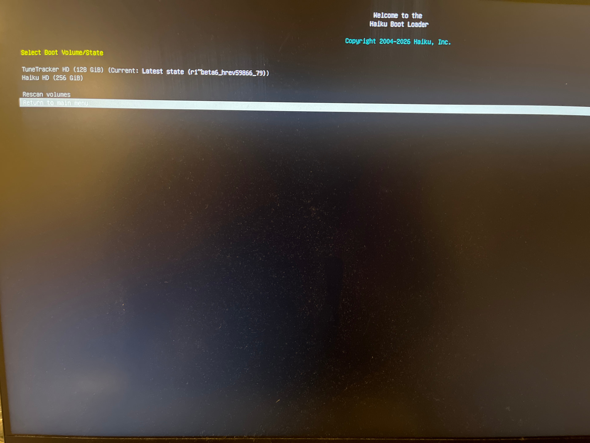

The boot loader (the thing where you can enter safe mode options) is fine too. I do seem to have this problem where if I have multiple Haiku installations (32 and 64 bit) the boot loader (safe mode options etc.) will come up. I don’t want it to.

How do I make it so I don’t have to select one every time?
I am only guessing here, but that usually occurs when your partiton is of a wrong type
They both work. It behaves as if I pressed Shift or Space on booting, and brings up the boot options. Continue booting is greyed out until I go into the disk selection and select one.
I have a 32 and 64 bit install. I only want the 64 bit to boot this way, is there a way to skip this or set the default? The installs are on separate drives.

It does seem similar, but it only happens when I have the other install. I remove the 32 bit install and partition (accidentally) and Haiku 64-bit booted from rEFInd without coming up with that selection menu.
let’s say my setup was simpler. If I had 2 drives, each Haiku only, and tried to boot from 1 drive, would it stop booting to bring me to the bootloader, and make me select a boot disk before I can continue booting? If so, how to I get around that.
This has nothing to do with it “working” after you explicitly selected a partition, if the partition is formatted a BFS The boot loader will consider it for the menu, but it will only consider it for booting when it also has the correct GPT partiton identifier
I don’t know. It automatically detects the Haiku installation on the GPT disk and on the MBR formatted disk. Both installs were according to regular instructions with regards to partitioning and formatting.
it detects the MBR install, and makes me pick one every time while it’s there. It would be nice if I didn’t have to do that, I didn’t see anything in the kernel file or user boot script that would help.
Currently there’s no way to force the bootloader to pick automatically one of the installations. I’m going to add the support for that, but I’m pretty busy atm and will be able to look into it next month the earliest.
